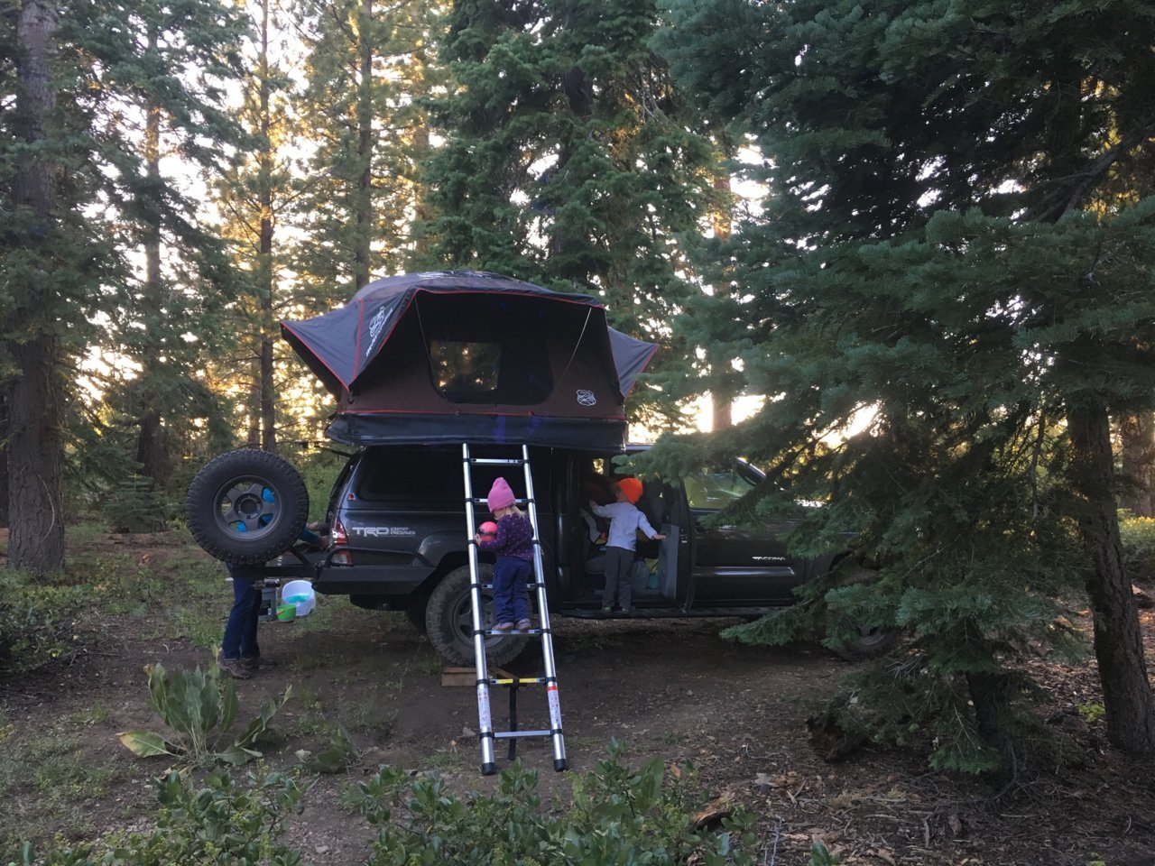

    What's the tent weigh and do you have a rack on your shell?
    I'm running a 120lb RTT on my leer 100xr shell. I want to build an internal cage for the shell before I really get after it offroad but it has been okay for the couple trips we've taken with it.

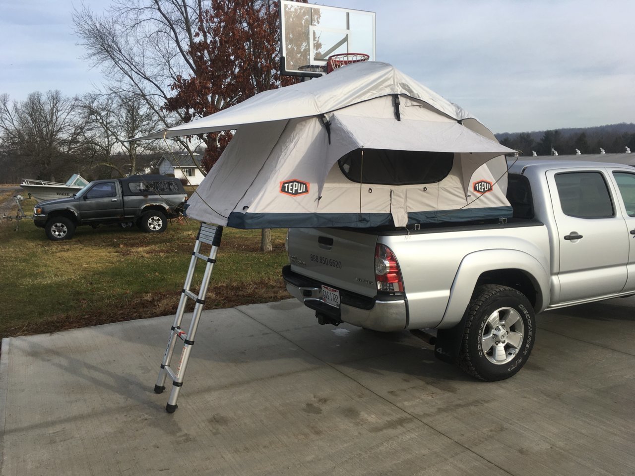

    Did you end up getting it? That's the exact tent I'm looking at and there aren't many reviews out there.
  6. Feb 23, 2020 at 4:48 AM
    10toy
    10toy [OP] Active Member
    Sep 24, 2009
    #23272
    44
    OH
    2010 Tacoma 4x4
    We did get it and love it. I have no personal experience with any other RTT but it seems really well constructed. I can get it on and off the bed rack by myself. I am just going to remove the cap when we camp. The main reason I decided not to use it on the cap had to do with the forces on the cap in an accident or really hard stop situation. The inertia multiplies and would probably tear the cap apart. Just how decided to go forward. Lots of camping planned this year and I will report back...it worked great for camping out Christmas Eve!

    I still need to change the rails so it opens off the side...

    That looks great. I'm actually wanting mine to open to the back.

    Is that tent light grey or white?

    I would say off-white...
