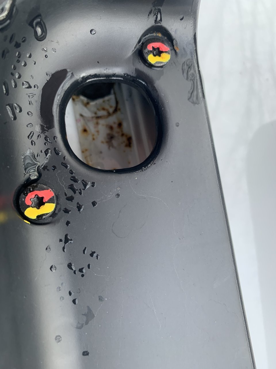

    OP said: "rust about an inch from the mangled holes they “drilled” to mount these side rails." So I thought all along that this was a hole vs the bracket.

    Much ado about a very small minute concern. Not real sure there is a problem.
    If it were mine. I'd reach in the hole with a q-tip soaked with rust converter. Then install the rack with beads of silicone around the mount points.
    And call it done.
    BTW, never stick your finger in a hole. You never know how it can hurt you.
