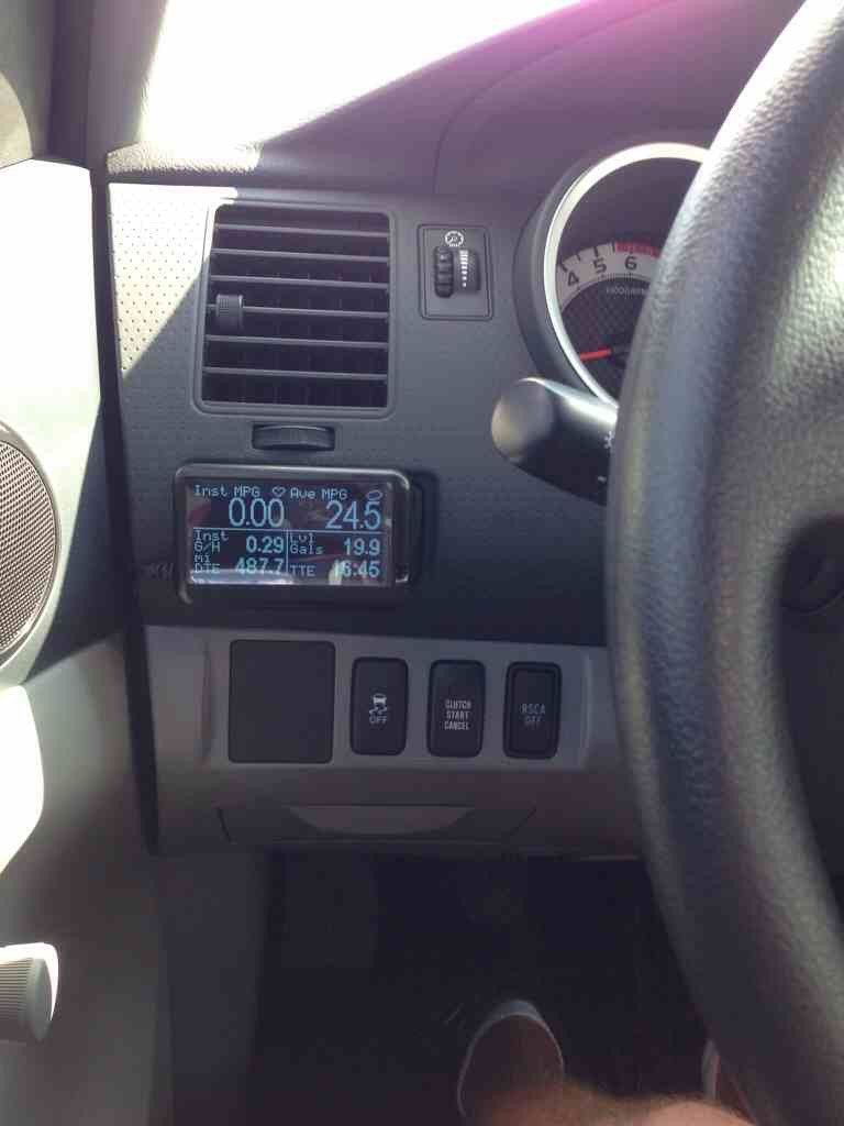

    I have a 2013 2.7 4x4. I get around 15-16 in the city (short, stop and go commute) and 26-27 even 28 mpg on a 500 mile round trip to where I'm from ( mostly 55- 72 mph). Mine has 1900 miles. My first half tank I got 14 mpg.

    That does help. I'm always watching mine. I got mine on the group buy here.
