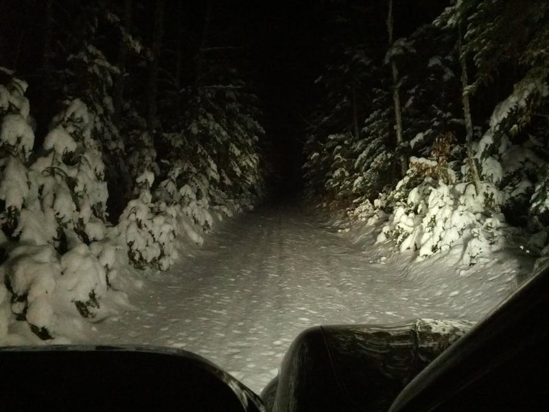

    Okay,
    So I was driving through some deep snow in 4WD with the rear locked, and when ever I accelerated I had this insane whole truck hopping sensation until I let of the gas. Any ideas what it could be? I'm baffled... In the end I had to go down the road at like 3 miles per hour so it wouldn't start hopping. Kinda new to the 4WD scene so be easy on me :crapstorm:
    Also this has never happened before while doing the same thing, it just started doing it...
