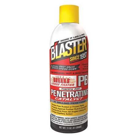

    Also, I used this penetrating oil when mine started squeaking a few months ago... it was fine until I tailored a boat several times in a week. I figured the lake water washed out the lubrication.
