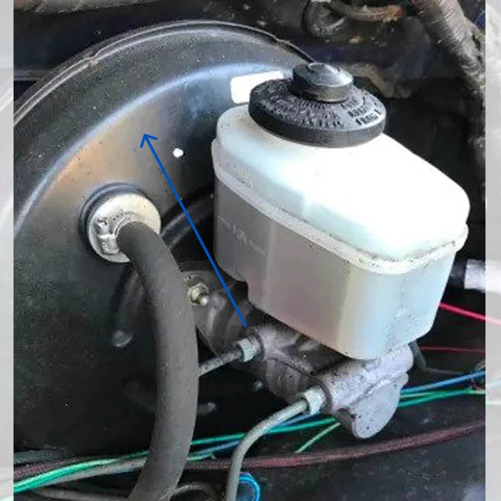

    Sounds like a failing/leaking brake booster.

    Check that the hose is on the booster is tight. The booter is big black thing pictured.
    Try this too. Just because you can.

    Thanks boss. I tried out those tests, and for the most part it seems normal. I did notice just now that the pedal does make the noise with the engine on too (I need to press down really hard), which makes me think that it’s a mechanical issue
