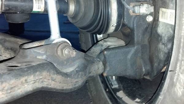

    im not getting a rubbing when turning, instead when i turn i cant turn enough(something stopping it from turning anymore), seems to me that i could turn more if there wasnt something stopping it.
    les schwab said that they did not adjust or change anything on the turning of the truck.

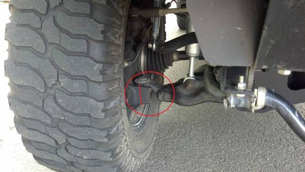

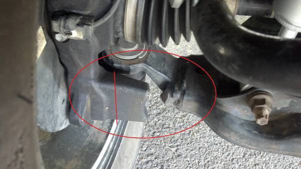

    i uploaded 2 pictures the part that i circled seems to me like it needs to be trimmed down... didn't want to cut something off that couldnt be reattached later
    [The red line shows where my original part was size wise. The piece thats circled(dont know the name for it) is about 1.5" inches longer than what the stock one came with from the Toyota factory.]
    [When i took the pictures the truck was parked straight with the wheels parked straight]
    let me know if you want me to upload anymore pictures of the lift to better solve my problem.

    I think you might need to trim that and get new tie rod ends

    ^^Wow! I have the Pro Comp version 6" and the turn stops are way smaller than those. My turning radius did decrease but nothing like you are describing.

    trimming is what i thought id have to do either way

    I just checked my distance on the steering stop, looks exactly like yours. My turning radius sucks but it really isn't that bad. Could it be your driving style ? Then again my lift has been installed for 23k miles so maybe I'm just used to it.

    Its definitely your turning stops...looks like they need to be trimmed!
    I have the Procomp 6" and your supposed to weld on steering stops but I didn't want to go that route because it hurt my turning radius as well
    Also you might want to look into the inner tire rubbing the sway bar and make sure your tie rod ends are flipped
    Edit: after looking at your tie rod ends they are correct

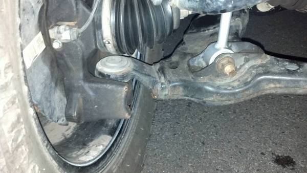

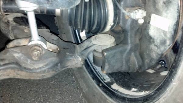

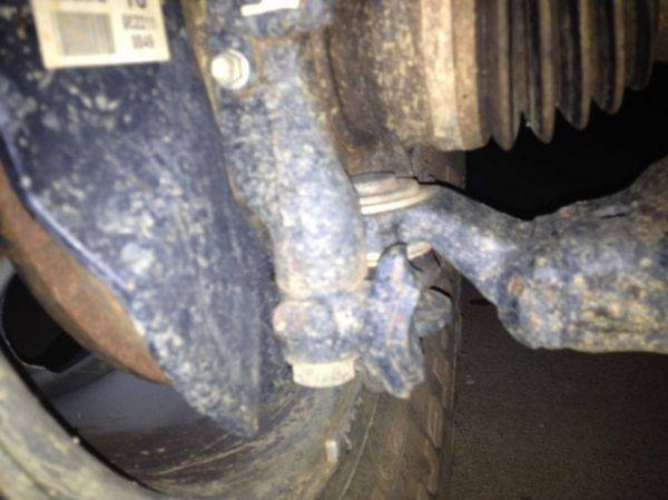

    i uploaded before and after pictures, turning the wheels to a full lock passenger then driver side.(i turned OUT the wheels all the way 1st, then turned them all the way IN 2nd)
    what you'll see is what seems to be stopping the truck from turning any more then what it could before.
    what do you guys think>? any way to fix?

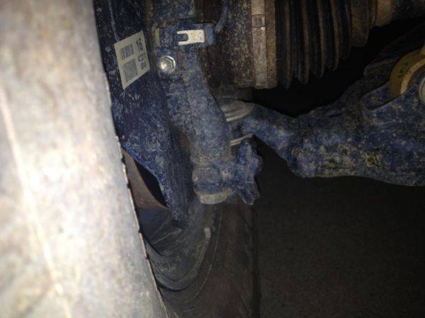

    Your stops seem way too big.....here are mine, from the Pro Comp kit.....
