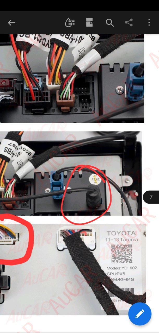

    What are these plugs? I didn't have anything that fit there and I don't see them listed in the instructions

    The bottom pic looks like that plug from the main harness that goes down towards the climate control plugs

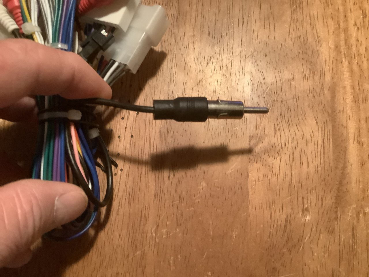

    The middle pic is the antenna plug it probably doesn’t look like that on your harness though

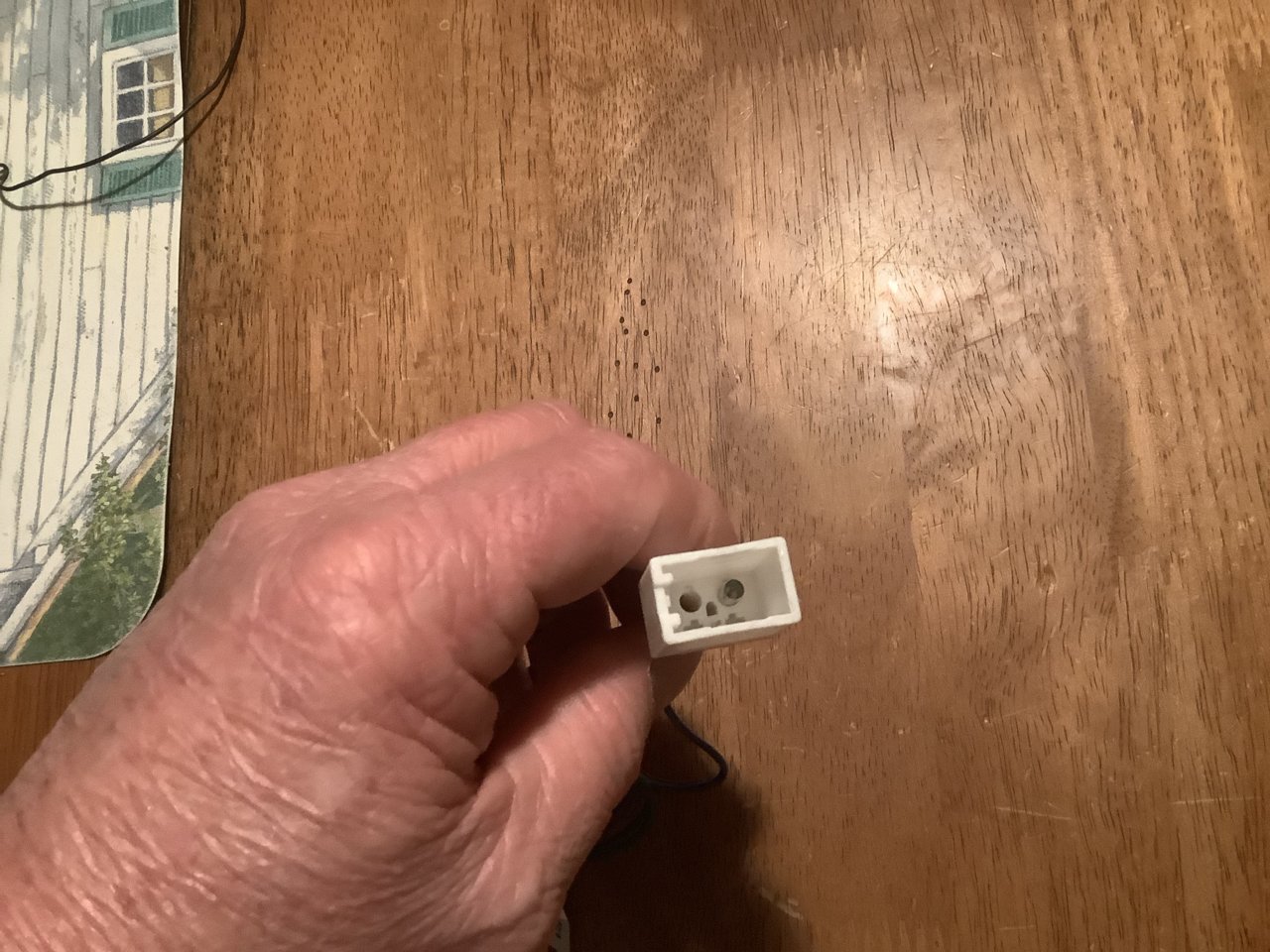

    Your antenna wire and plug should look like this9E9DC04E-C6A3-42D0-8D25-D4E50C664834.jpg

    Hmmm. Alright, I didn't have anything plugged in there, maybe that was my problem

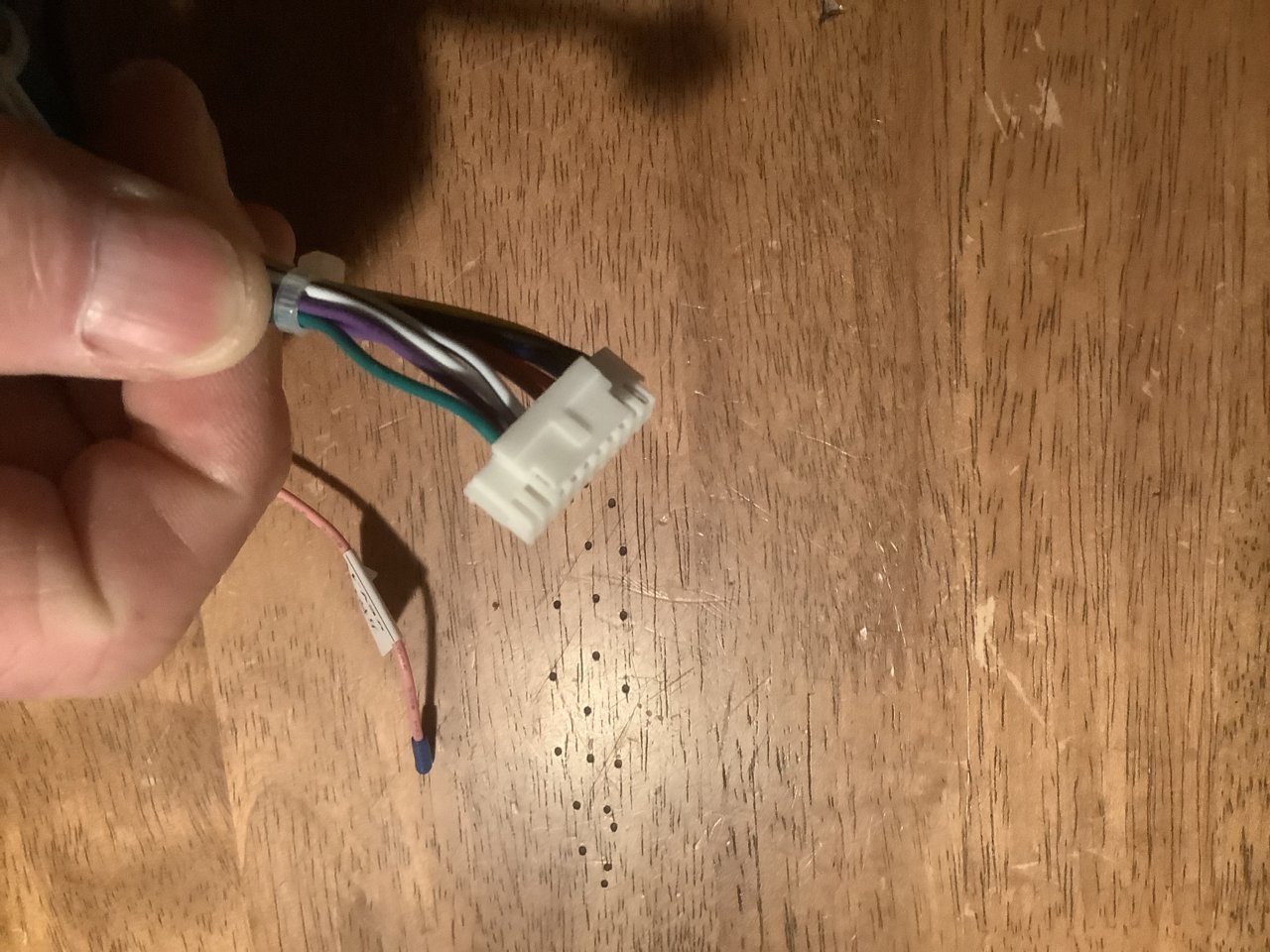

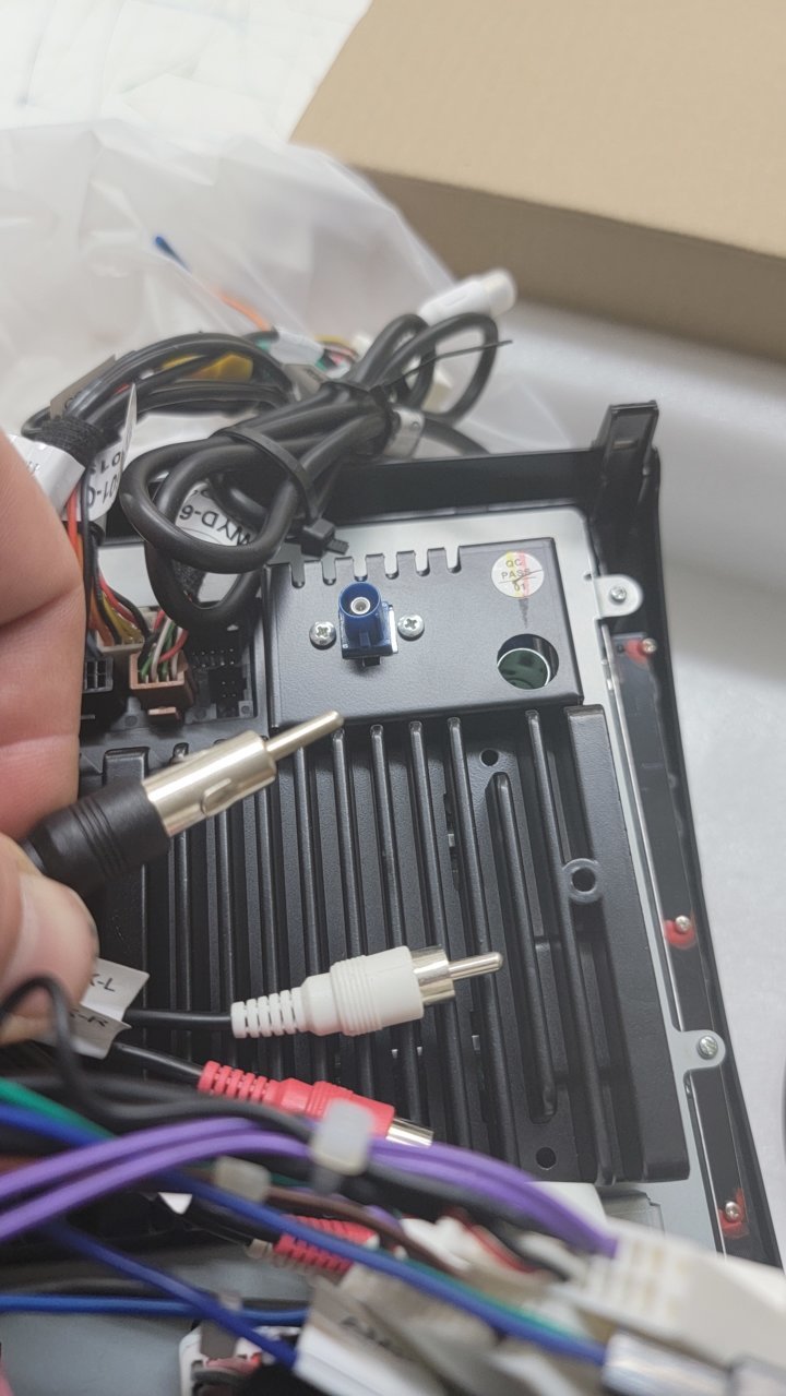

    14B9ED6E-E22B-4B2A-B230-8DFA7EC1C116.jpg EC5A182E-9FBA-4335-A8E9-447F8C708300.jpg The antenna from your truck should plug into this here

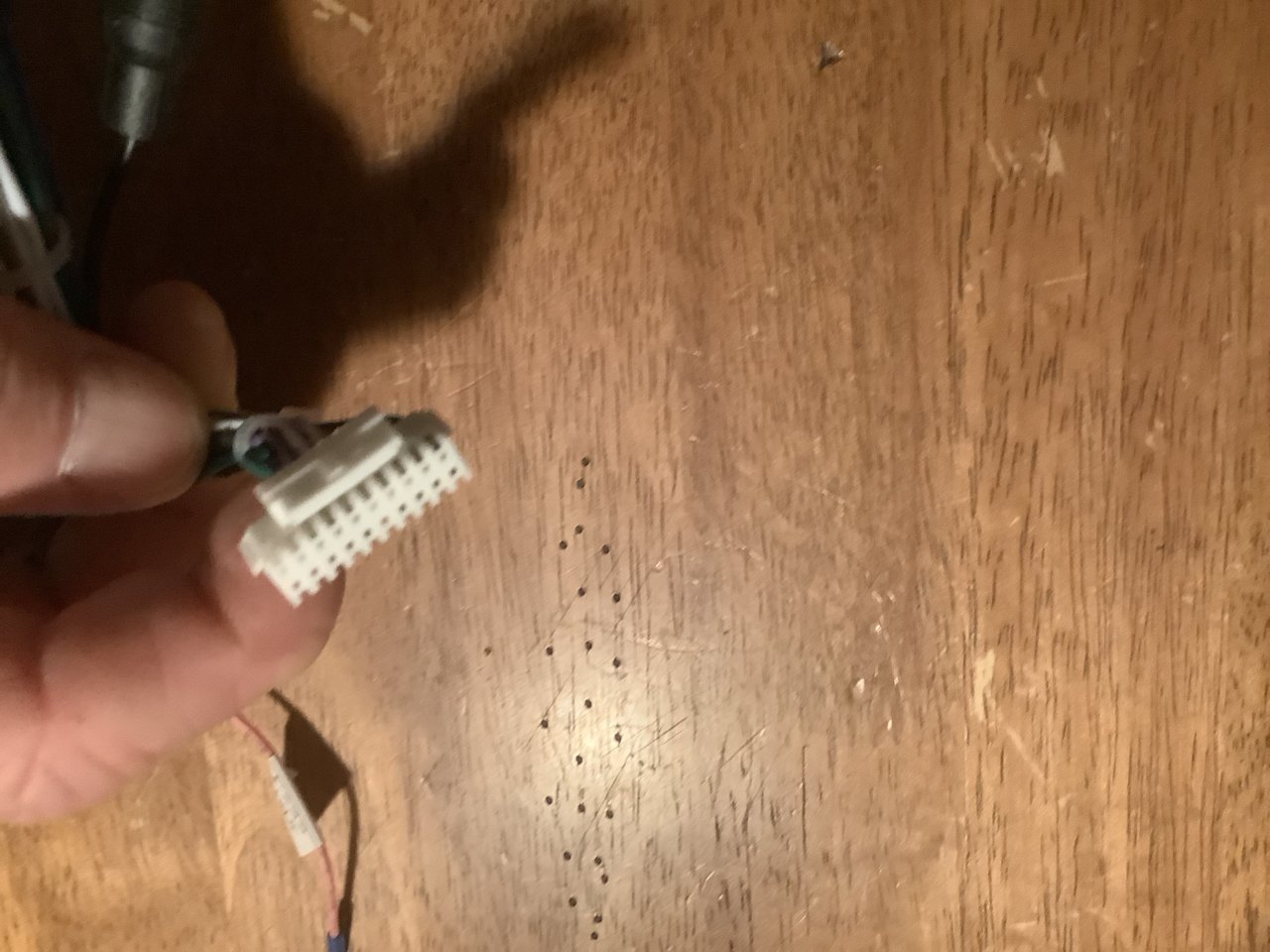

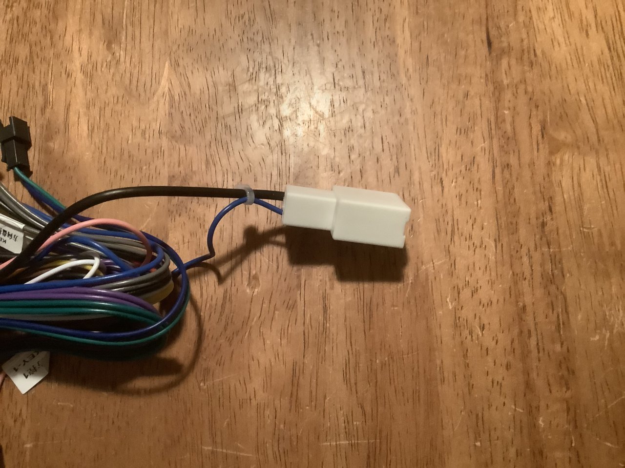

    That bottom pic you posted should have a plug from the main harness that looks like this plugged in there883F3AD8-9DA8-4D9F-808B-A816A6E11BF8.jpgE1B99D63-4444-438E-B54B-730B47E63528.jpg

    That's from the units new harness back into itself? Basically connects the top of it to the bottom of it?

    Yes thats correct

    I found that plug, it was zip tied in too tightly to reach but nothing a pair of snips couldn't fix. Will attempt reinstall

    Cool sounds good….according to the directions thats the can plug so the first time you installed it wouldn’t have had any steering wheel control or anything so you should be all set now
