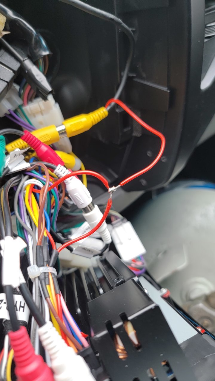

    Did you just t-tap it? Do remember which wire that was?

    A t-tap is fine I soldered mine.
    Red is accessory, black is gound. You can ground the camera anyware on the frame you do not need to run it to the radio. A lot of times the video wire(yellow RCA) has a red wire also attached that you can use for power. This lets you run one wire video and power.

    The camera I already have installed is powered and grounded, but the RCA end has the red wire that needs power, I'll try the red wire

    That worked. Mucho gracias!

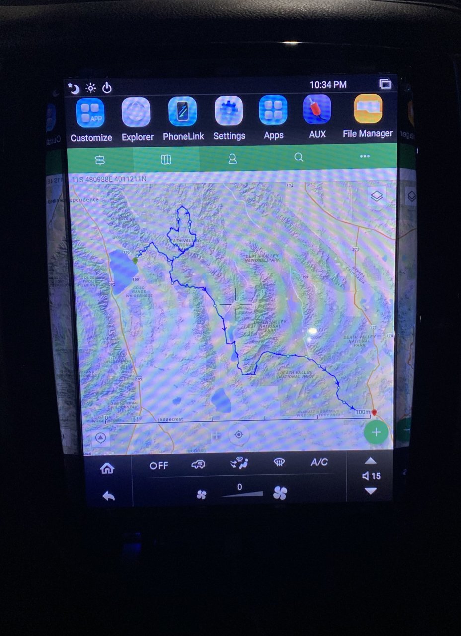

    Ordered mine on Nov 13...showed up at my house Nov 19th. The day before I was leaving on a Death valley trip. Decided to go for it and install it. Works great...never missed a beat while hammering on my truck. I use view ranger as my offroad mapping program and was real happy with the the large screen to navigate from.
    Did anyone elses come with a camera included? Camera was in the box but the website says nothing about it being included.
