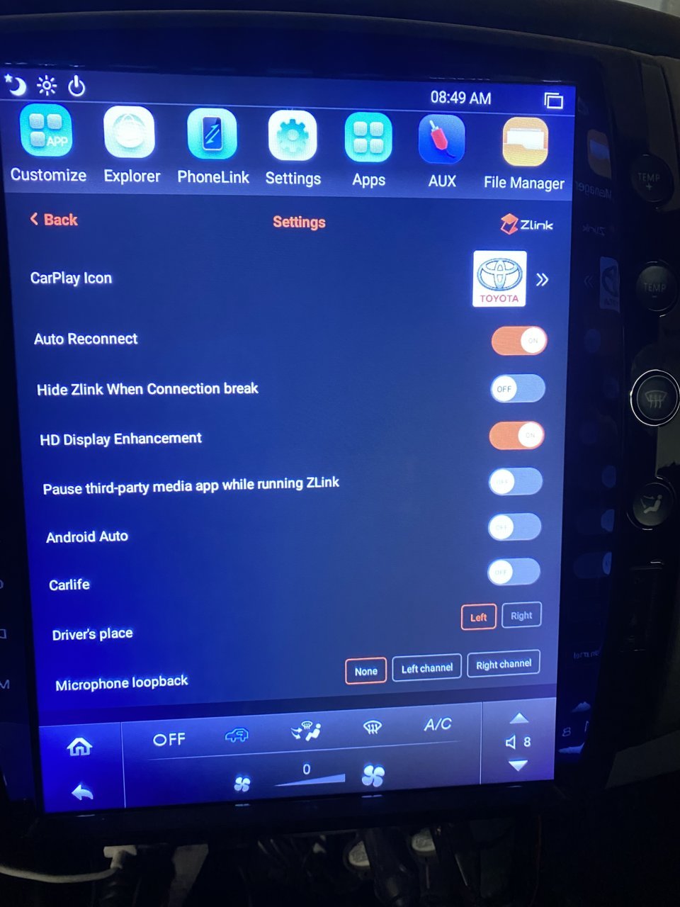

    For the wireless CarPlay I was having connect issues also. What fixed it was going to the zlink settings menu and turning off android auto…..it was on by default. Pic below of my zlink settings.
    TPMS requires a separately purchased box on their website.
    No one received bezel clips. You reuse the original ones.
    Can’t speak to the rest of your problems since I’m not experiencing them.

    Thanks for posting this I was having similar connect issues and this fixed it for me as well
    Airdog[QUOTED] likes this.
