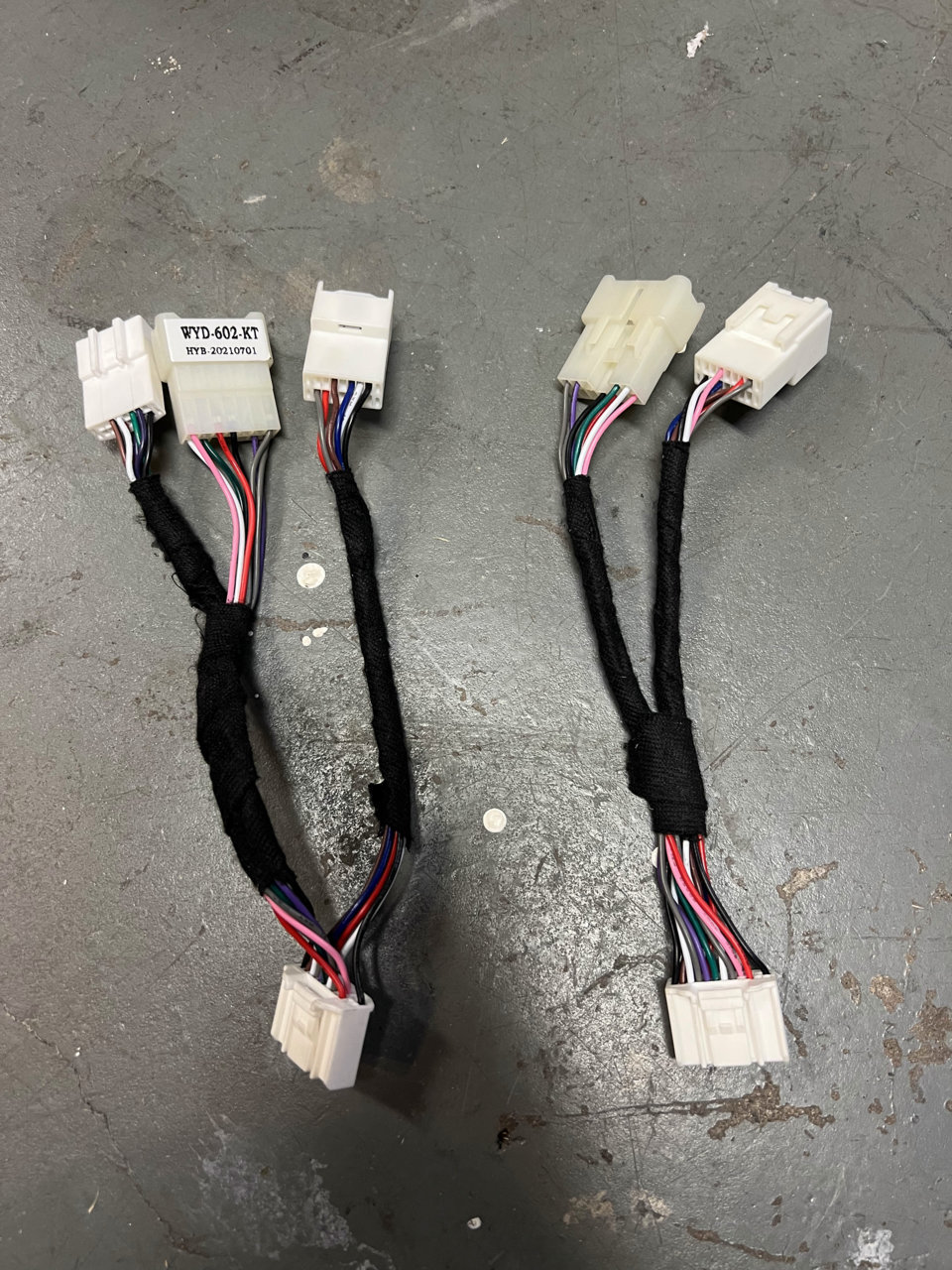

    1. On the first install the AC wire harness did not match up to my 2015. It did have the connector for the older silver-style AC controls. This was not a big issue as I know the old and new style AC controls can be swapped out. I sent them photos of the connectors it needs also with wiring diagrams and within 1 week they made a new harness that has both the old style and the new style connectors. Pictured below
    New harness that will work with both old and new style AC controls on the left. Original on the right.

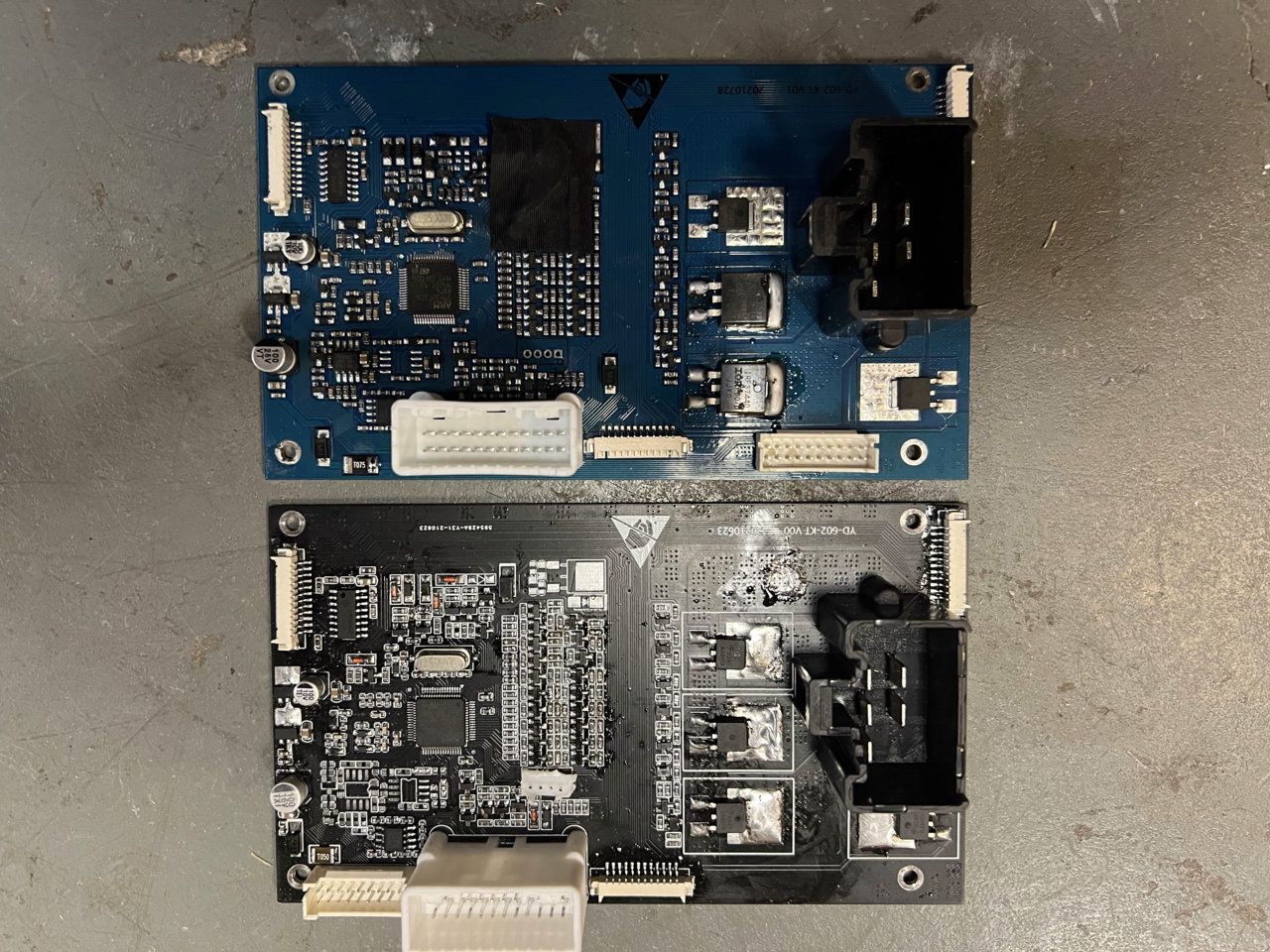

    2. After being able to connect my AC controls and test out the unit the second issue is the high-speed MOSFET on the board overheated and shorted out. This caused the AC high fan speed to stay on. After removing the unit, inspecting, and troubleshooting I found the shorted MOSFET. With a temporary repair made to the board, replacing the MOSFET, and adding an external relay to take the load off the MOSFET I was able to continue testing.
    3. On further testing with the temporary repair all the AC speeds worked as designed. The Temp changed correctly but the damper position (Feet, Face, Defrost) was not switching correctly. After troubleshooting and testing the voltages on the MSET wire it was found that the voltages do not match the stock AC controls. They were close but about 1.5 volts too low causing the switching to be in the middle of 2 settings. Aucar was contacted throughout this testing and sent videos of all the issues with the AC board. Within 2 weeks, they manufactured and delivered a new AC board with bigger MOSFETs and MSET voltage issue corrected. Picture of the old and new board below.
    Top; New board with heavy duty MOSFETs for Hi and MED-Hi speed, the board was completely redesigned to make changes to the MSET voltages. Original on the bottom
