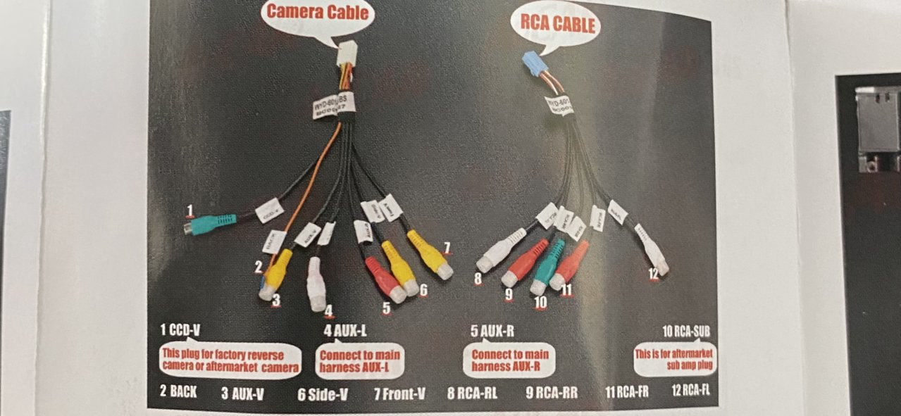

    Which input should the reverse camera be plugged in to on the harness?

    I have an aftermarket reverse camera I have the trigger wired but the harness doesn’t say back or reverse

    According to the instructions it should be plugged into the green rca plug marked CCD-V

    You didn’t get the little pamphlet??? Here’s the part about camera hook ups.
