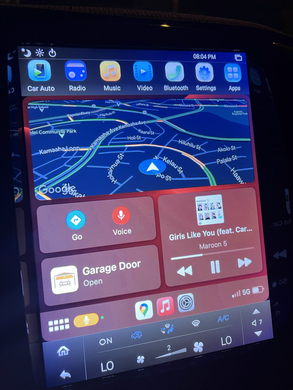

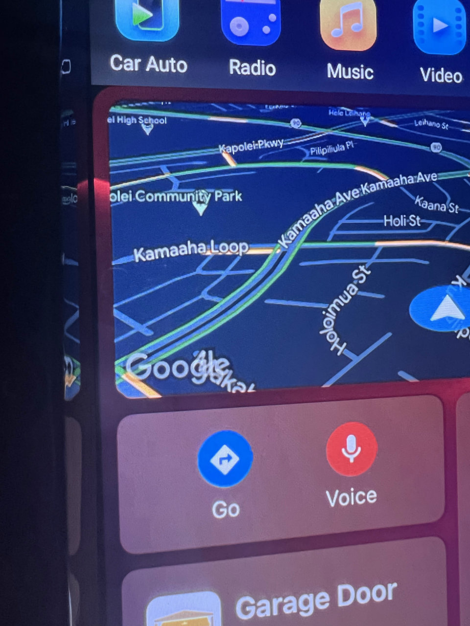

  19. Jan 19, 2022 at 10:26 PM
    #759
    arcenik
    arcenik [OP] TRD
    Aug 12, 2017
    #226644
    853
    Jon
    2015 X-Runner
    If anyone wants to give zlink a second chance I just updated mine to 4.0.18. The installation was easy and it reconnected fine after the update. I have now done this on both my test unit and the one I use in my truck and both are working good. I have no long-term review yet so if yours is working great you might want to wait a while. If not you can give this a shot.
    Instructions;
    1. uninstall zlink
    2. Go to user settings and save and reboot.
    3. Install APK from the flash drive.
    4. Go to user settings and save and reboot.
    5. Reset using the reset button on the front panel. The test unit did not need to do this but the one in my truck needed a hard reset to reconnect Bluetooth.
    I also found out you do not need to use Apple Maps. In the photos I am using Google maps, this might not be new but I learned this today.
