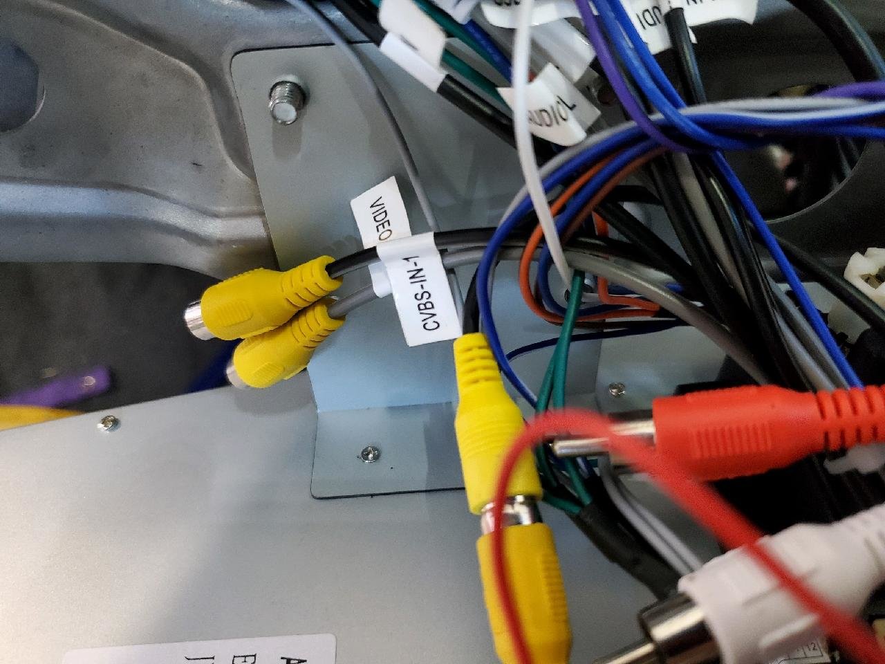

    Somewhat off topic, but maybe you guys know the answer. My neighbor bought a "Tesla Style" head unit for his 2009 Lexus. We got it installed and working (at least we think it's all working) without any instruction manual, but with some WhatsApp help from a guy in China. The primary issue we had was getting the rear camera to work. This 2009 did not have a camera from the factory, but my neighbor had previously installing some type of bluetooth camera for rear view. With this new head unit the camera is hardwired.
    Anyway there is this CVBS video input that we don't know what it's for. The guy in China was no help. Do any of you guys know what this CVBS stands for?

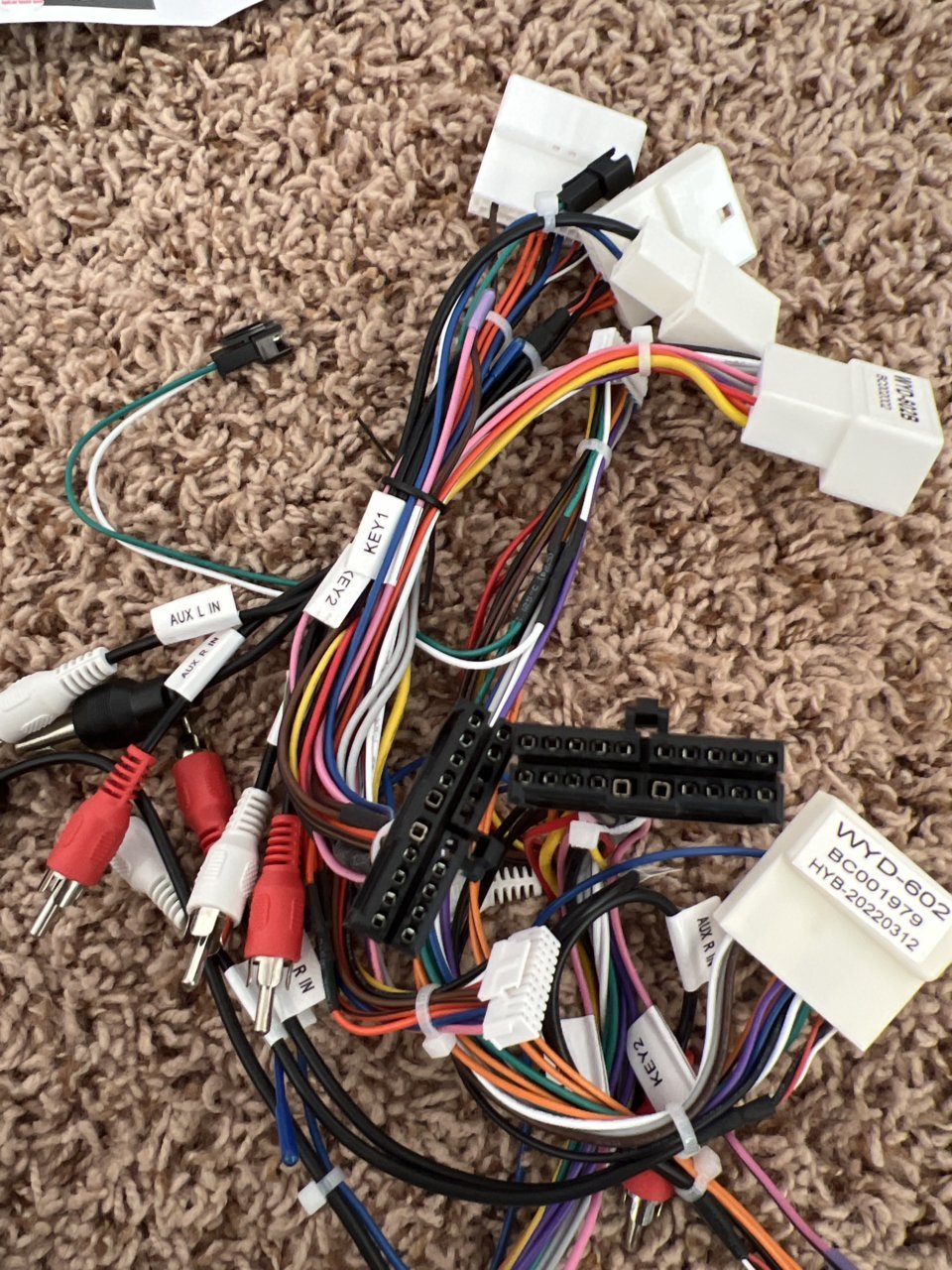

    If my speaker say JBL, do I use the harness for amplifier? I don't have a separate line from the car for amp like the original poster did. One harness has more pins and the other has some removed. Please see the picture.
