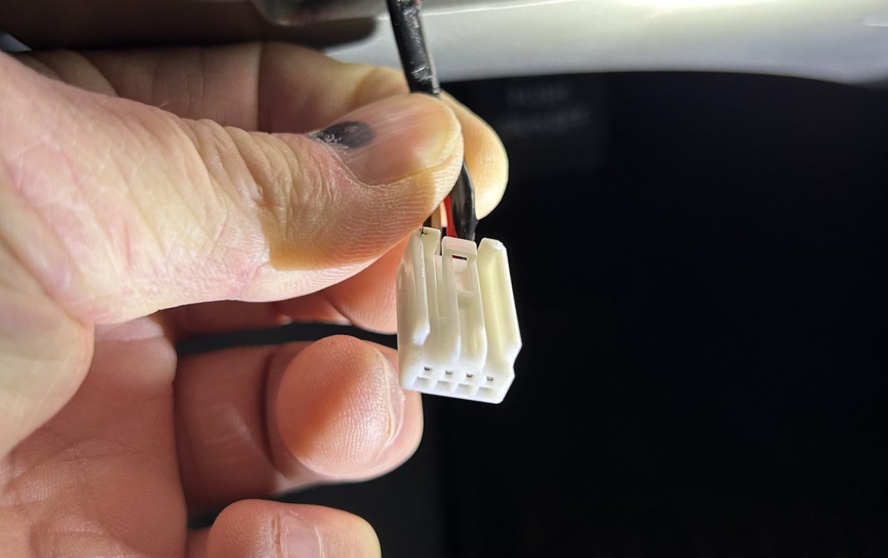

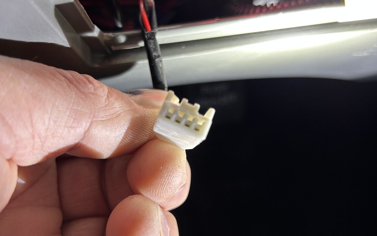

    Does anyone with a 2009 have this unit and can confirm how they got the the back up camera to move to the head unit instead of the mirror? The cable for the conversion only show it being compatible for 2010 to 2013.

    Sorry for the quality of the photo but it’s getting dark and on my phone and all but anyway, if you have this plug to the upper left hand side of your inner fuse box then yes the harness will work. That plug is for your backup camera going to your mirror and this is where the new harness will plug into then you route it to the back of the unit.3337666E-2C05-454A-83A4-AB56644A8C06.jpgEE9B1432-FD87-4B35-ACFB-A26B4D9460BB.jpg

    Perfect. Thanks. I'll check
