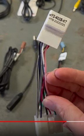

    Did anyone else have any issues with the pigtail for newer Tacoma's? (Jons hand from his video, thanks for modeling) Mine hooked into the provided harness fine but will not seat with the factory harness.
