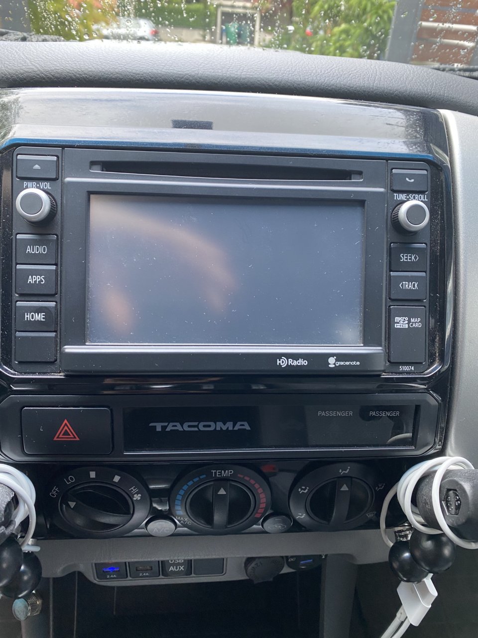

    Hey everyone,
    so I have had me Aucar head unit for a couple months and just finally installed it this weekend. Overall, just messing with it for a short time I think it’s pretty neat! However the only issue I have noticed is hissing through the speakers prior to hitting play in any music app. I do have the JBL system and have read the issues that others have had with the JBL system and just wanted to see if anyone else has ran into this?
    At first I thought it was a gain issue and played with those adjustments but there was no improvement. Or is it time I replace the JBL amp?

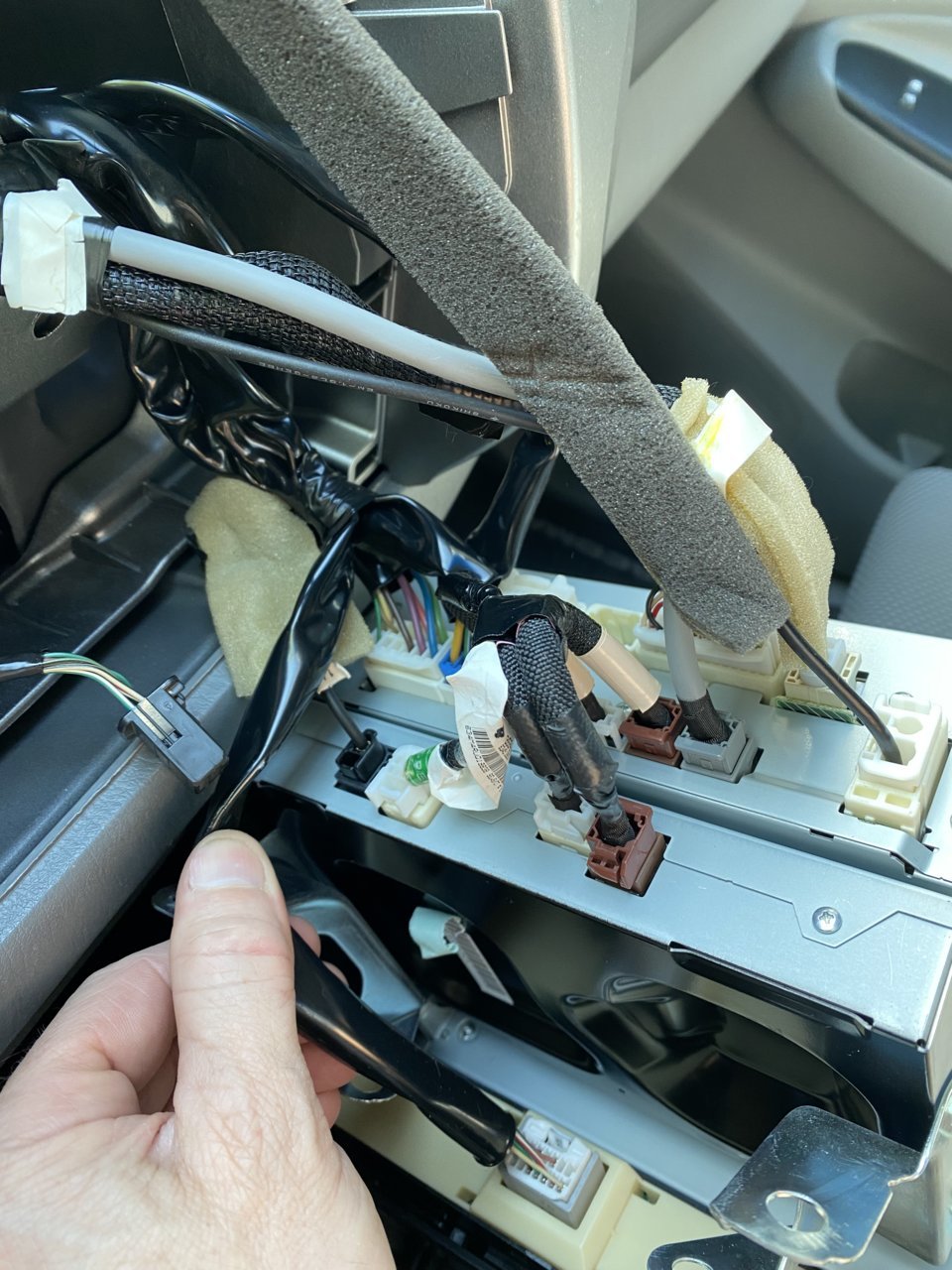

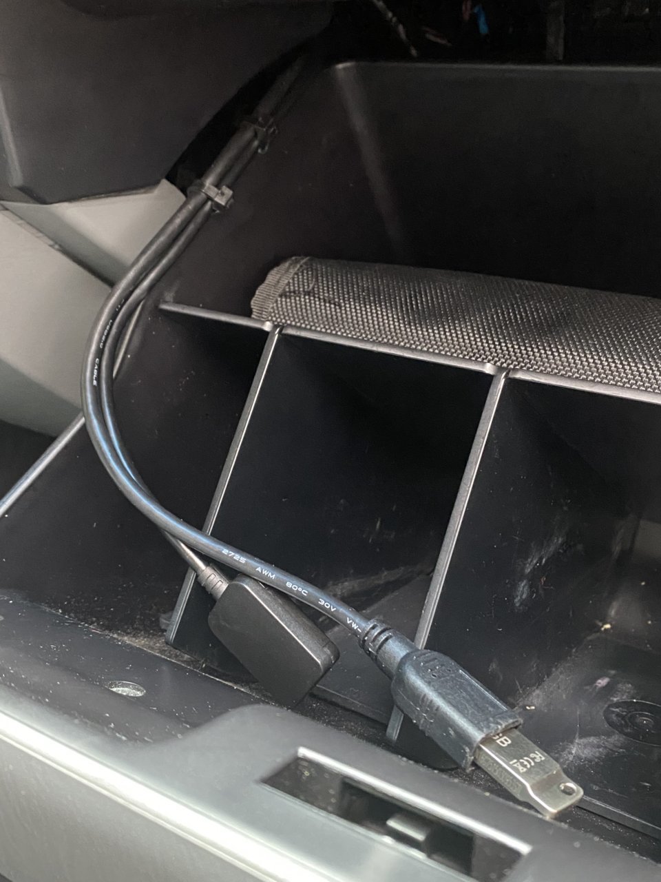

    I have been watching these units since they came out, and have been hesitant to purchase, but after following the recent 2nd gen release reviews, and with the stock unit's touch screen that stopped working a couple of months ago. I decided to pull the tigger and order one. The unit arrived a week later. Installed it, and have been using it for a little over three weeks now. No issues so far, and the fit looks factory, and the install was rather simple - after sorting and organizing the numerous harnesses and adaptors. All the while trying to read the tiny text on the instruction photos booklet :evil:. I did have to do a double take on which GPS plug to use - the white plug or the black. A quick little reference to photos I snapped of the back of the stock unit, and the white one it is. I also found that I had to connect the factory AC plug last. As mine was so short - the unit almost needed to be snapped into place for this one to be fully seated. I ended-up using the units shipping foam wedged between the dash and the shift lever to support the unit while I tested it before snapping it in to the dash mounts.
    I ended-up routing one of the USB cables along with the SIM card cable through to the glove box for access while also keeping it out of sight. I kept the other USB cable going to the factory plug, and both are working properly. I also installed the provide mic, and routed it up to the top of the drivers side pillar. Installed the 4G antennas on the underside of the dash near the pillars. One on each side. Though I am not sure I will end using the 4G data capability. But while I was in there - right. I also installed a front facing camera while I was at it. Factory reverse camera works proper, and the factory sharkfin GPS is working great - I used the SUMI-SMA adapter from DiscountCarStereo. The OBD interface only provides speed and RPM. If you have CarPlay set-up with your phone, the unit wants to connect as soon as it is powered-up. This could be an issue for some and at times you don't want it to connect. But for me it has not been one - yet. This weekend I will be playing with using the phone as a hot spot for data to the unit. And my understanding so far with this unit. Is that if you are using CarPlay, you can't use the WiFi system on the head unit. Have some of you found this to be an issue or bothersome?

    Since you use CarPlay it don’t matter, but there is an option to turn off the auto connect for CarPlay. If you don’t need it.
    The install looks great. I have had no issues with the second gen model also.

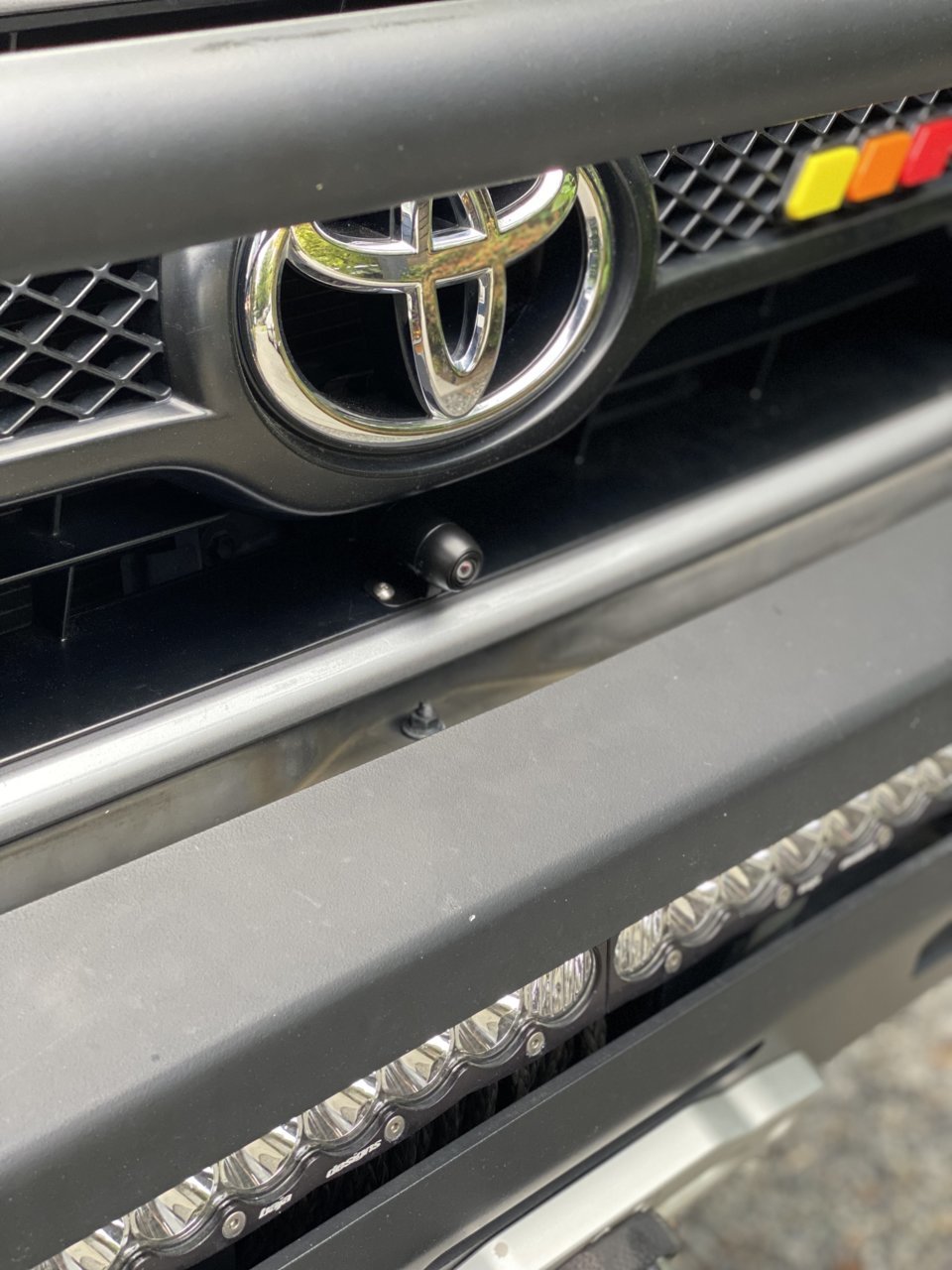

    @BeeRad any tips with the front camera install? Do you have it wired to a on/off switch? What trigger are you using or is it on constant?
    I'm knee deep in this install.

    I keep mine constantly powered.
    BeeRad and SUMOTNK[QUOTED] like this.

    I had an open spot on my sPod. So I have it temporarily hooked up there - I really wanted to test the units end connections before I locked it into the dash. I have another light project I want to do soon on the front end that will occupy this sPod spot. So I will more than likely move it over to a fuse tap on a circuit from the engine bay box to be powered on by the ACC position.
    The connection on the radio end was simple. Just one RCA connection. Once I confirmed I had the proper RCA jack and video onscreen. I spent more time later figuring out the camera placement. Which is still not ideal. But with my front bumper. I am trying to balance view, protection, installation, and replacement. I would not mind trying to route a very small diameter line and nozzle, off the windshield washer line to be able to clean off this camera when it gets dirty - will see. One more project to add to the list.:facepalm:

    Thanks guys. Maybe I'm overthinking the front camera. I'm using a "backup" camera on my front grille.
    Ar first, I was concerned about it wired without a switch and having constant power (+12v ign) when driving. The logic was the backup camera is only used for short spurts, etc.. . Versus being powered up for possible hours. I didnt know if the camera would heat up to a point where there is shortened lifespan.
    Then, I thought I should wire it to a switch and dreaded having to run it to relayed +12V because I would have to redo some wiring. Fortunately, the cam is spec'ed for >1A power consumption.
    So I think I'm going with wired to a push button on/off switch (no relay).
    Thanks again
