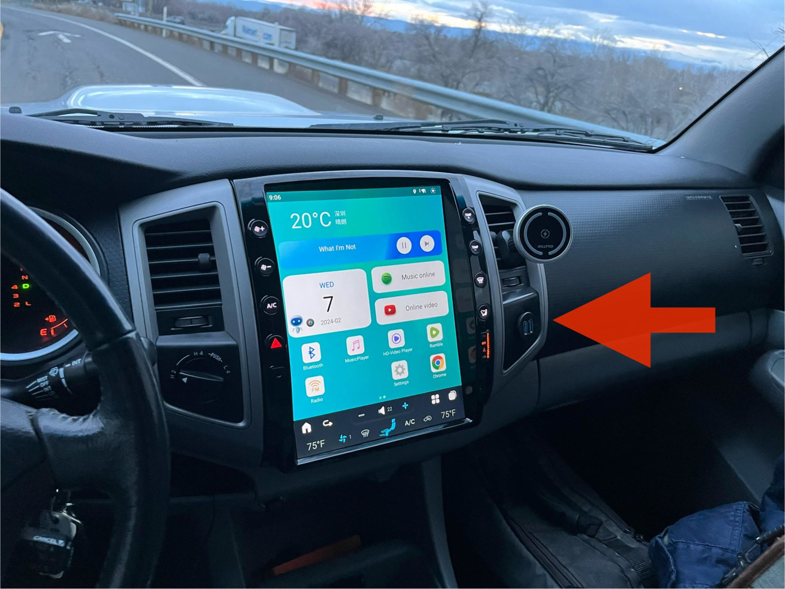

    I love mine (Android11 8GB RAM 128GB ROM). After I installed the Nov 14, 2023 firmware update, everything works and bootup is super fast, faster than my 2017 Ford Explorer Sport's factory head unit! I also have -51F always showing (not sure if there is a fix) and haven't figured out the steering wheel controls, but I will sooner or later. I ran the 2 USB cables into the plastic removable clip below the passenger air vent (this pic is prior to firmware update, hence the Chinese). Highly recommend this unit.

    that's sick! Where did you get the circular plastic with two usb holes?
