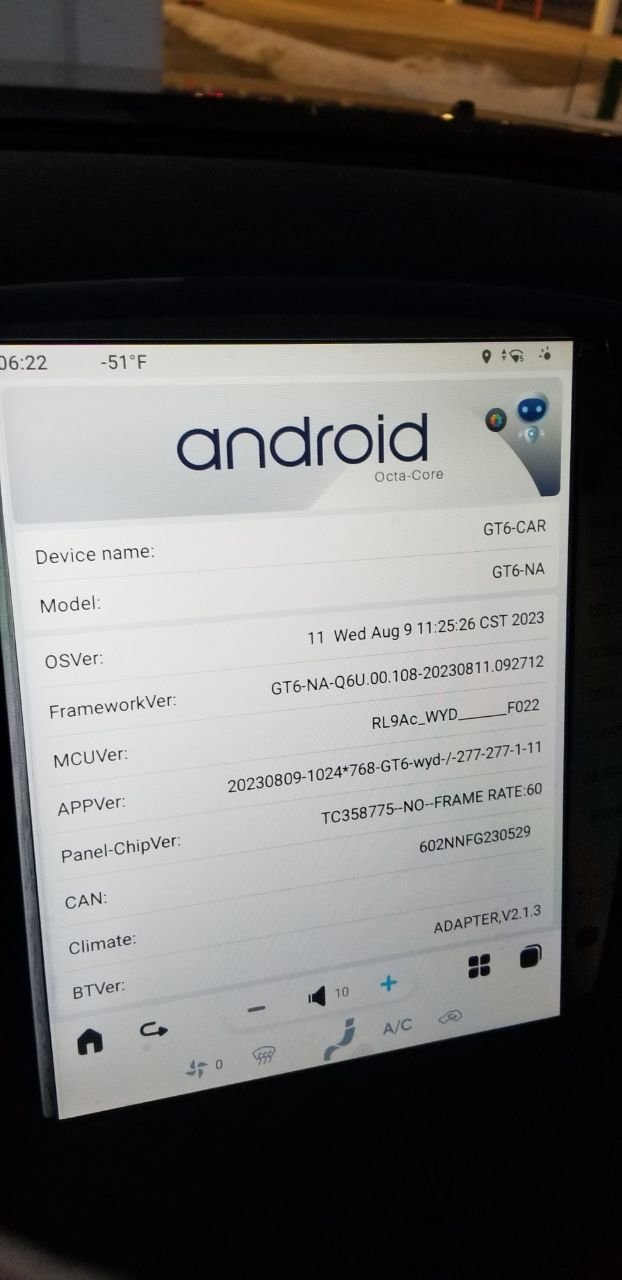

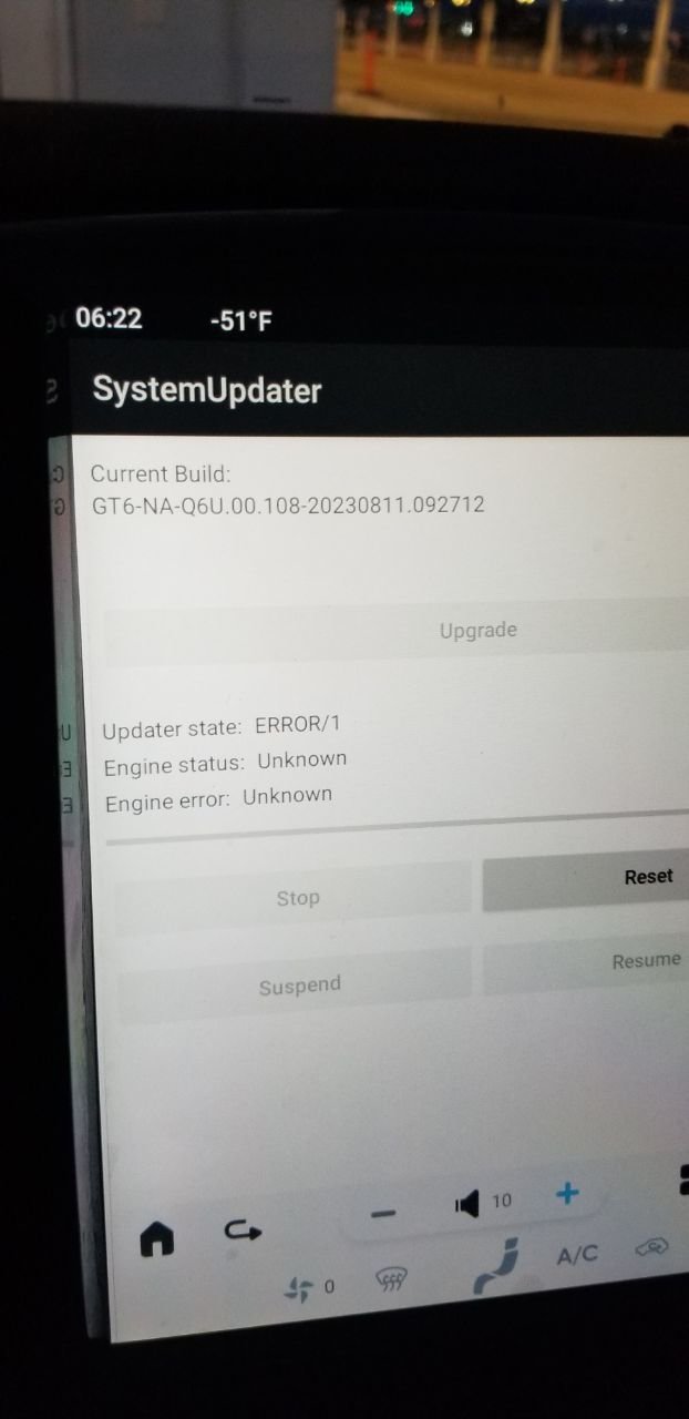

    In case anyone is wondering it seems the Nov 14th update is just the same one that comes with the unit. upload_2024-2-26_22-6-49.png

    Thank you so much for all your helpful replies.
    Unless there is a new update I think I have the one on the first page. Even though it says it's 11 wed aug 9 update and not the november one you have - it still appears it's the GT6-NA-Q6U.00.108-20230811.902712
