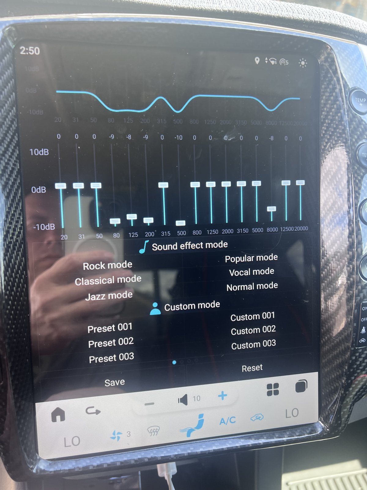

    The AuCar headunit paired with my Samsung Flip4 has been solid for me ever since the latest firmware upgrade. I've seen improvements like faster boot up, better Carplay/Android Auto usability (eg. Maps), and I finally got my SWC to work too.
    But I've still haven't figured out this issue with the EQ. I only have two preset EQ settings (Rock and Popular mode).
    And when make an EQ adjustment, I'm only able to control about 2/3 of the audio range. For example, if I adjust the slider for the highest frequency, the EQ moves for the midrange spectrum. Photos attached.
    Anyone else seen this problem? Do you guys have more than 2 EQ presets? The manual shows more than two. @arcenik any ideas?

    I have not played with the EQ. I use a kicker key to give me time alignment and settings. I can check if I have more settings I will post a picture in a few minutes.

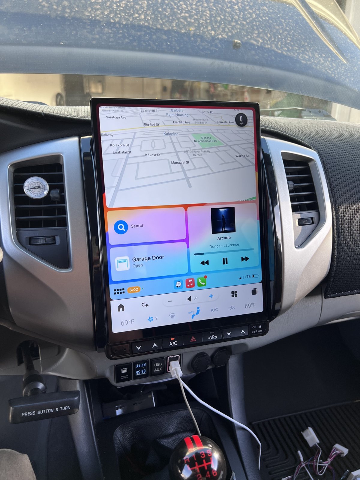

    Plus model coming soon.
