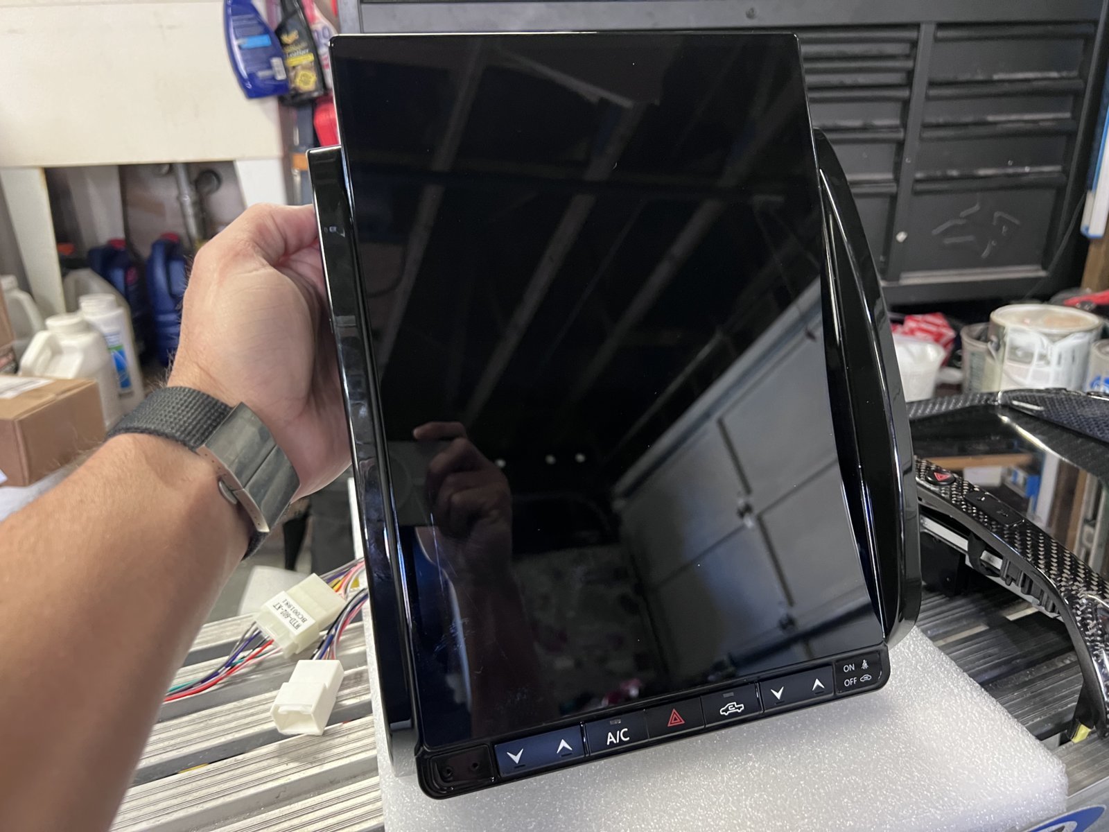

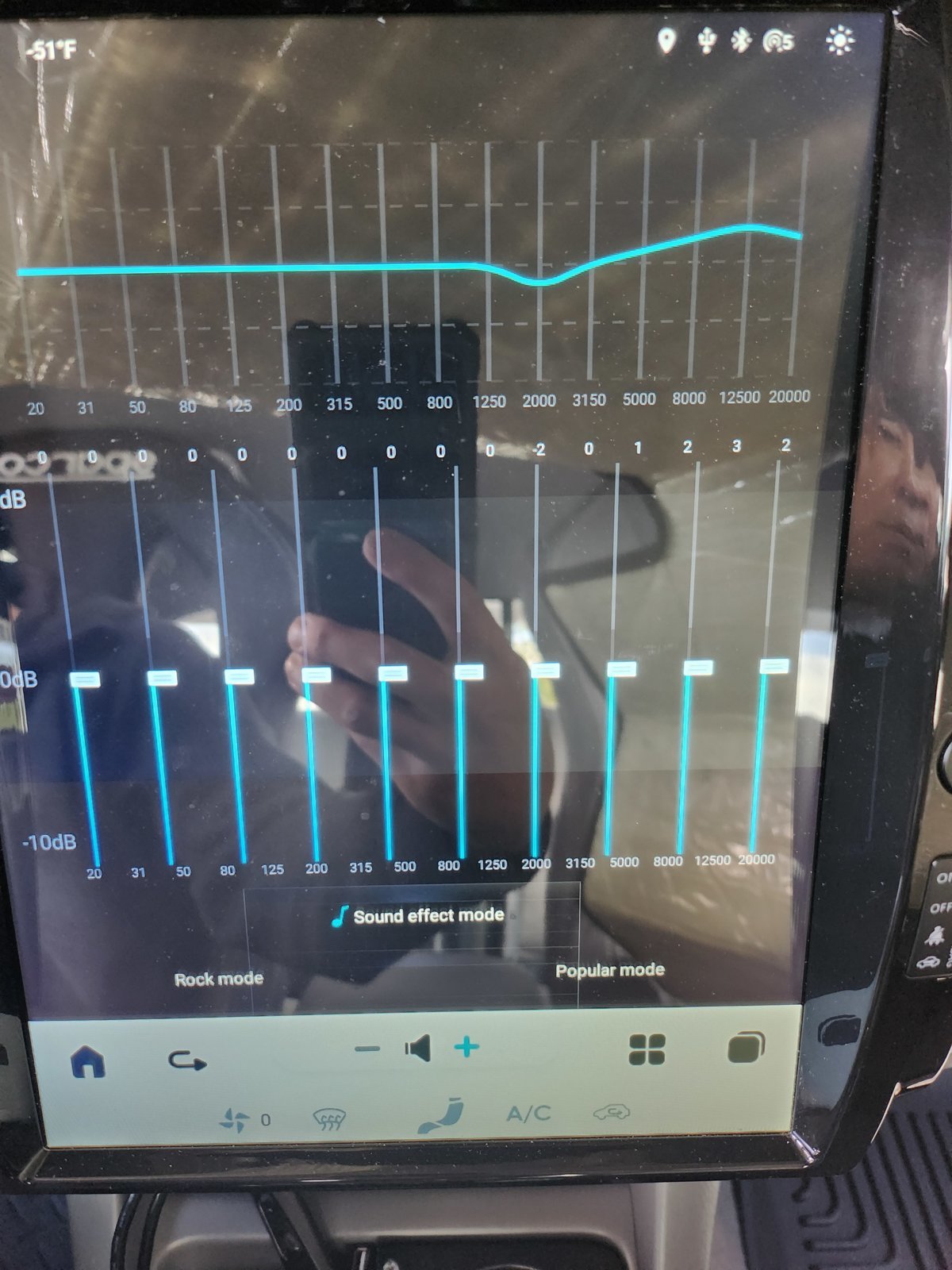

    Dude, where do you live ???
  5. Apr 18, 2024 at 8:20 PM
    #1345
    El Tano
    El Tano i am the one who knocks
    Jun 29, 2010
    #39599
    2,546
    Pasadena. CA
    10 Tacoma TRD sport
    Corvette homelink FRONT: 5100 Blinstein set at 0 Procomp 3" leveling kit Allpro UCA’s. REAR: Icon Multi Rate RXT Leaf Pack 5100 Blinstein. 17x9 kMC wheels 0 BS 285/70 17 Wildpeak A/T4W C range Amp research steps. and a bunch of TSB's
    Why do they keep doing the bezel black instead of gray to match the rest??
    I mean, I wish the OEM was all black but.............

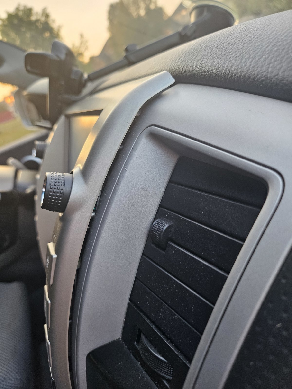

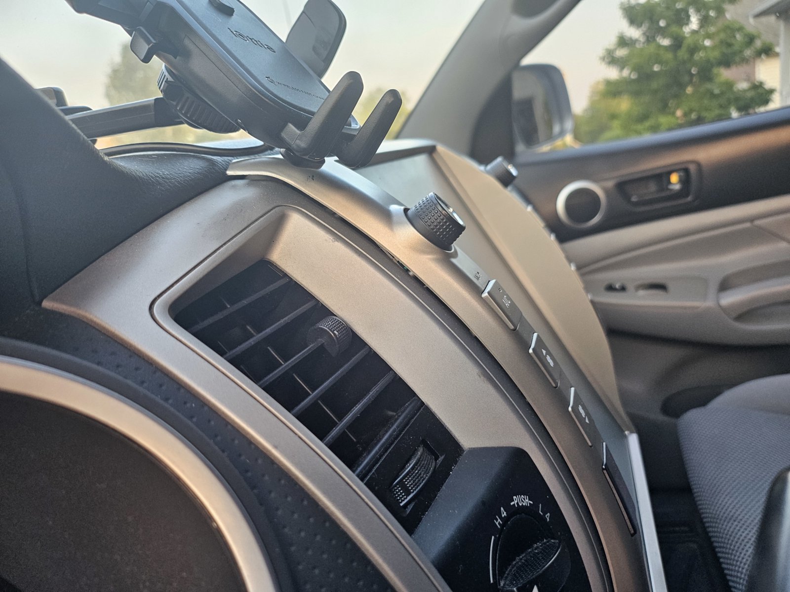

    I've had a Phoenix unit in my 07 DCSB for about 2 years. Very happy with it other than this gap. It has never seated itself very well, my best guess is the rats nest or harnesses, but I can't see where the issue is. Anybody run into this? It's definitely the correct model, as they had originally sent me the one for 2012-15 and I had to have it swapped out.

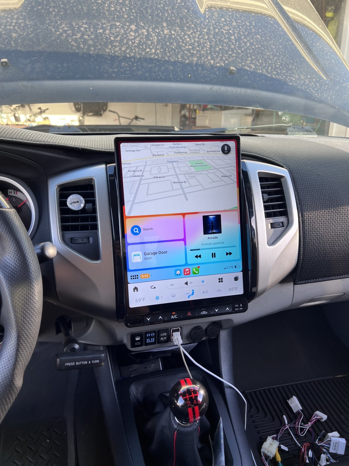

    Hi there, I just received the newest 14” max pro Tesla screen. After installing everything, my AC nor hazard lights are turning on. Any suggestions?
  12. Jul 2, 2024 at 10:14 PM
    #1352
    SUMOTNK
    SUMOTNK Pavement Pounder / Mall Crawler
    Sep 8, 2014
    #137895
    3,065
    Eddie
    NorCal/South Bay Area
    Looks like a Gen2.5 TRD Sport, but really an '08 TRD OffRoad
    TRD Supercharged / OTT Tuned
    Double check and make sure all the plugs going into the unit are snug and completely pressed in.
    The unit was a bit finicky for me upon initial install due to harness plugs not being 100% snug.
    Nandez[QUOTED] likes this.
  13. Jul 3, 2024 at 10:28 PM
    #1353
    Nandez
    Nandez Active Member
    Jun 10, 2020
    #331055
    37
    2007 Black Tacoma SR5 TSS
    K n N Intake
    Decided to unplug and replug everything. Also installed back up camera connections for a future time. Heck I might even tackle it tomorrow.
    A/C turned on immediately. I was worried there for a moment, especially in this Texas heat.
