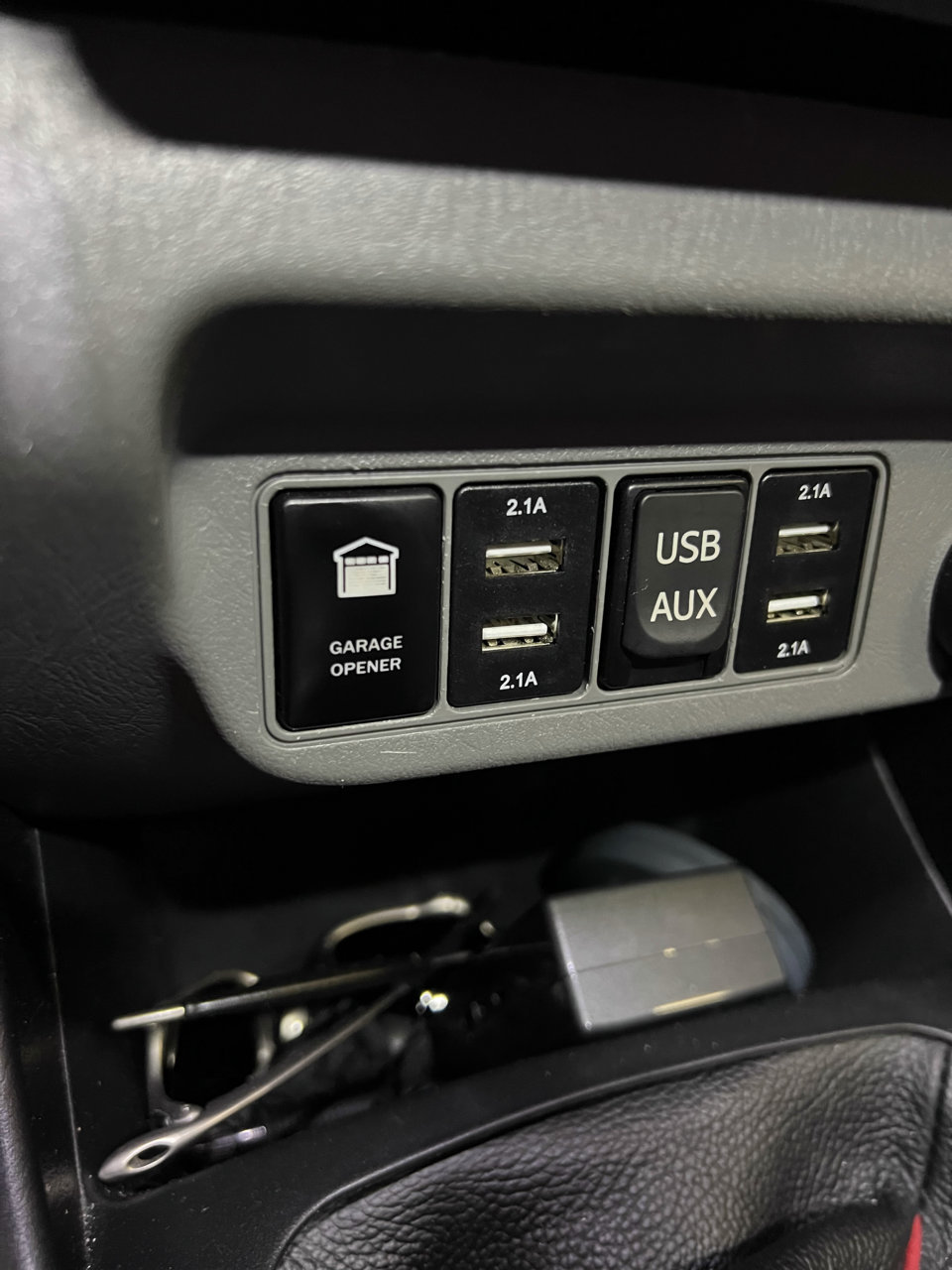

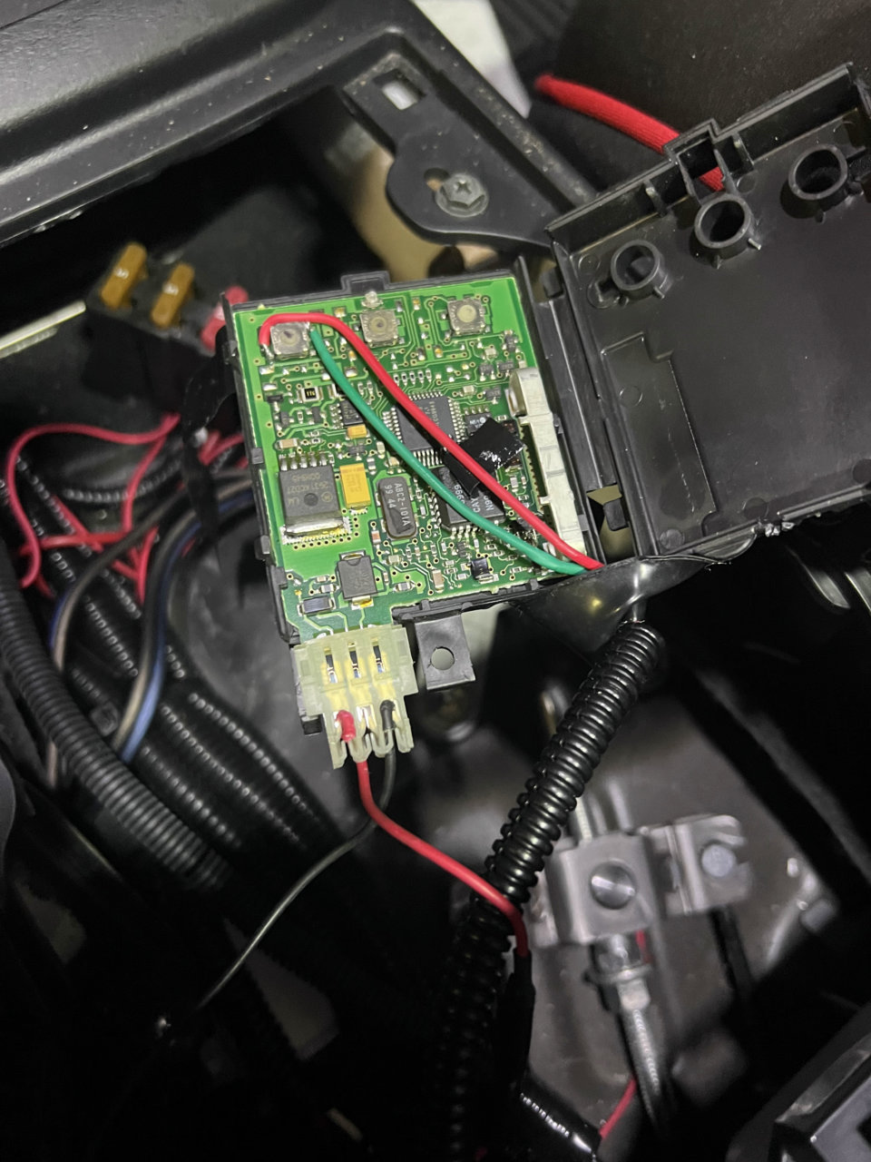

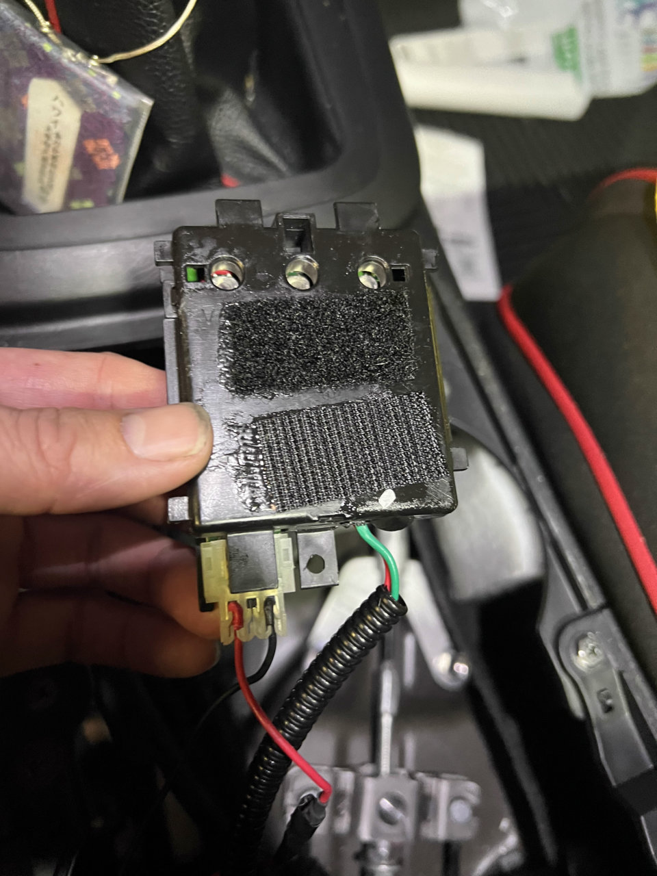

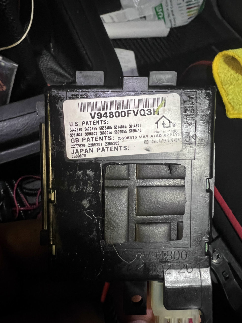

    I used a Homelink garage door opener I got off eBay like the one linked below.
    https://www.ebay.com/itm/324886898175
    I soldered two wires to the button and hooked them up to the garage door button I got from On board Air. I also hooked the Homelink to ACC power so it only works with the car on.
