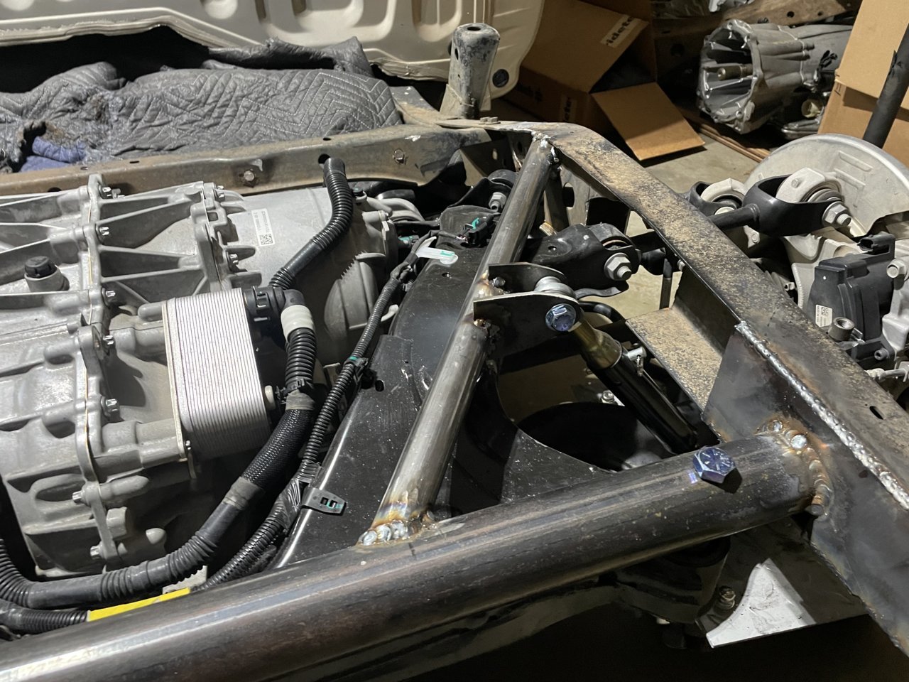

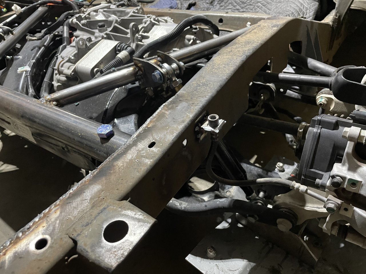

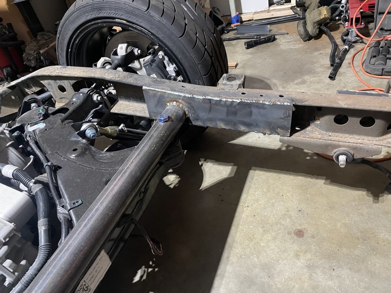

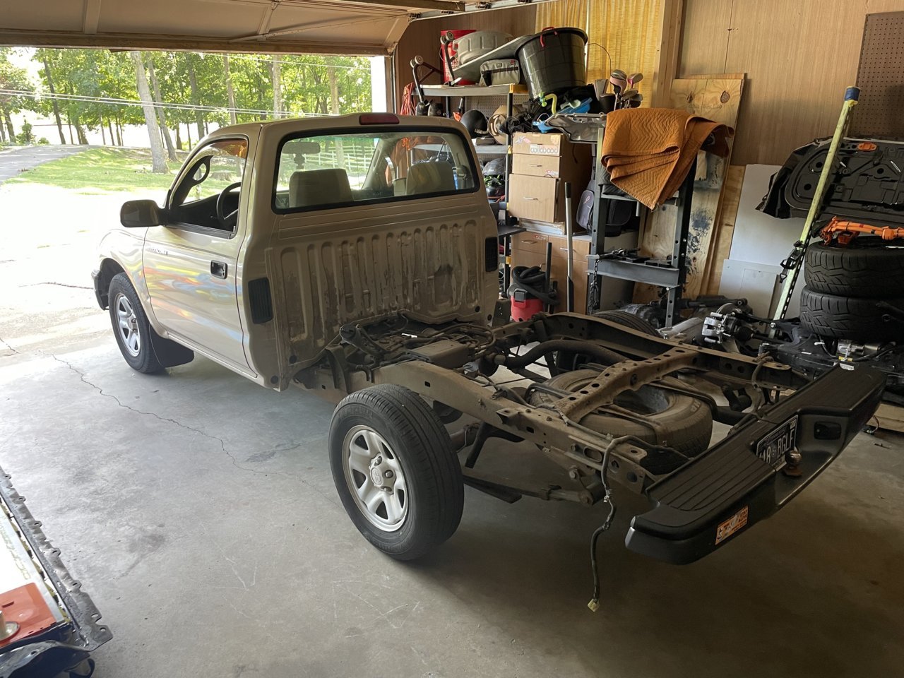

    Tonight I was able to finish up the rear coilover mounts, put a 1.5 inch pipe across and made some tabs off of them to catch the coilovers, now I can get some coilovers ordered up since I have ride height figured out
    also welded some brake hose brackets on for the rear brakes
    76291339-53E9-443A-8D1C-6A2BFE13A7E7.jpg 2102AD0E-CA19-4ED2-A832-0479843FEFD7.jpg
    now I need to put some paint on things and make some brake lines then I’ll be able to put the bed back on

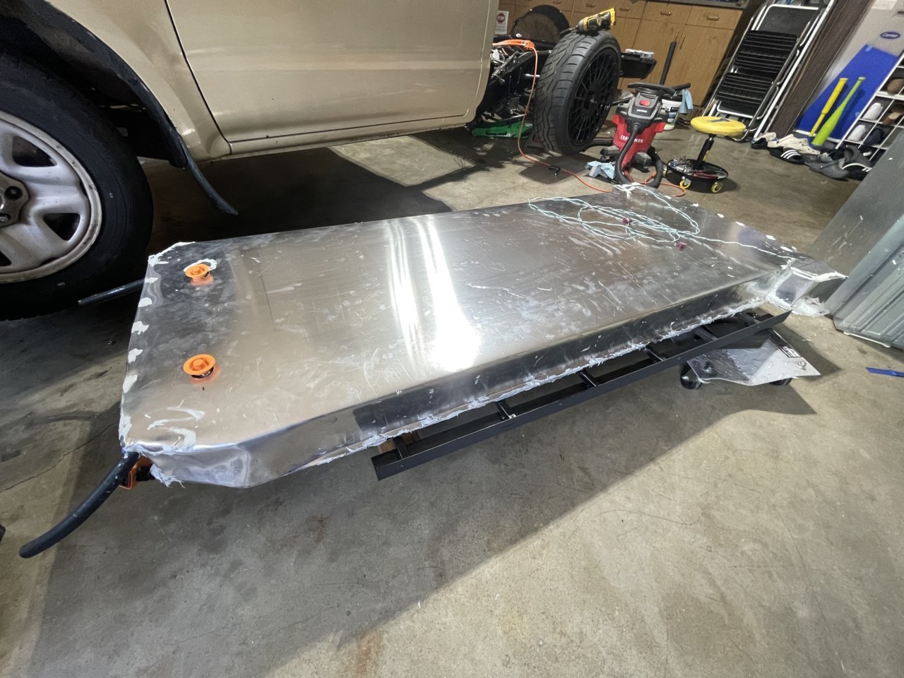

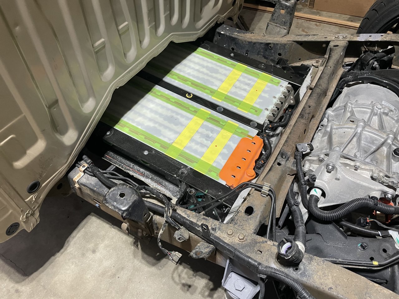

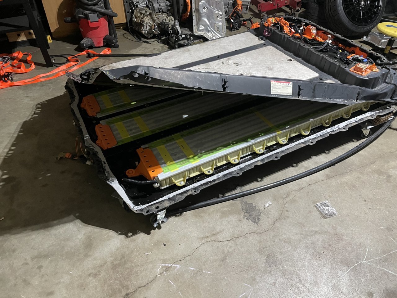

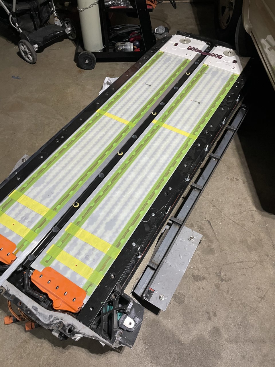

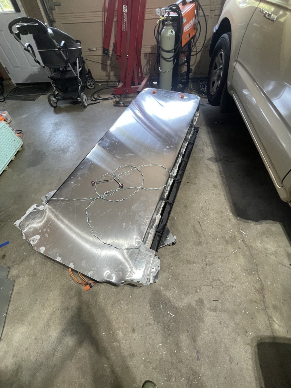

    Got a little bit more work done

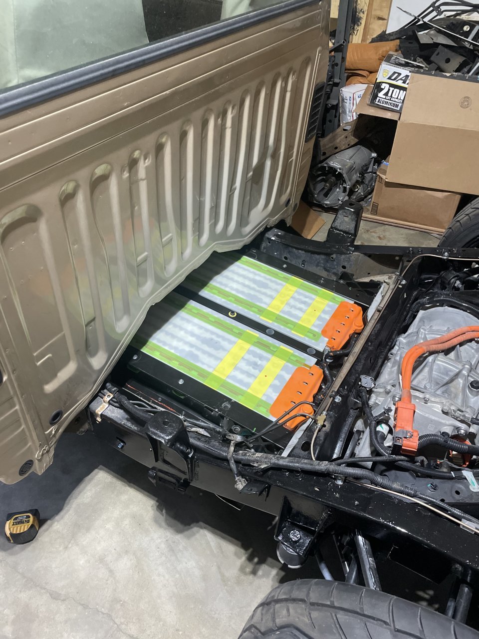

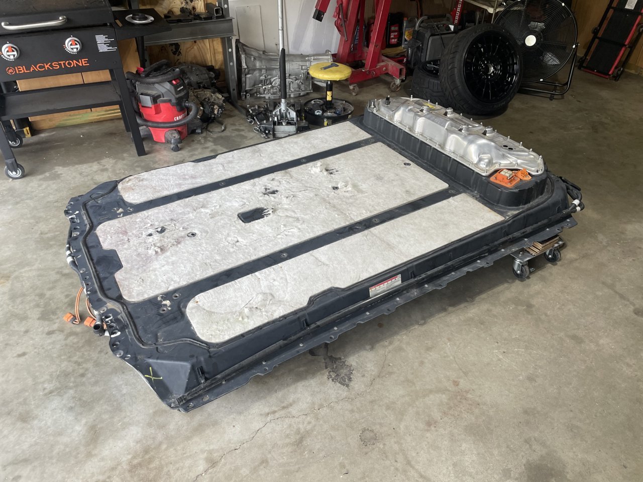

    Started knocking out the two batteries that are going under the frame, I used part of the battery box that the model 3 batteries came in and cut the sides off of it. I built a frame to sit it on that bolts in between the frame rails. I then drilled holes and bolted the battery frame onto the frame I made6B9469AA-CE37-4E34-9461-E6976E0F1B7D.jpgEEAE8573-B189-4C10-9093-45927D1366C6.jpg 325C8508-D29B-45A7-A970-63DC595CF0E7.jpgok then I took it back out and picked up a large sheet of .040 aluminum to basically cover everything up. Then used some good ol Valcan to seal everything up
    12B75609-B354-4F65-8210-11B95C7C1421.jpg 615AF1FE-3A38-4711-8003-2E2294174E15.jpg
    Then bolted that all back in and was able to put the bed back on to see what I was messing with

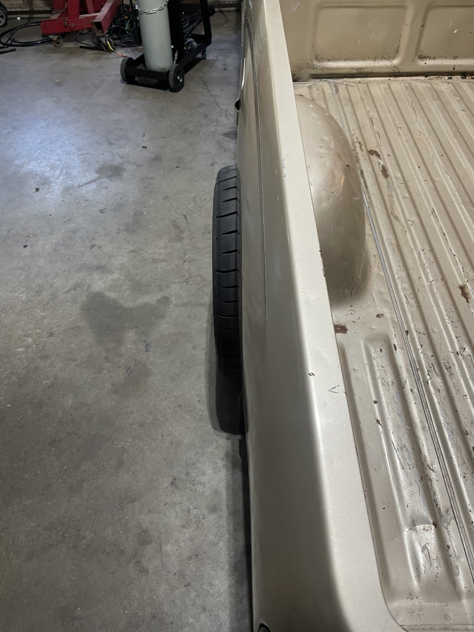

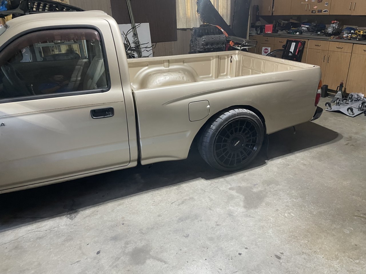

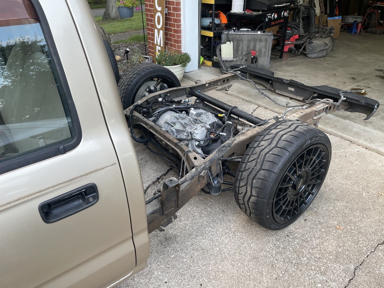

    It was a fail lol. I knew the wheels were sticking out a lot further than stock but didn’t know how low the truck was sitting.
    after a little trimming with a rough cut it’s going to work out just fine, this is ride height by the way
    3A7B221A-2ED8-4E27-9DE5-B72A76061BD6.jpg C4114532-EF02-4F6B-A825-77B4B16AA5AC.jpg FAFA2A39-70E1-4585-814E-CD5C604E7219.jpg I picked up my battery box from a local fab shop so that’s next on my list, after putting the bed batteries in then i can get a total rear weight and order rear coil overs

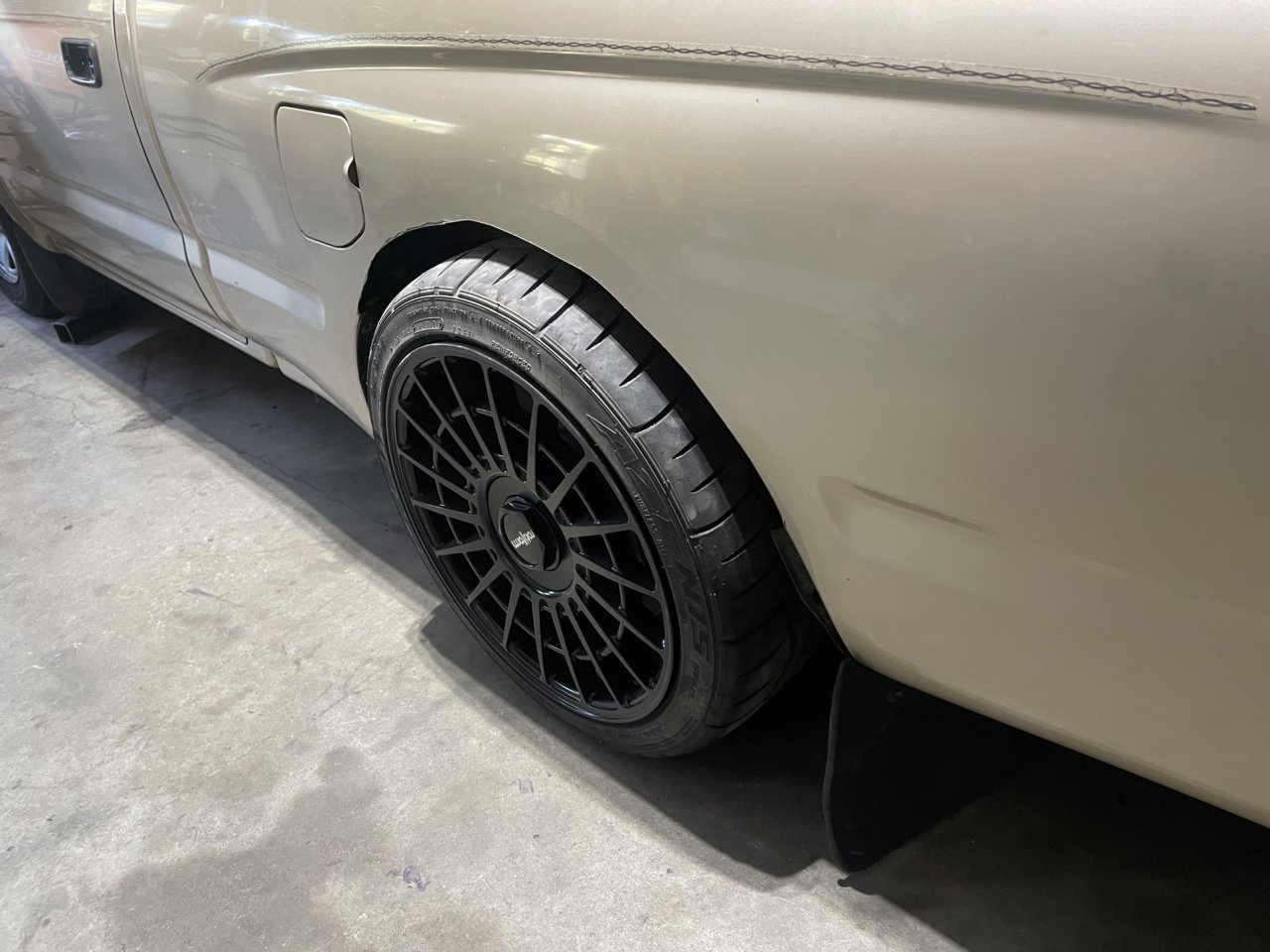

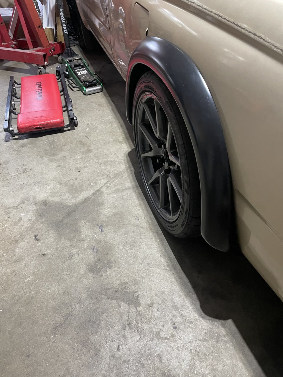

    i got that part figured out, some 2 inch flares worked out perfect
    unstpible, TomTwo, Tatts521 and 3 others like this.

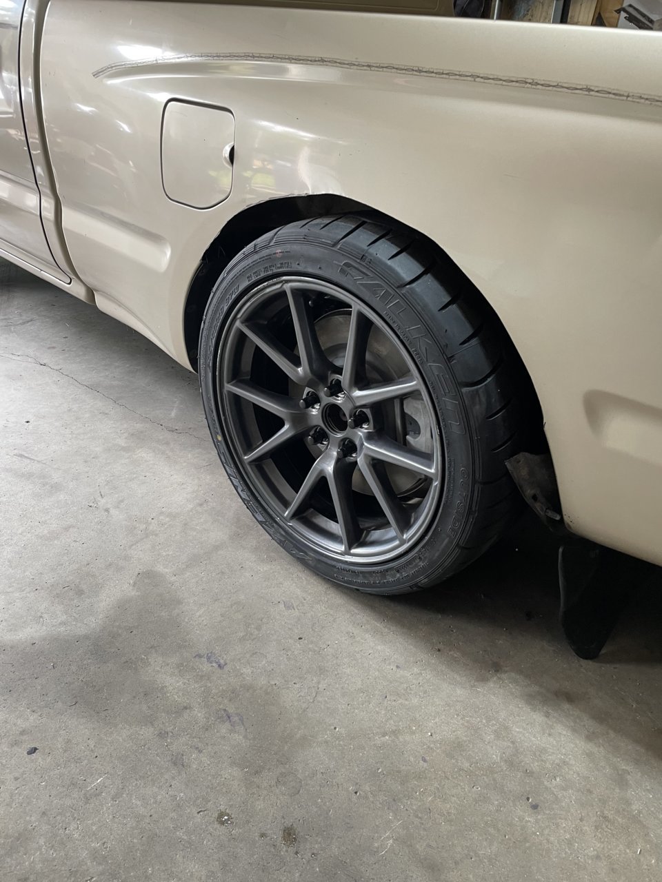

    Ended up getting some Tesla model 3 rear wheels with some 245/40/18 Azenis tires and they look sooooo good

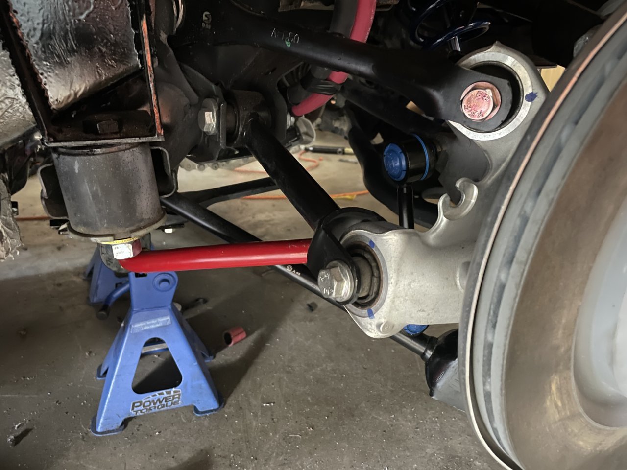

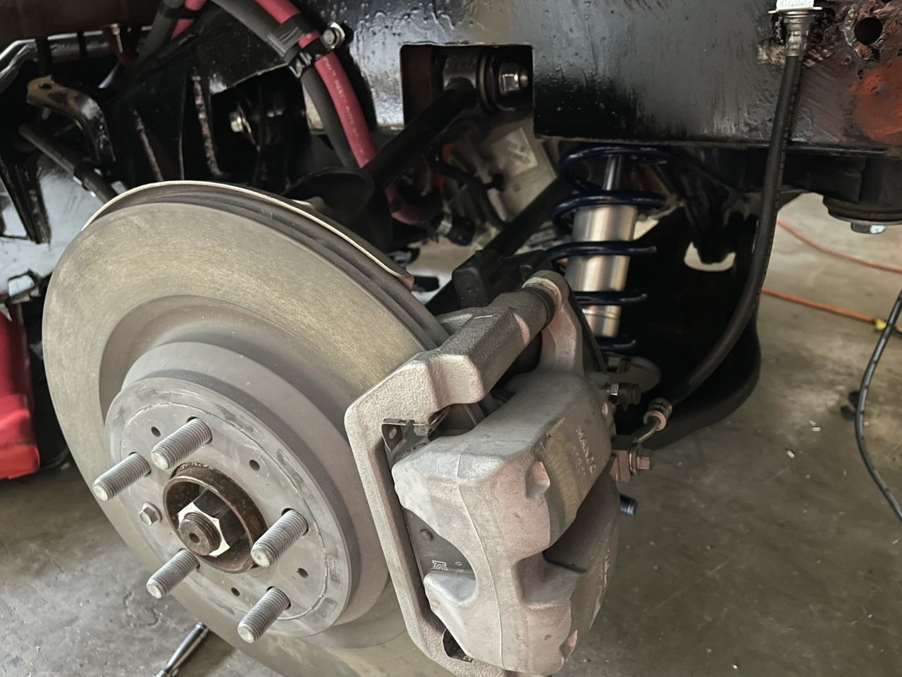

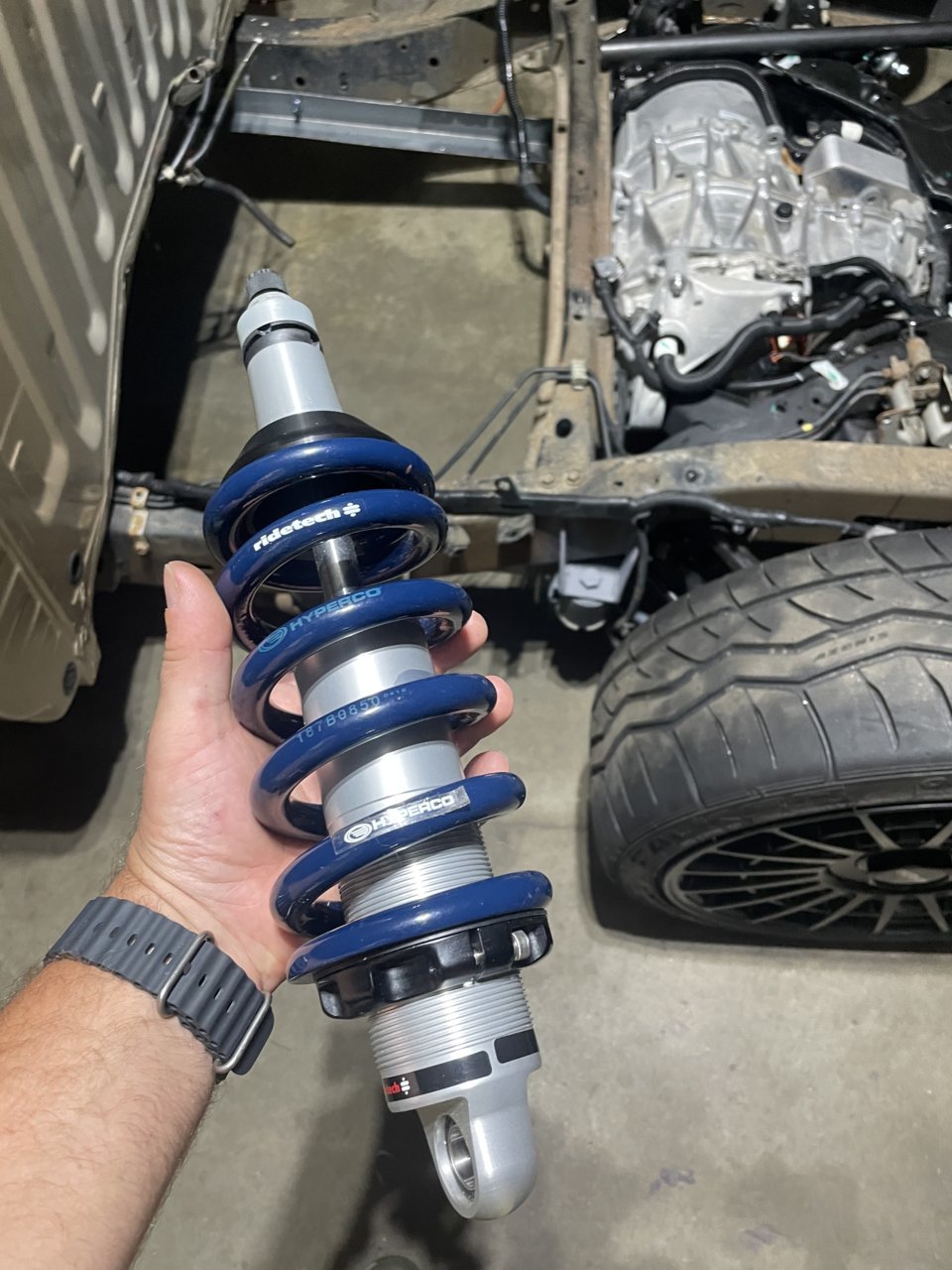

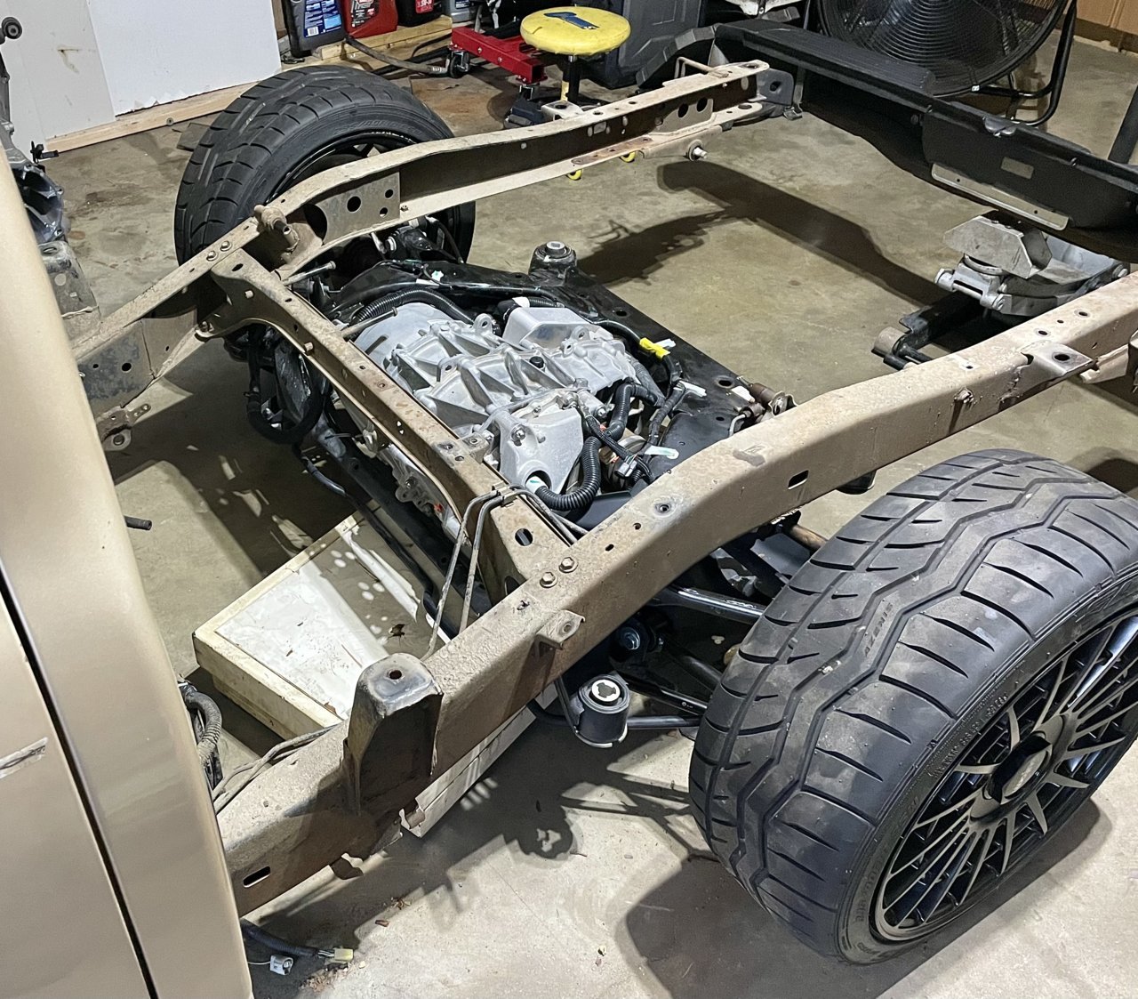

    Couple pictures from today,

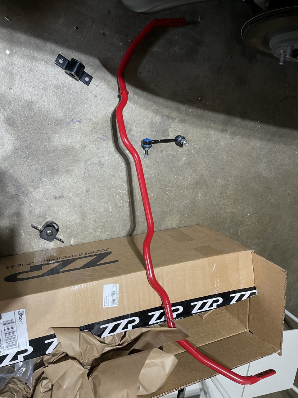

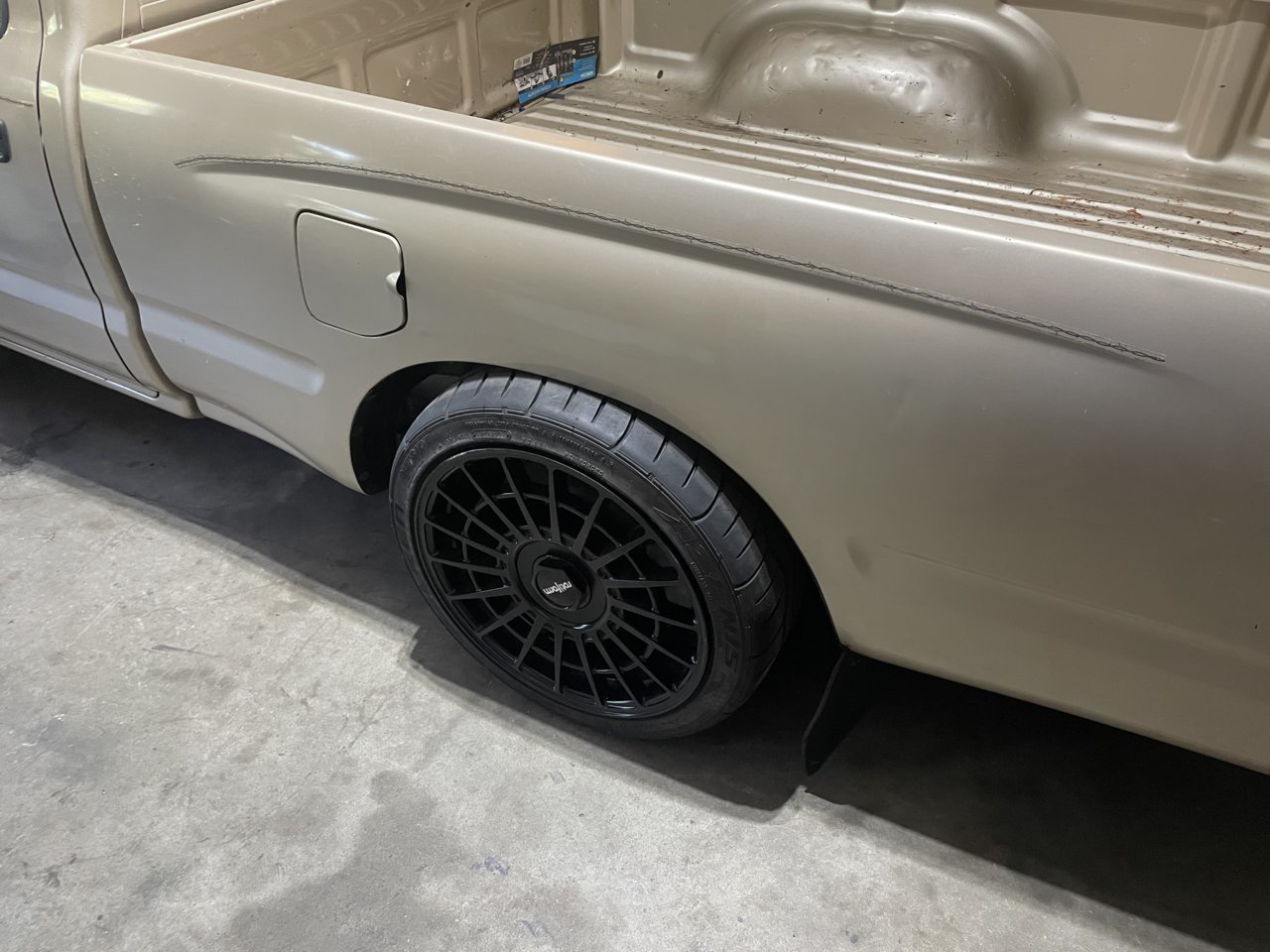

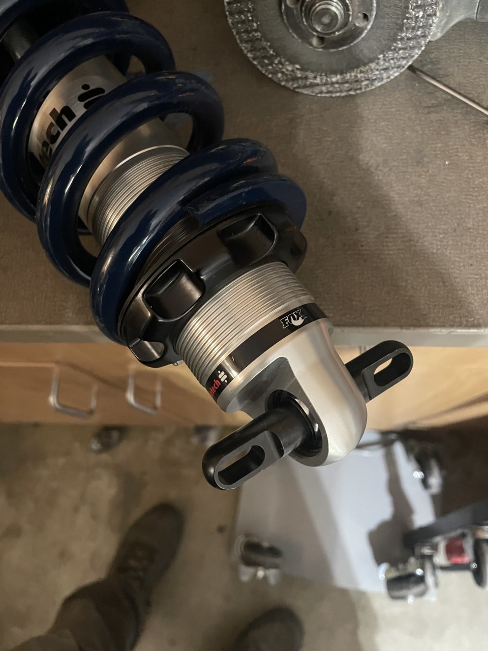

    I upgraded the factory model 3 performance rear sway bar with a massive one from ZZPerformance and finally got the rear Ridetech coilovers installed, figured I take some pictures before I put the wheels on for the final time
    7B0D5113-2F65-4D48-B848-C2234879DB12.jpg 977616C8-736F-414C-91E0-13EC2CEC8915.jpg 8C333F5F-198D-49A0-A405-D4B843B0B8E9.jpg

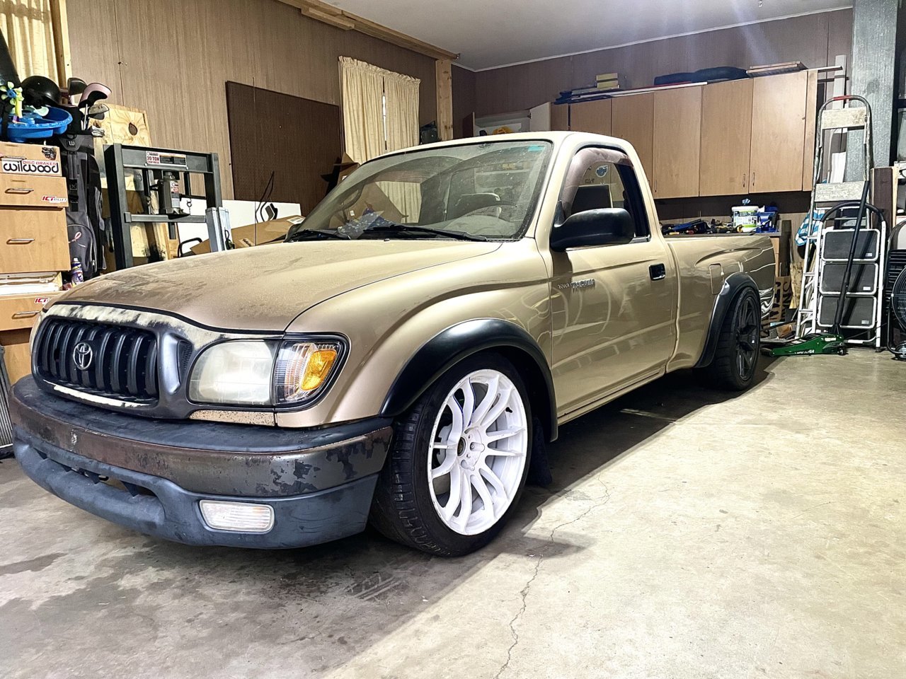

    also I didn’t like how the rotiform wheels fit the front with such a high offset so I found some badazz Rays Gramlights with a more better offset and are 18x9.5, I have a feeling with so much weight in the rear I was going to need a wider tire up front
