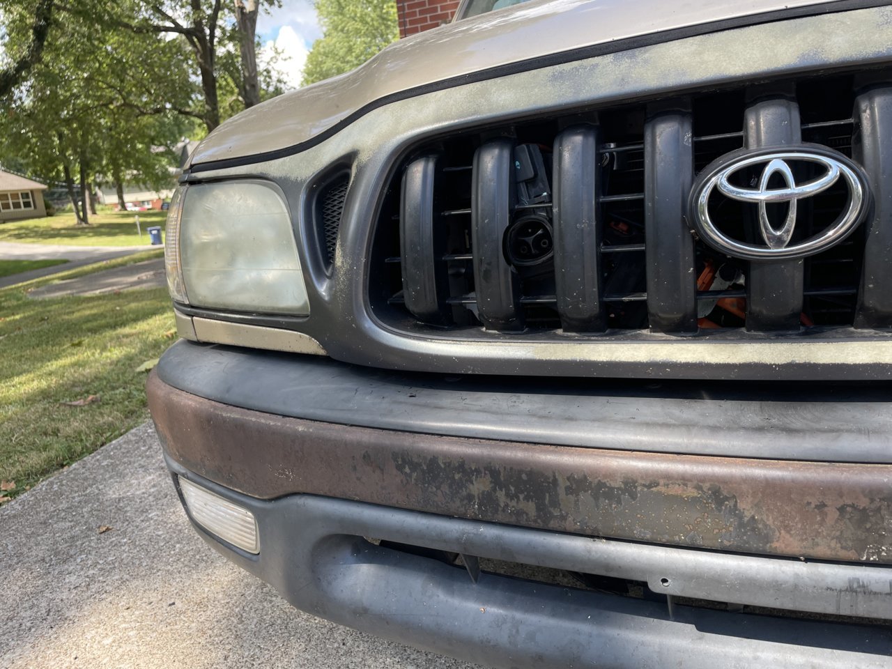

    I didn’t put the charge port in the fuel cap I know I know I’m lame, it’s just I didn’t want to buy more cables, 4/0 cable isn’t cheap lol as of right now it’s just poked through the front grill

    Smart choice - when you’re out and trying to charge, the front access is pretty convenient. You don’t have to back into a spot, dangle the cable across your hood, flip a 180 or anything when the charging cable isn’t long enough.
    The front and center access on my Leaf has been good. The back passenger corner on the RAV4 prime is annoying sometimes.

    Ah that makes since, still that's pretty cool. Could even get fancy and make a flip up cover for it that's a toyota or tesla logo haha:D

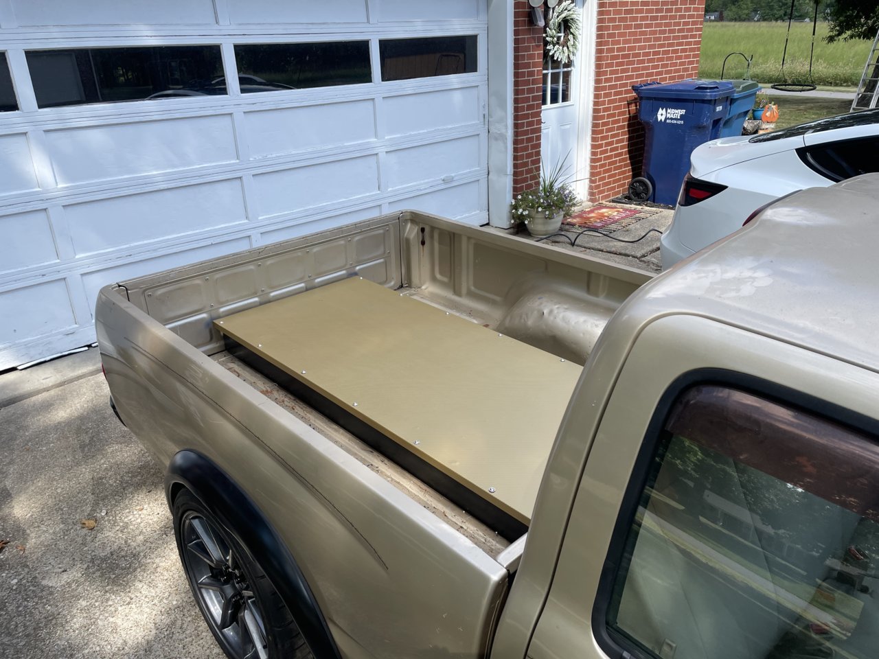

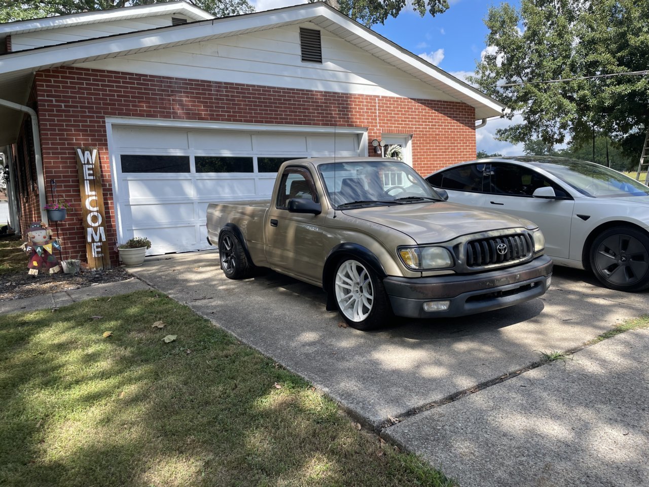

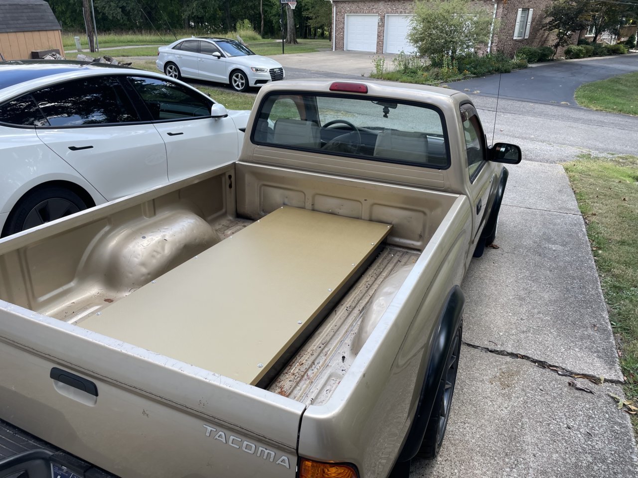

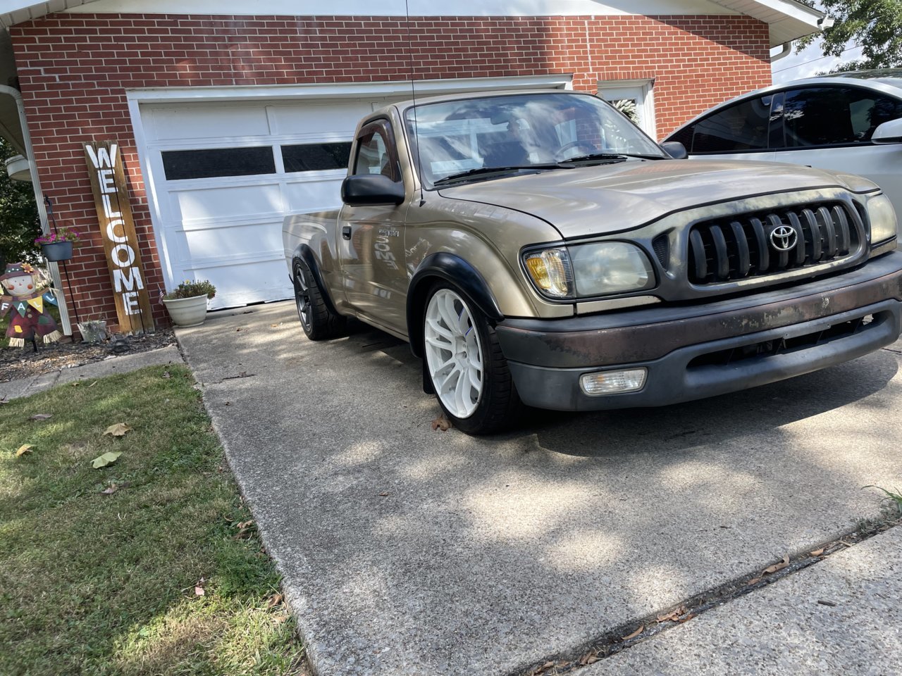

    Ok I pretty have the truck wrapped up, just waiting on EV controls to send me a new firmware update for the controller but I was able to roll the truck out and get some pictures
    11DAE8FA-4AE0-430D-A94C-EE3F4849FDAD.jpg 44F20DAA-238F-4FE8-86D7-1F67D9798656.jpg B7B8A946-FB8D-4A5D-8600-FEC8B8CF83FB.jpg
    Here is where the charger port is
    I ended up just wrapping the rear battery box lid with some golden carbon fiber vinyl, my powder Coater guy is booked up for a while

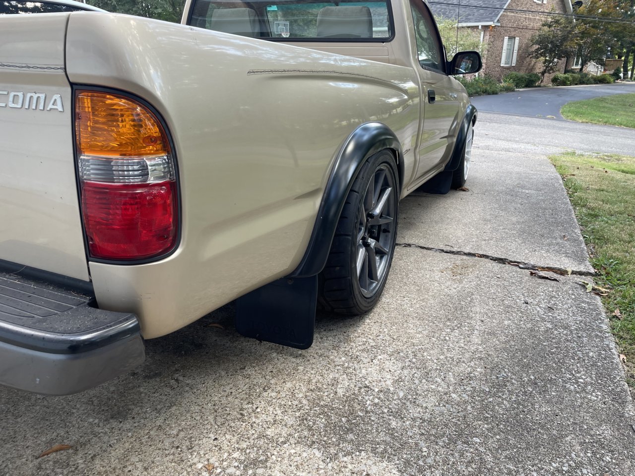

    79663B6B-241A-4634-AED8-4EB2ACEAD48B.jpg C9C10947-D1DA-4D7C-A6D6-5DA885CAE5FE.jpg

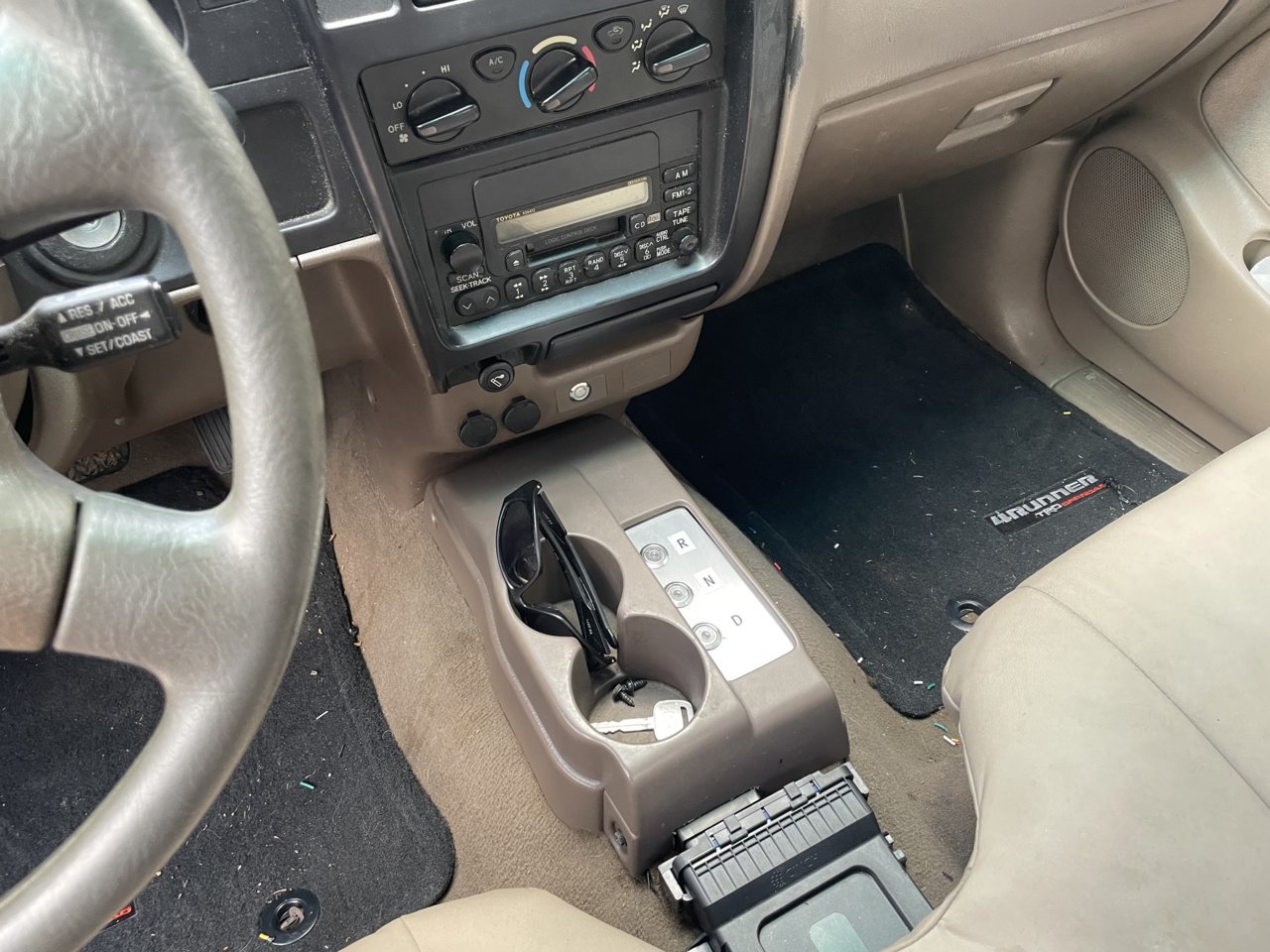

    Here is the shift panel thing I made for drive neutral and reverse
    a better picture of the front Rays wheels I picked up, I plan on getting these powder coated the same color as the rear Tesla wheels

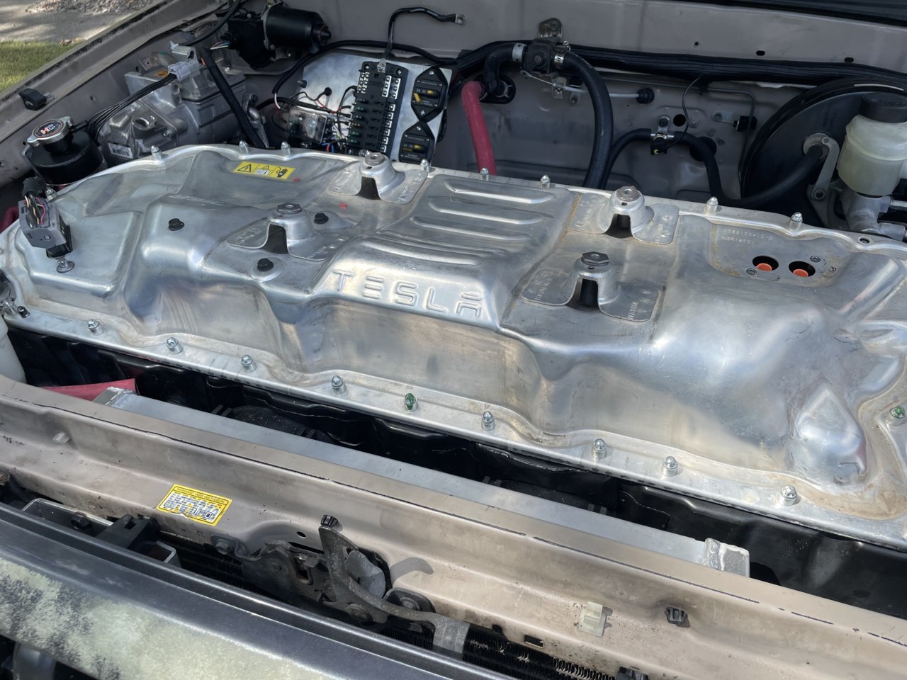

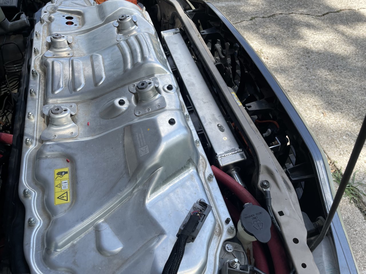

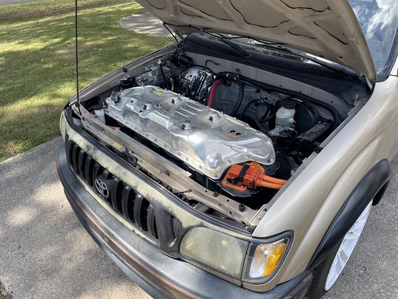

    I also noticed I haven’t posted much about the front engine bay AKA Frunk
    Here is the Tesla battery management system called the penthouse I mounted, all high voltage goes into this from the batteries
    9CBDBA8A-C240-441B-930F-B4D2EF62BA58.jpg D1BCA29C-E21E-472B-92F6-F4443E843E05.jpg

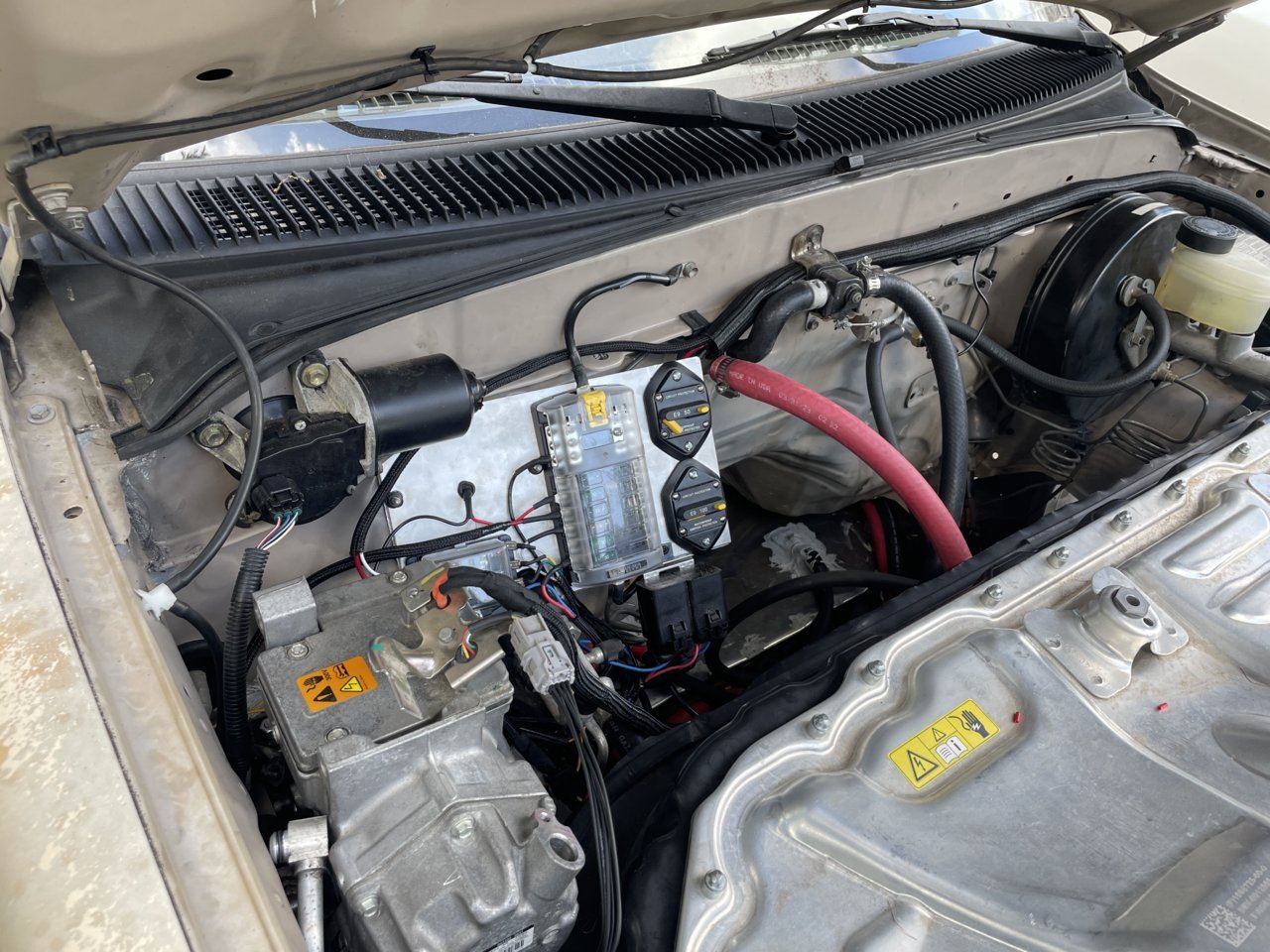

    And finally here is my power management system I put together, this has pretty much everything that has been added to the truck

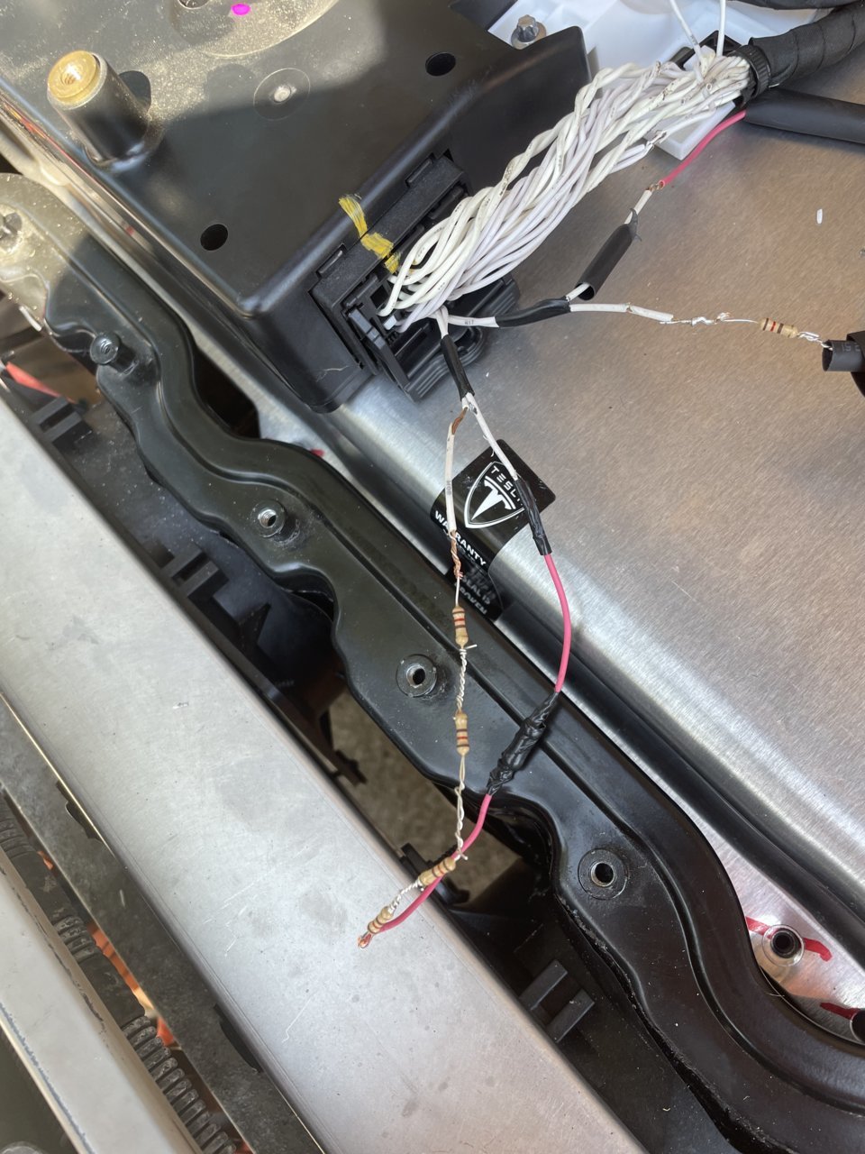

    yes and no on the easier part. Like I feel like it’s more simple. Not really that many wires compared to a full engine swap. No exhaust or driveshafts or fuel systems to deal with. But right now it seems harder, lol I’m fighting some faults with the battery controller. It’s not like I can just call up and buddy and ask his opinion.
    for instance I’m having problems getting the main contactors to close in the controller
    there are these little weird things call flood port sensors, they won’t let the contactors close if there is water in the battery, well I don’t have those anymore because no one told me they were important
    Of course no where on the internet does it explain them
    so I had to figure a way out to fool the computer to thinking they were there.
    of course they weren’t just normal switches they had to be Hall effect switches. I tried taping some magnets to the sensors with no luck
    So online I did find out the voltage drop across the sensors was 13.6 down to .6 but had to clue what the current was. So I just started at 1k ohm and just kept adding resistance lol
    Actually ended up working out. So that was one fault out of the way
