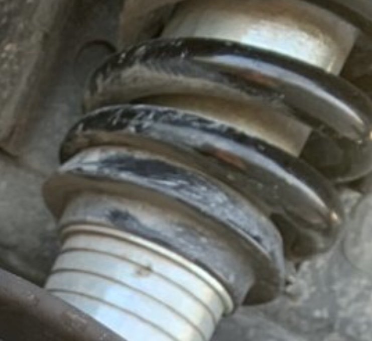

    OOF so bad.... 4th clip setting with upside down spring seat... gotta be like 4 -5in of lift.
    @JsDCTRD PLEASE FIX THIS... without the spring seat on proper the seat clip is not captured and could easily pop out of the notch causing the whole spring assembly to drop.
