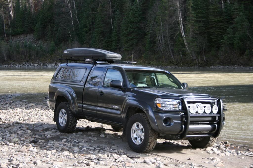

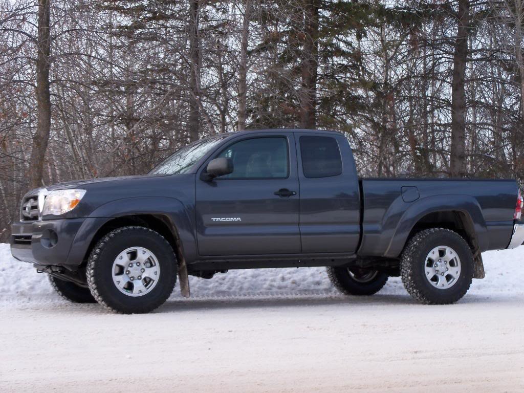

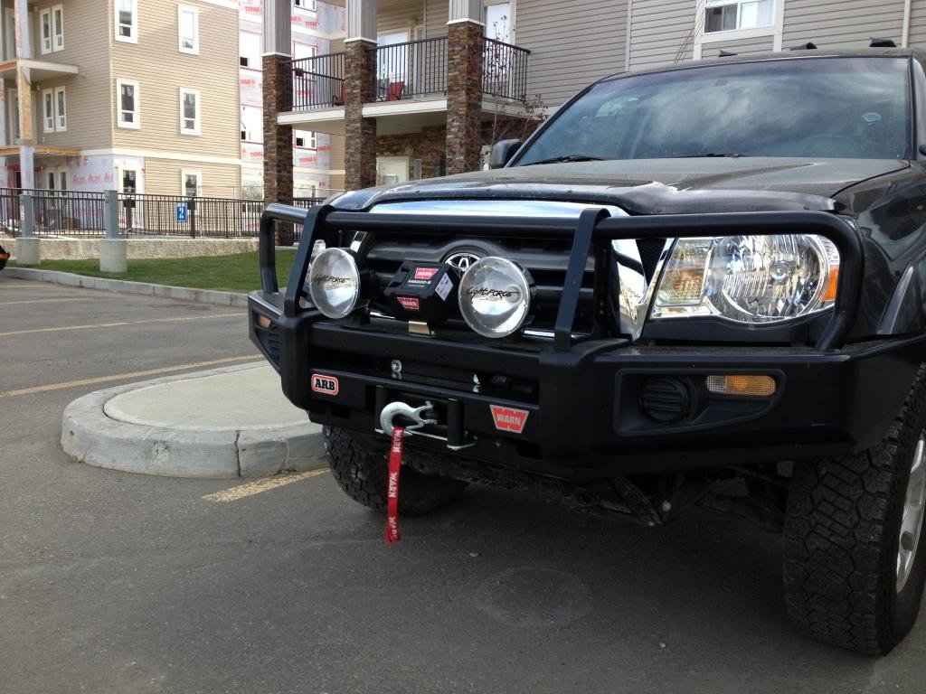

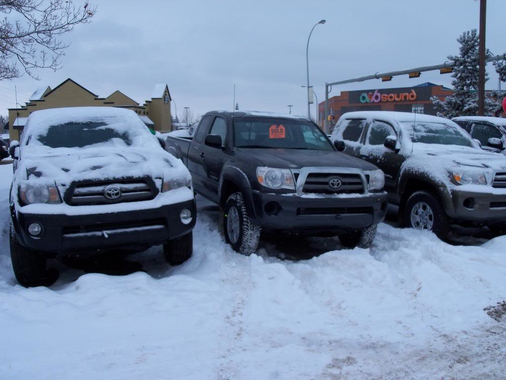

    This is where it all started... the cold, dark, dead of winter in Canada. Bone stock.
    There very first thing I did was to install tires, as the stock SR5 tires are garbage. So after some I put on 265/75/R16 Dick Cepek FC-II. They only come in an 8-ply option, wish they came in a 6, since the ride would be a bit better- regardless, still love them.

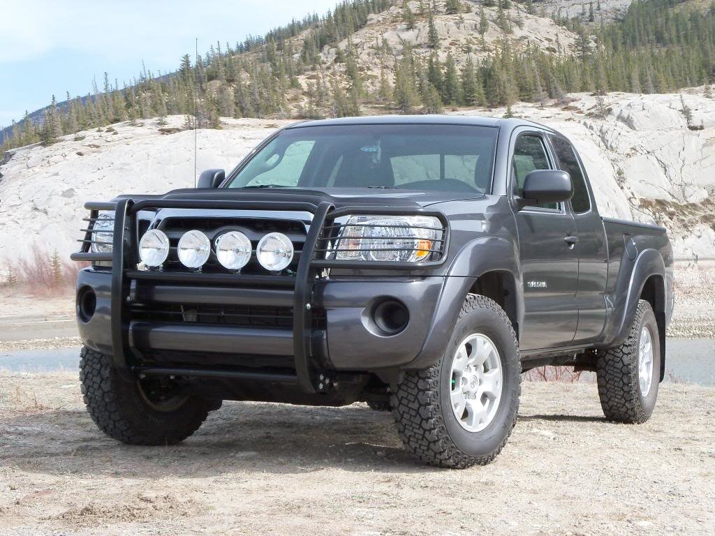

    Next up to bat was to install some lighting. I ended up getting an Aries grill guard and 2-sets of Hella 500F's. Both ended up being a bad call... the Hella's are made of glass and on winter roads with rocks flying always break, so I wouldn't advise. Also, the particular grill guard I got wasn't my first choice, but at the time was cheap and easy. It was flimsy and couldn't protect the truck in anyway shape or form if there was a wildlife impact... all it did was hold up lights...useless.

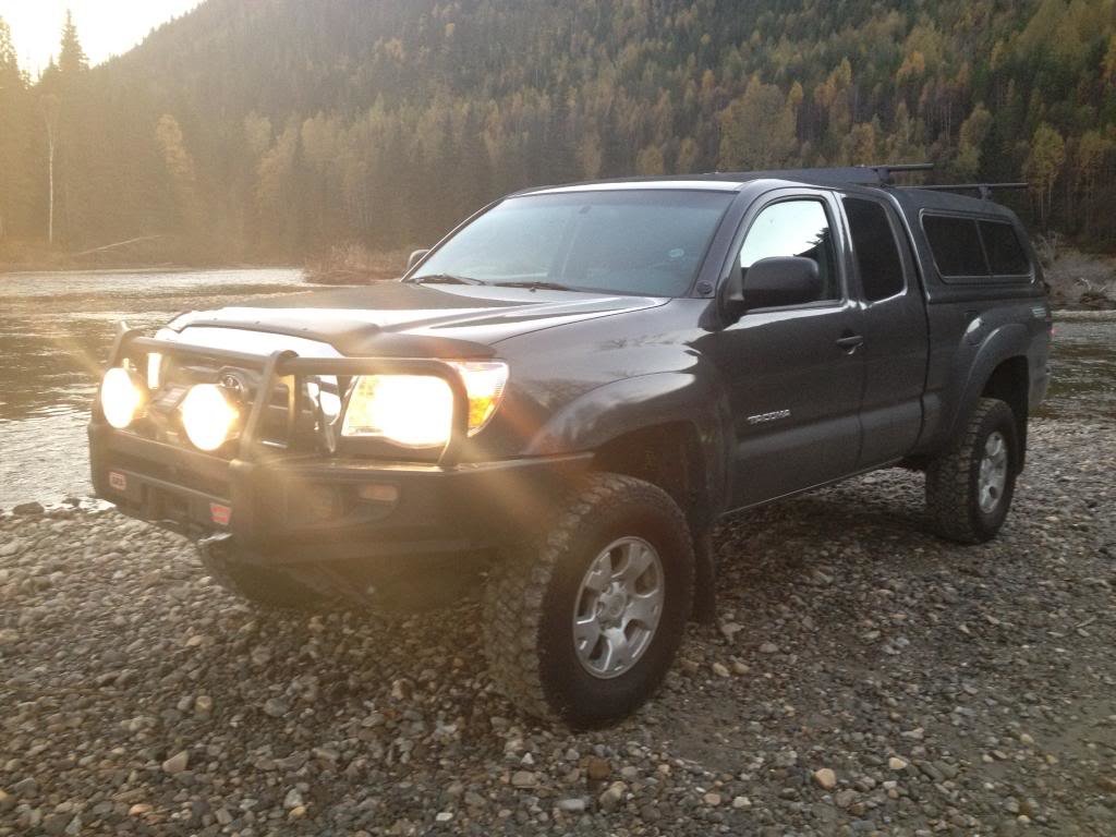

    After the first Canadian winter, I was on the market for a topper. Ended up going with a Raider (I thought and still do think it was the best bang for my buck). Along with the canopy came Yakima racks and a Thule (shortly lived).

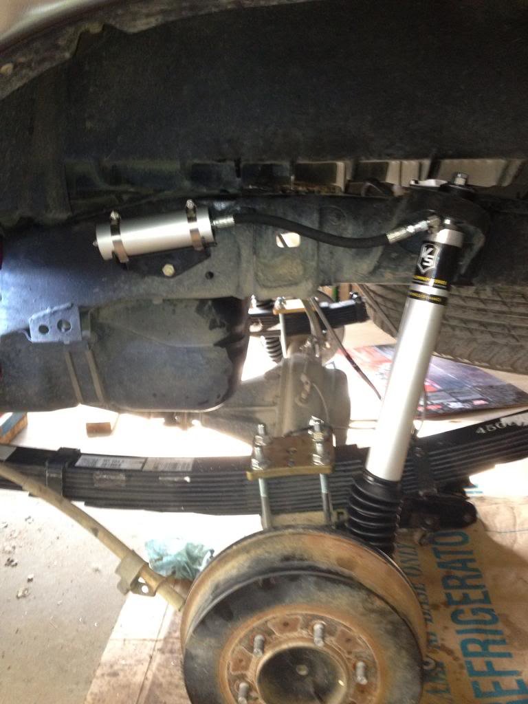

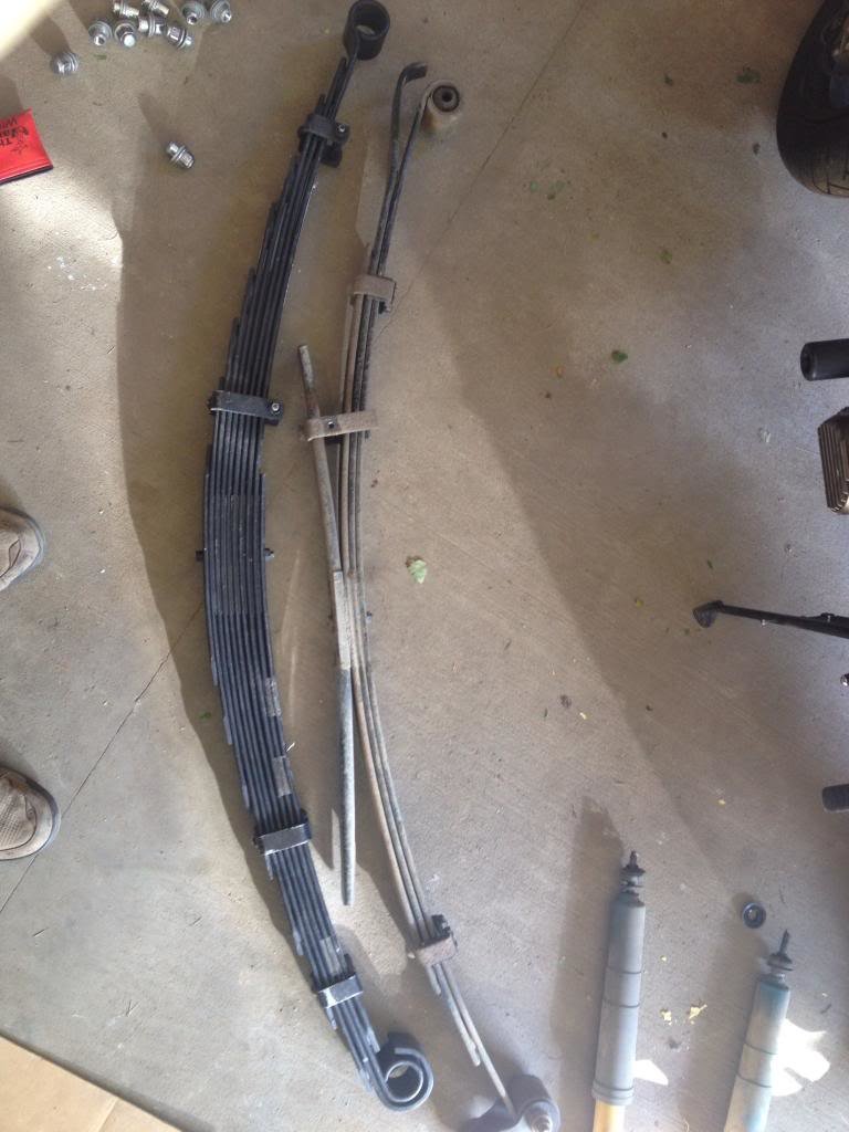

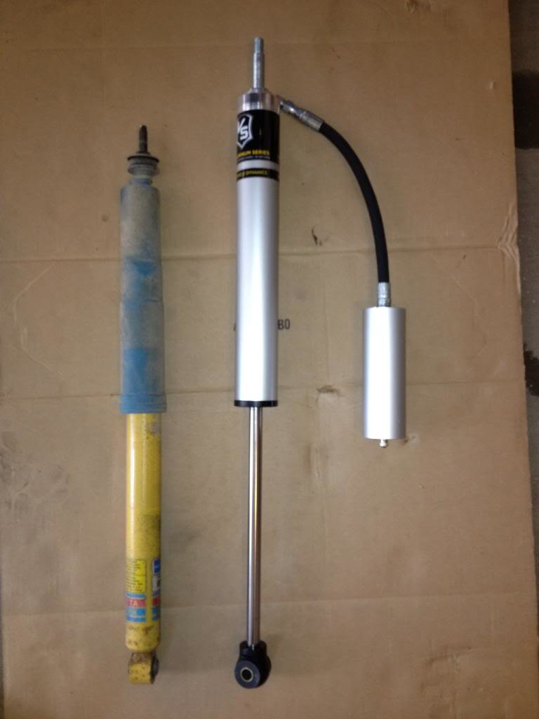

    Suspension time! No more pussy-footin around: ICONS front and back. Extended travel up front and RR 27" extended 2.0" shocks for the rear. Expedition leaf packs from All-Pro is what I went with to handle the excess weight I always carry around.
    Put a U-Bolt flip-kit on as well.

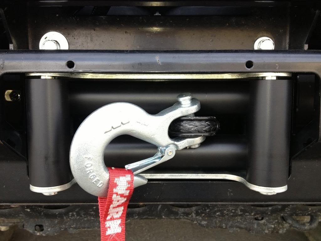

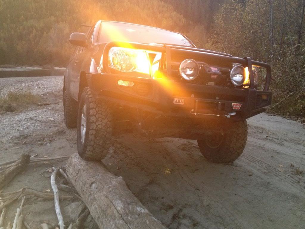

    Next came the M8000-s. Instead of using the Aluminum Hause it came with I bought a roller fairlead and fitted it with Derlin rollers (same dimensions as previous rollers, just made from industrial strength plastic). Reason why I did this was I heard it was a better quality fairlead to protect the synthetic line and also it increases the recovery angles since the fairlead sits back within the ARB bumper a significant ways.
    Anyways thats all for now. I'll upload some more off-roading pictures soon.

    Ride is unreal compared to stock- greatly improved. Only thing with the Expo Leafs is you gotta weigh her down in the back. I had probably ~300lbs in the back and it wasn't so smooth, once it snowed here I put another 150lbs of sandbags in the back, and once I did that the ride smoothed out perfectly.
    And driveline vibration, yes. Not bad though, but enough to notice. Usually around 60-70kmph it kicks in, nothing before or after. But again, very minimal.
