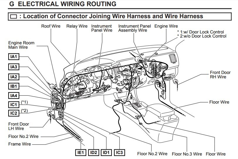

    See if you have power at IB1 Pin 8 (Red/BlacK) while cranking and check that the pin isn't burnt.
    If you have power you can disconnect the forward fuel line, hook a hose to the line coming from the frame, and run it in a container to see if fuel comes out while cranking.

    I have power on the red/black wire. Plugged the connector back in.
    Fuel didn't move a bit when I tried to start it.
    Is it time for a new fuel pump or is there any other testing I should do next?
