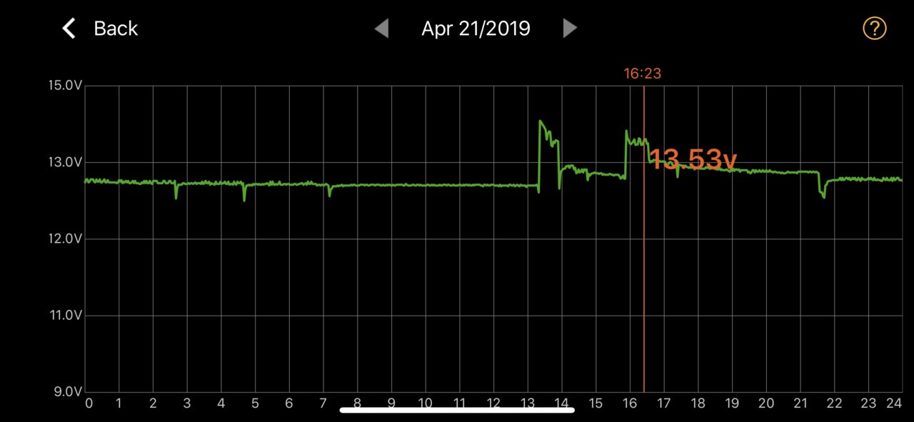

    Just for a little data to show how output changes over time, I did some voltage logging:
    So you can see that after starting the truck voltage will initially be higher to charge the batteries lost power before settling down to a more normalized output, but even then there are still fluctuations. Peak output in the above chart is 14.09v.
