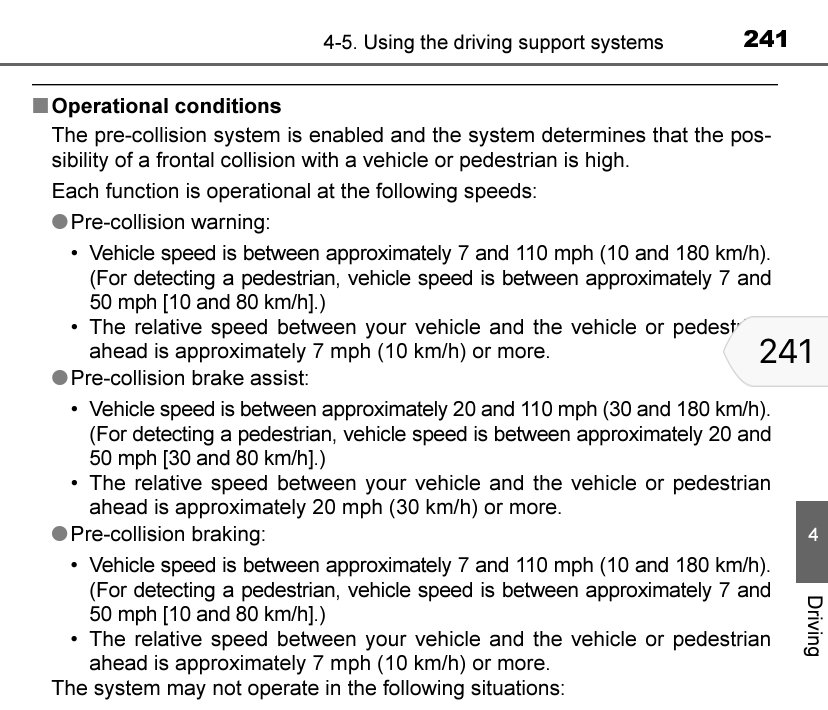

    I think there is a huge misconception as to how TSS actually works. Does anybody have actual evidence to support the claim that the tacoma will automatically apply the brakes if it detects and imminent collision without the user input and without the use of cruise control or adaptive cruise control? Youtube video with a cardboard box?
    I know that TSS-P is available in several other Toyota models which IS advertised to apply the brakes without user input, but as far as I know, Tacomas only have regular TSS (EDIT: TSS-C). (Or is my terminology incorrect? I mean to say that I only believe the sedans and minivans to be advertised as "automatic braking TSS" vehicles.)
    I'm only skeptical because
    a) I've never had my truck automatically apply the brakes outside of using adaptive cruise control.
    b) On several occasions, I have triggered TSS during my daily driving, but it only results in the audio-visual alerts including "BRAKE!" displayed on the dashboard.
    c) I've fallen asleep behind the wheel and hit a utility pole head on in my first tacoma without any interference from TSS.
    Nevermind, my sticker says TSS-P.
    And the TSS-P brochure confirms
    "If the driver does not brake in a set time and the system determines that the possibility of a frontal collision with another vehicle is likely, the system may automatically apply the brakes, reducing speed to help mitigate the impact or avoid the collision entirely if possible."
    https://www.toyota.com/content/ebrochure/CFA_TSS_P.pdf

    It's not a claim....read the post above with the photo from the owners manual describing operation of the PCS w/PD (pre-collision system with pedestrian detection). I've had mine warn me a couple times, but I'm always ready to brake so it doesn't have to for me. But it's there if you need it.
    The Tacoma (since 2018 MY) does have TSS-P. It's right in the owners manual and on the website. I believe TSS-C was an older system Toyota doesn't use anymore. Some newer Toyotas, such as the new Rav4, have TSS 2.0, which is basically TSS-P with some upgrades: Lane Tracing Assist - it'll actually steer you back into the lane when you drift, much like Subarus EyeSight system - the Tacoma doesn't have this because it still has hydraulically assisted steering, whereas most new crossovers/cars have electrically assisted steering; and FULL SPEED dynamic radar cruse control - meaning it'll bring you all the way to a stop when using the DRCC, as opposed to cutting off at 25 MPH like our Tacomas do.
