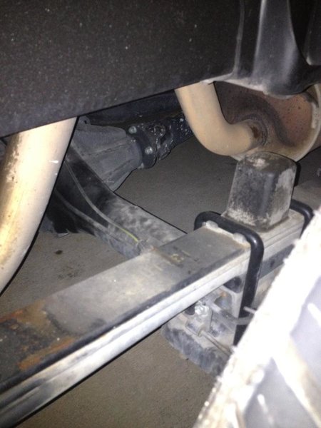

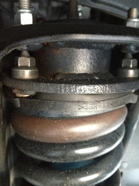

    You have a hockey puck aka a spacer. But I can't tell what that last picture is showing. :notsure:

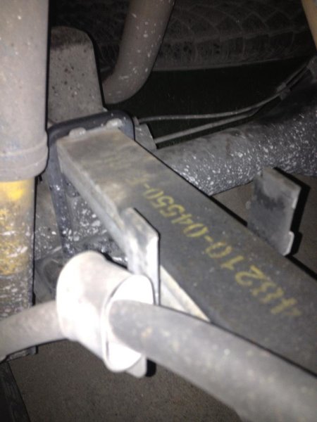

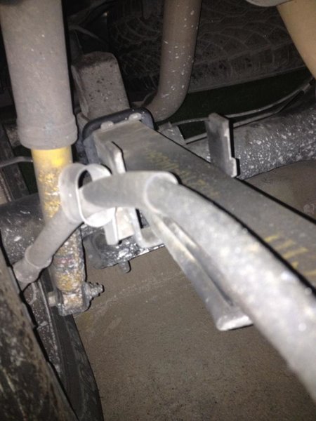

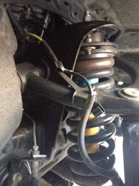

    Block.
    And your spacers up front are known as top plate spacers. They lead to ball joint damage at full droop. And the blocks in the back can cause axle wrap.

    What Keith said. You've got a small block in the rear. I would take that out and get real suspension ASAP
