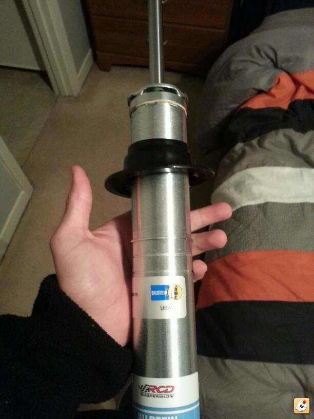

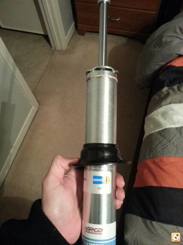

    Do 5100s come shipped set to 0" of lift? Here's a couple pics. I can freely slide the ring up to the top of the shock and back down to thr first ridge on the shock. ruquvaju_1faa19ebfee2f6d8d7244eb7aa310bfd73abb4db.jpguju7udam_35de93bb1b4f2b6acef9e05364bdd6ef22594311.jpg

    There should be s C clip that can be moved between 4 different places. 0, .85, 1.25, and 2.5.

    There are three positions I just don't know if the highest position of the lowest position is equal to zero inches

    Lowest is 0. The higher you move the base the more it will pre load and lift.

    So mine is set to the highest setting then?

    More clearly, "highest" means closest notch to the shaft, right?

    Looks that way.
