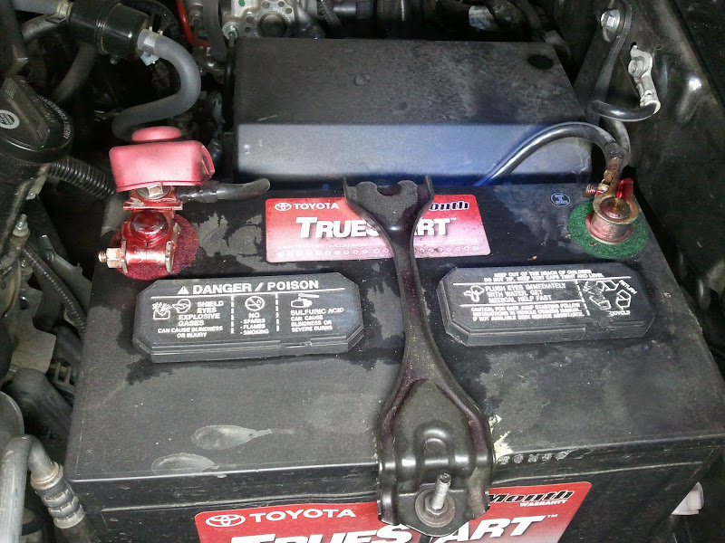

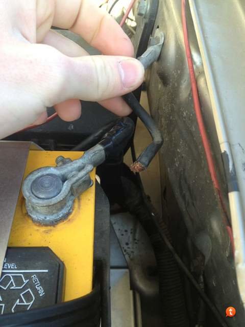

    When I changed my oil yesterday, I look and saw that my battery wasn't grounded to the frame. Could that be part of the issue? :notsure:

    Your ground should look like this:

    :notsure:
    It starts up perfectly fine, although a little slow because it's cold.
    So I need to get some better wire and reground it :eek:

    That might be an issue

    Hopefully that's my only issue.
    That probably happened during the ice storms when my battery tiedown broke loose and moved my battery into the oil filter :laugh:

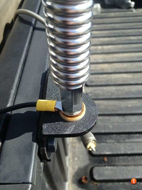

    So this is the order on my antenna if it matters.
    Antenna
    Spring
    Top half of connector
    Ground cable
    Lockwasher
    Plastic thingy
    Bedrail tiedown
    Back hall of connector.
    Coax.
    The back half of the connector goes through the attachment and the ground to the top half.

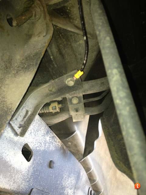

    This is where I grounded it. The bracket is welded to the frame.
    I'm still getting a constant 4 through all the channels. :pout:

    Dont ground it to the spring. Ground the actual mount. I would just go right to one of the mounting bolts for the mount.

    The mount should be grounded, not the actual antenna.

    So youre saying ground the black tiedown?
    What if it's power coated?
    What I did after work was swap the ground to in between the coax adapter and the bed rail mount on the bottom side of the mount.

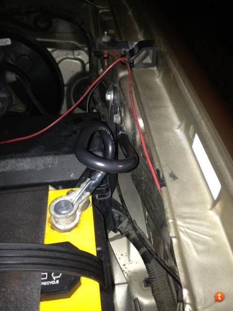

    I'll test it after I get my battery re grounded to the body.

    Got my battery re done. :woot:
