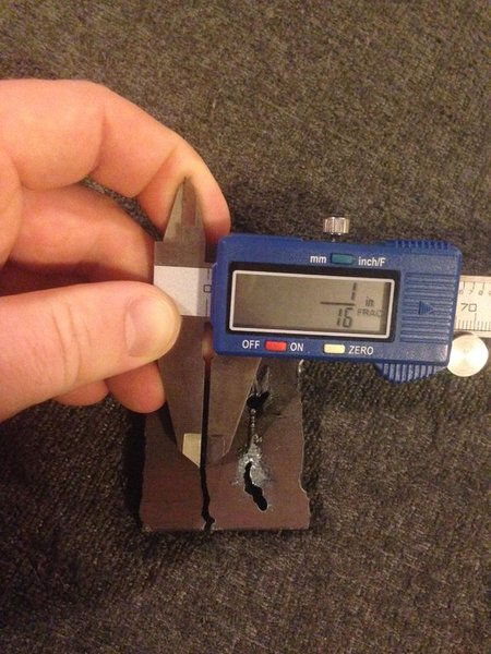

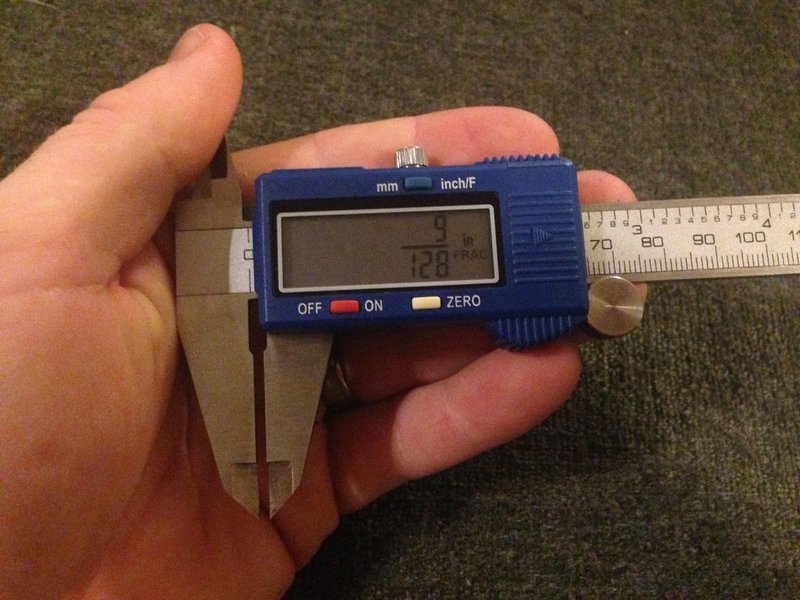

  16. Jan 6, 2016 at 9:21 AM
    colinb17
    colinb17 If at first you don't succeed, don't try skydiving
    Jan 6, 2008
    #4127
    20,142
    Colin
    Charleston, SC
    '07 TRD Sport 4x4
    Build thread in sig... 4-link long travel
    1/16'' cut width on the dot, for 1/4'' plate.
    these calipers go down to 1/128'' increments, so 1/16 is not a rounded number.
    Mobtown Offroad and SMKYTXN like this.
