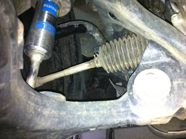

    Alright guys I just called him, and its leaking out of this boot (pic taken on my truck)
    That's called a steering rack boot right?

    Sounds like he blew a seal. Bad shit.

    That arm goes in and out of the boot. Under/behind the boot is the seal that keeps the fluid inside the rack and pinion setup. The boot has a tear or is leaking at the clamp. The fluid is coming from a seal giving way and letting the fluid by. Defintently not a side of the road fix.
