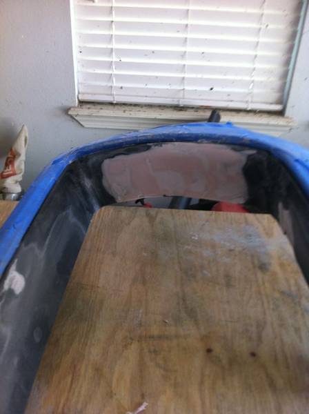

    . going to grab a coffee, then cut the excess fiberglass and put on the bondo. Sould have some more pics in an hour or so :thumbsup:
    Nope it's on the outside of the surround, that way I can flush up the inside with the bondo, using the fiberglass as a backer.

    First layer of bondo drying.

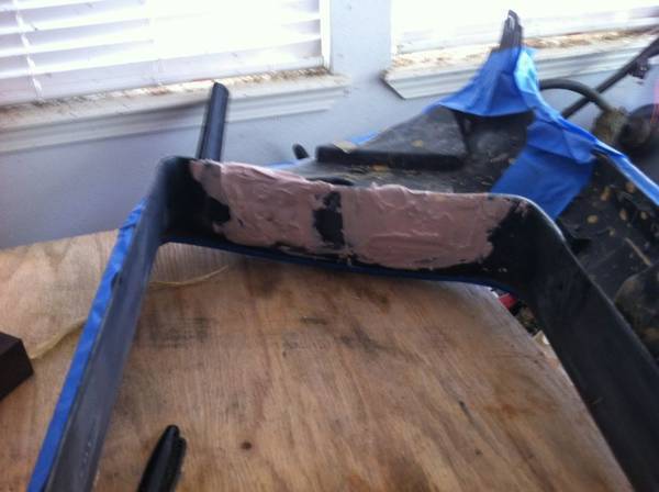

    I'd say I've put about an hour and half of work into it so far. Most of that was sanding the edge of the fiberglass so the grill will contour to it correctly,
    I'm definitely going to need at least 1, probably 2 more cycles of bondo/sanding to get it smooth enough to where you can't see the patch.

    Second coat of bondo drying right now.

    Bondo done!
    And first coat of primer on!
