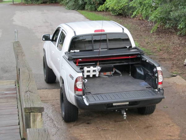

    Ha, here's an old one with a good view of the lake, pre-lift.
    And here I am at the boat ramp :cool:
    I work south of the loop in Tyler so I'm usually cruising 155 and Old Jacksonville.
    Not too many modded Tacos in town. Only 2 that I see around. Some guy with a speedway blue and 6-inch procomp lift who never waves to me, and a silver one with black rims and 3" toytec, which my friend used to own.
