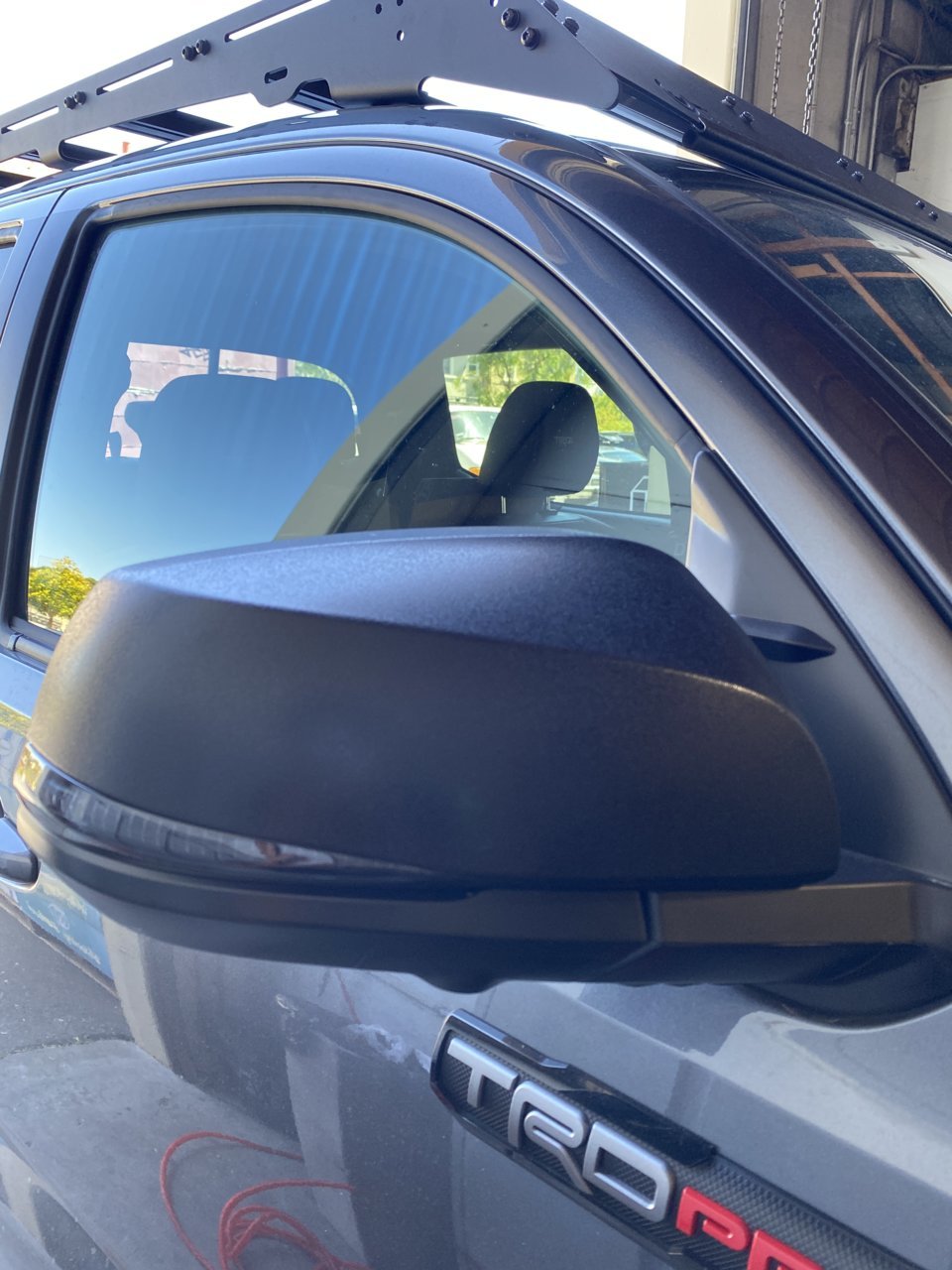

    Pretty easy upgrade for those that want that look of matching your side steps and roof rack. I bought aftermarket mirror cap replacements and shot them with black truck bed spray. All together, $65

    I’ve plasti dipped parts and rims on my other vehicles in the past and it’s nothing like this. Texture is the main thing. The other is, this won’t peel off like Plasti Dip.

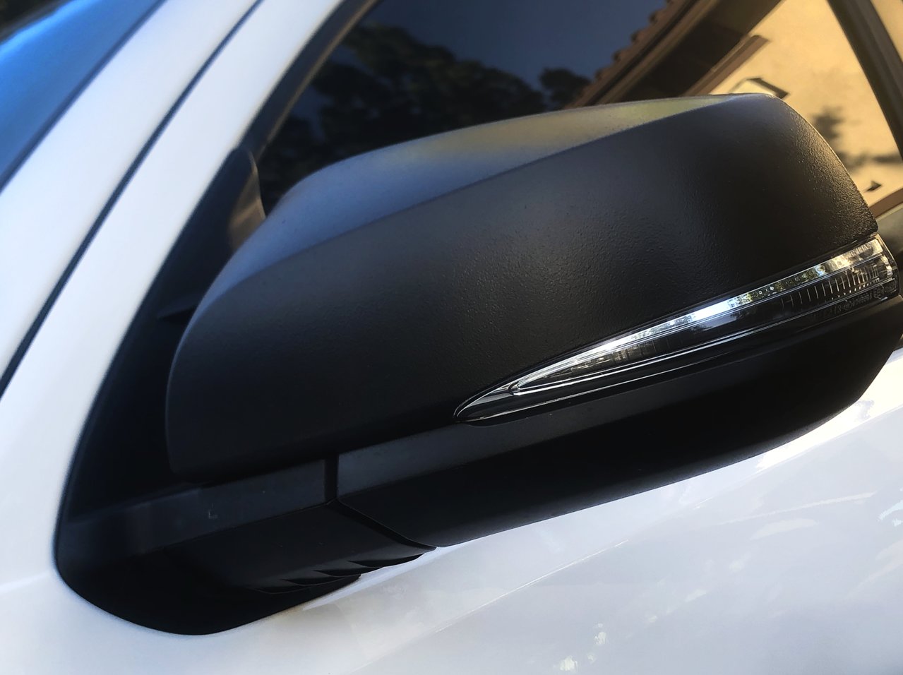

    Here are my plastidipped mirrors. It's all about application, works best with super light coats. I took my time and did this in 6 or 7 different passes with 10 min dry time between each. It matches the texture of the off-road fenders quite well! Not saying it's a replacement for paint or black textured plastic or bed liner, but its a conveniently cheap option and is reversible with extremely easy touch ups possible. Every product has their place, some have preferences for uses. All good fam, enjoy your Friday.
    side note, looking at my photo, man now that chrome signal housing is bugging me now.

    Post a pic in 2 years without any reapplication

    Just checking in, over a year later and Plastidipped mirrors look as good as the day I sprayed them with plenty of off-roading (dirt and sand) adventures and the accompanying washes.

    what liner did you use and where did you end up getting the caps from?
