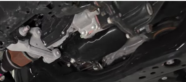

    The Pro/TH/Max have larger front differentials but is the new aluminum tailshaft (where the ADD is mounted) and the same ADD used on all of the models? The Las Vegas Pro demo ran the truck pretty hard and I assume the org that is doing the TH videos are working that truck pretty hard. A lot more Tq on those trucks and no problems so far.
