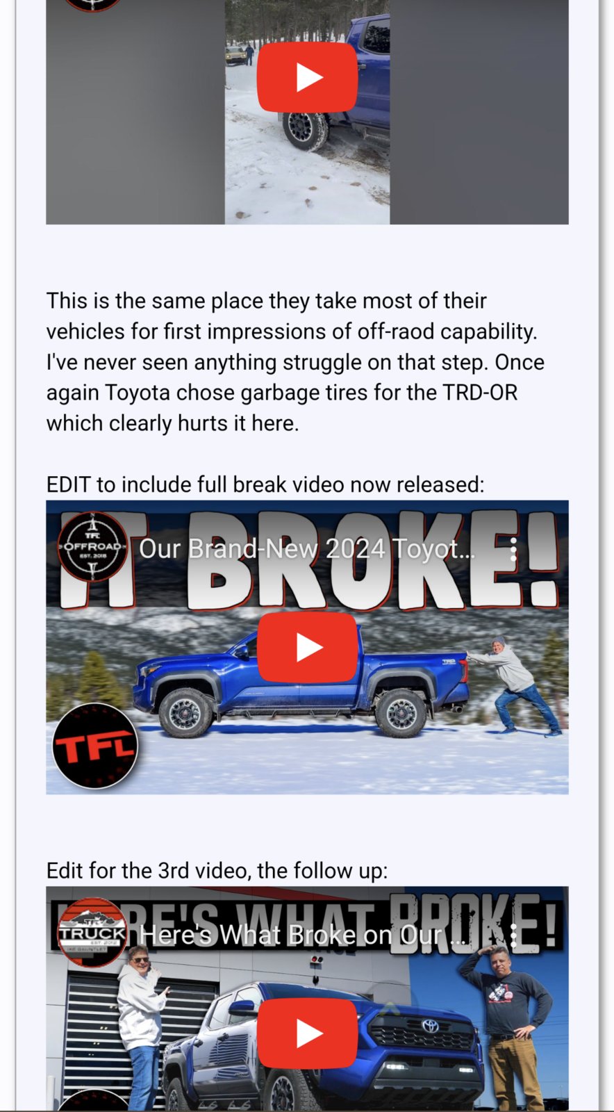

    See my previous statement. I didn't see that there was a part 3 and they found out it was the front diff.
    Personally, I would have never guessed a front differential or related parts would have broke so easily.
    I corrected my previous statement to acknowledge what they found.

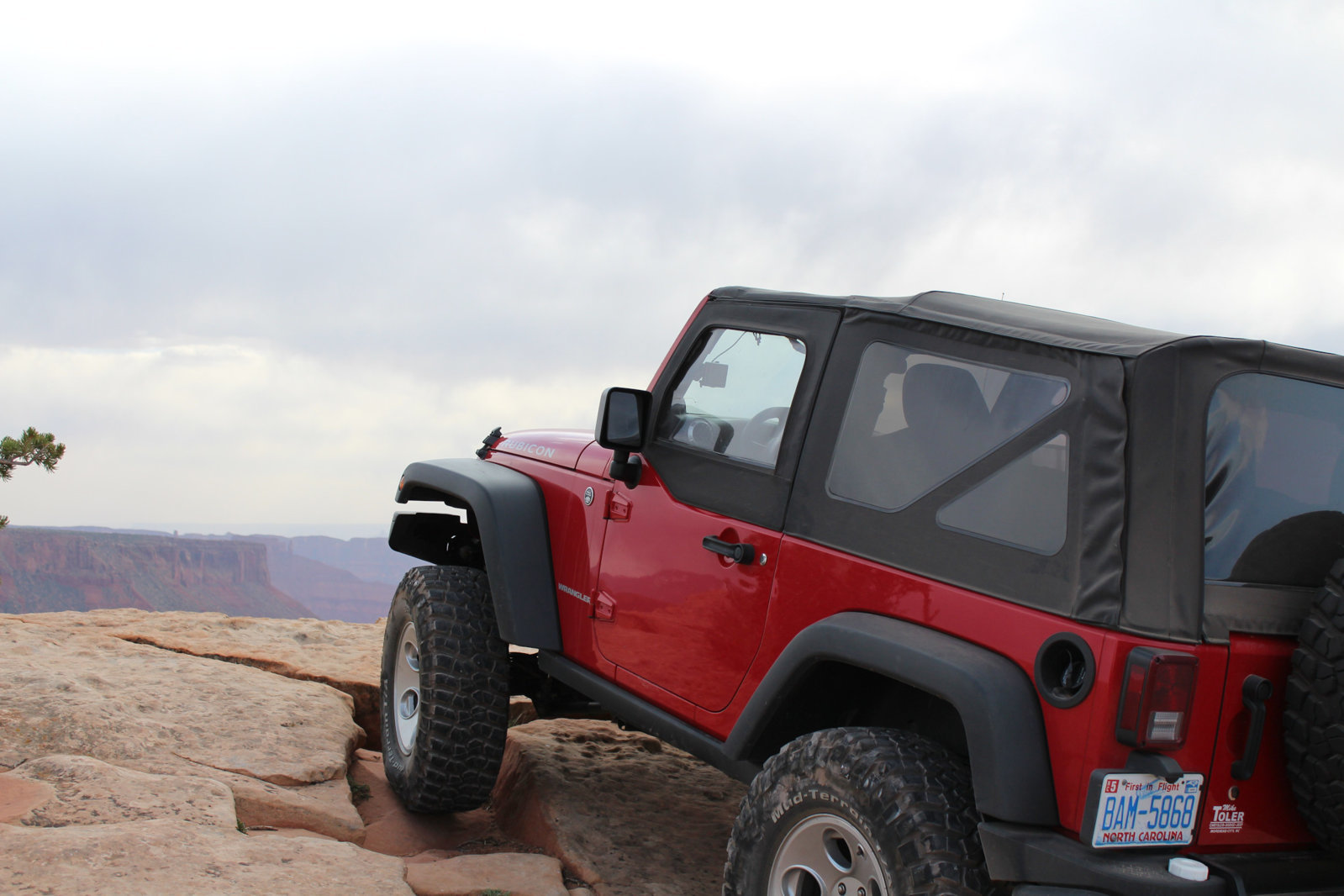

    I had a 2012 Rubicon, 2 door. The 3.6 is gutless, but if you know what to watch out for with the roller bearings in the rocker arms, it's a known quantity and easy enough to fix before it eats a cam lobe. Basically limit idling and change oil way more often than the book tells you to. A swaybar is easy enough to work around and won't end a day our four wheeling too. Just unbolt the end links and off you go. Did Moab with that Jeep, was fun.
    AP1GczNQoxQ2DJ-DGpO1ge5T4wX-b-_-JVXE50qQ_861d968914d8b47247448f91dcca08e71cc687e8.jpg
    The FAD on the JL is part of why I was worried enough to not get a JL when I sold the JK, seen a lot of posts where people were bombing around and pulled the FAD tube out of the main axle tube. But I guess it's better a failure when you're driving like a goober vs driving up a mildly slick pebble.
    Started talking with a dealership about finding one. Not bought one yet, thankfully. Might go back to Jeep, at least their FAD works. Broncos are too ugly.

    Yes, yes I did. You said you only saw two videos.....there were three posted after he edited the original post. I shared the 3rd one which you said you didn't see.
