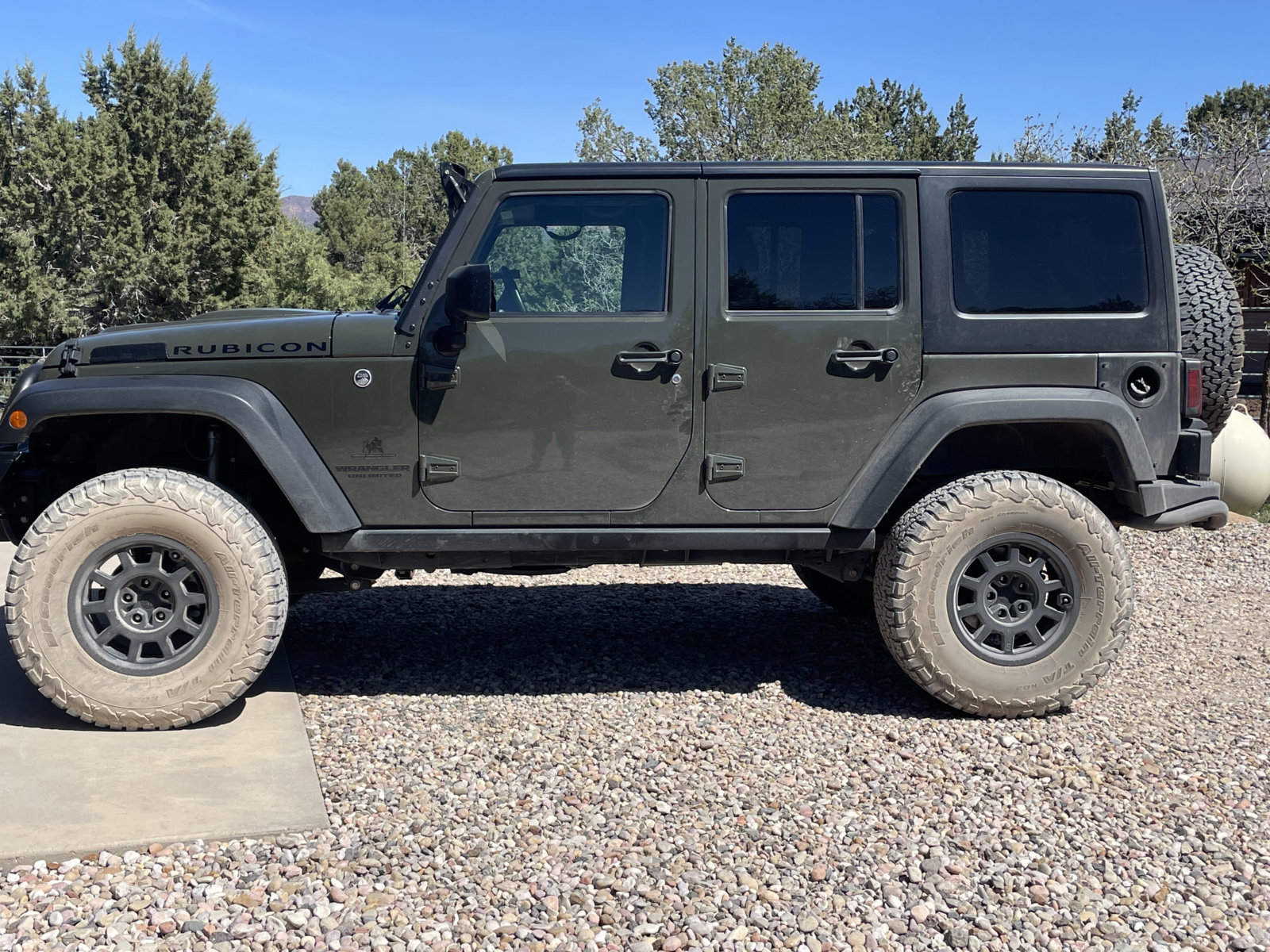

    That truck would have received an LS3 and a nice FO to Toyota.

    Those JKs were such piles. Never seen many owners have much luck with them.
