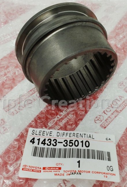

    This is an ADD sleeve. If it failed, you won't have 4wd (front). Not sure if it can be installed incorrectly, there are no shims or adjustment. Not sure you can install the ADD actuator incorrectly either. A bad actuator with a faulty engagement switch that thought the sleeve was fully engaged but only had partial engagement? that would probably mess up the sleeve or shaft splines causing a failure.

    This is exactly what I was thinking. If that sleeve wasn't fully engaged, it could easily break.

    Interesting!
    I wonder what the part actually looks like after some usage outside of any failure.
    It seems like you could shave off a couple of the inner grooves and it would still engage, although bits of metal floating around are potentially problematic. I would not think that would cause a singular popping noise. Maybe it "popped" out of position? Like you said, "not sure it can be installed incorrectly". Not a mechanic just curious. (Mechanic terminology question, Is that inner protruding groove, "toothed crown" (?) called the "corona" when it is inside a gear piece?).

    It would just be called “splines”

    Both front wheels wouldn't spin when the indicator showed 4hi engagement. A manufacturing defect in that like a hairline crack would cause such a failure.
