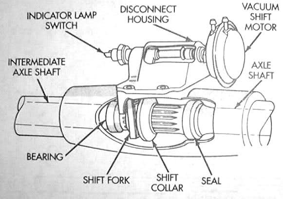

    Not sure where the "designed to fail/weak link" talk came from. The Toyota ADD works just like Ford, Jeep, and Chevy. A fork moves a sleeve/collar. The only real differences are how the fork is actuated; manual, electric, or vacuum. Jeep and GM shown below.

    Synergy the shift collar is the weak link

    It came from toyota via a third party.
