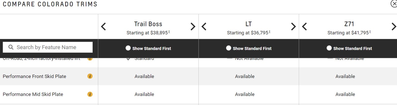

    Steel skid plates are always an option/premium.

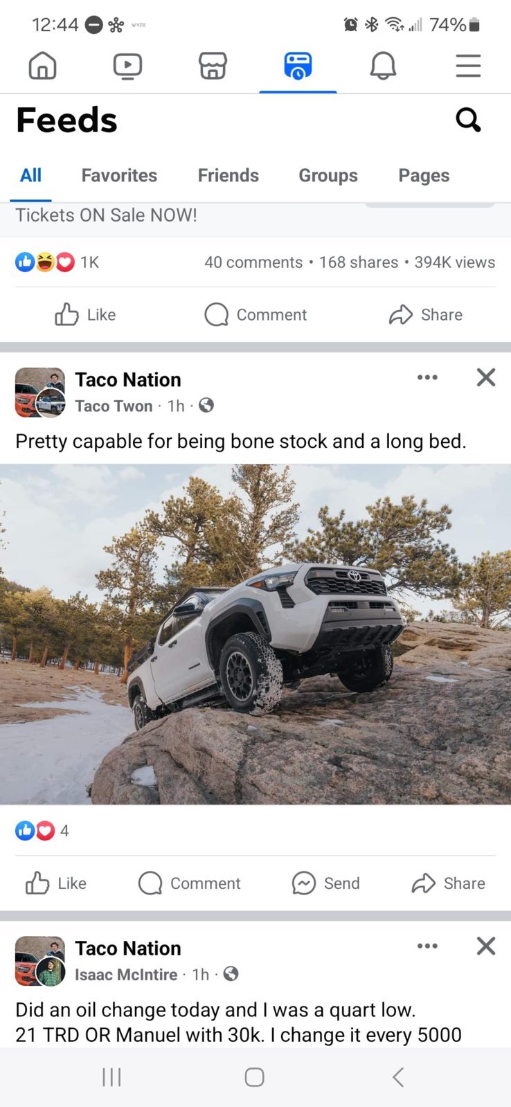

    This one did not seem to have a problem.
