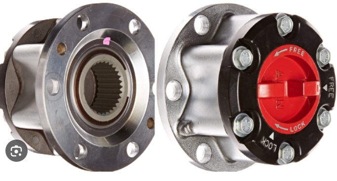

    On my other request, we have seen a new part, along with some additional non-Toyota examples. (Very much appreciated). Does a Toyota tech out there care to share a picture of this part that has normal wear and tear on it?

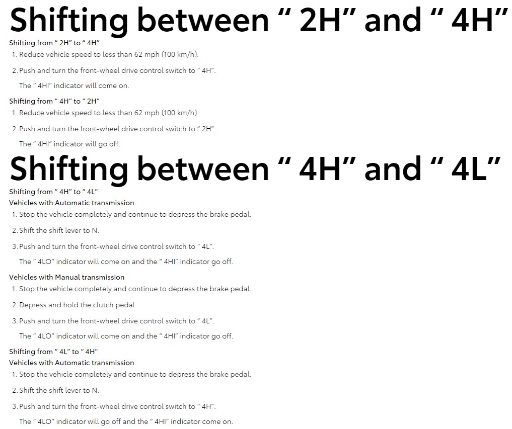

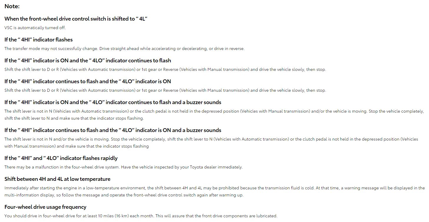

    It’s been discussed about 20 times in this thread already. He was already in 4lo for a long time before the part broke. You also need to be stopped and in neutral to go into 4lo. 4hi can be engaged while stopped or moving. Have you ever actually used 4WD in your truck?
