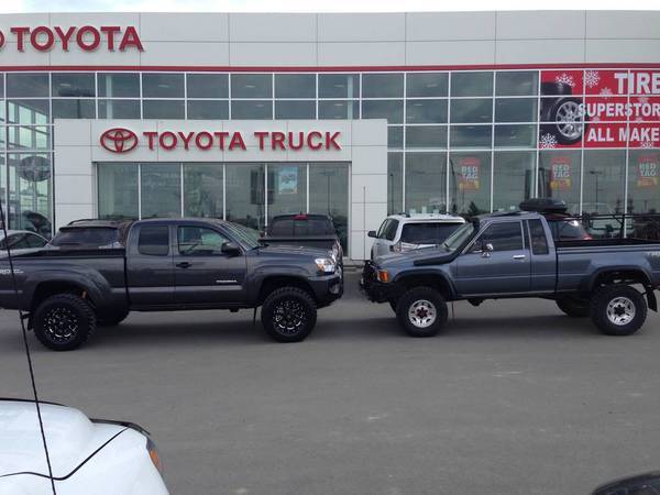

    Here is pickup the new pickup day:
    A pic of her and our 1987 which we have loved for longer than I remember...

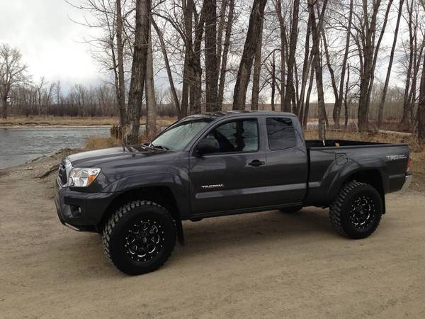

    The first drive 04/24/2013, took her down to the Bow River for a photo shoot:

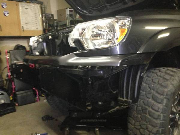

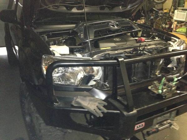

    So over the last few days I have been working at installing my ARB bumper on the rig, very straight forward install, thanks to the expedition portal write up (a search on this site will reveal a bunch of info)... I do have to comment on the "mess'O'bolts" that ARB just slapped into a bag and called it good. This was by far the most time consuming and biggest PITA about this install. But I digress... on to the photos!

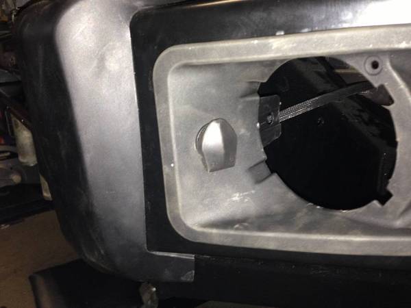

    Not much to really add to the topic other than mine being a Canadian gurl, she has a block heater plug port on the factory bumper. It's rather unique as it's just a port they drilled into the factory bumper and they give you a heater cord that plugs into the port then into your standard 110 socket. In order to get it out of the bumper one must unplug from the block, feed it all the way back thru the bumper and reverse into the new bumper after finding a place to put it. Mine I decided to put it into the new ARB fog/signal light valence.
    Aside from that I also have to comment about cutting the OEM bumper skin... Piece of cake and does make the installed bumper look that much more proper IMO... a nice jig-saw and fine blade and you don't even have to de-burr the cut!
    Aside from all that not a terrible install at all... now to figure out what lights to spend moar $$$ on...!
