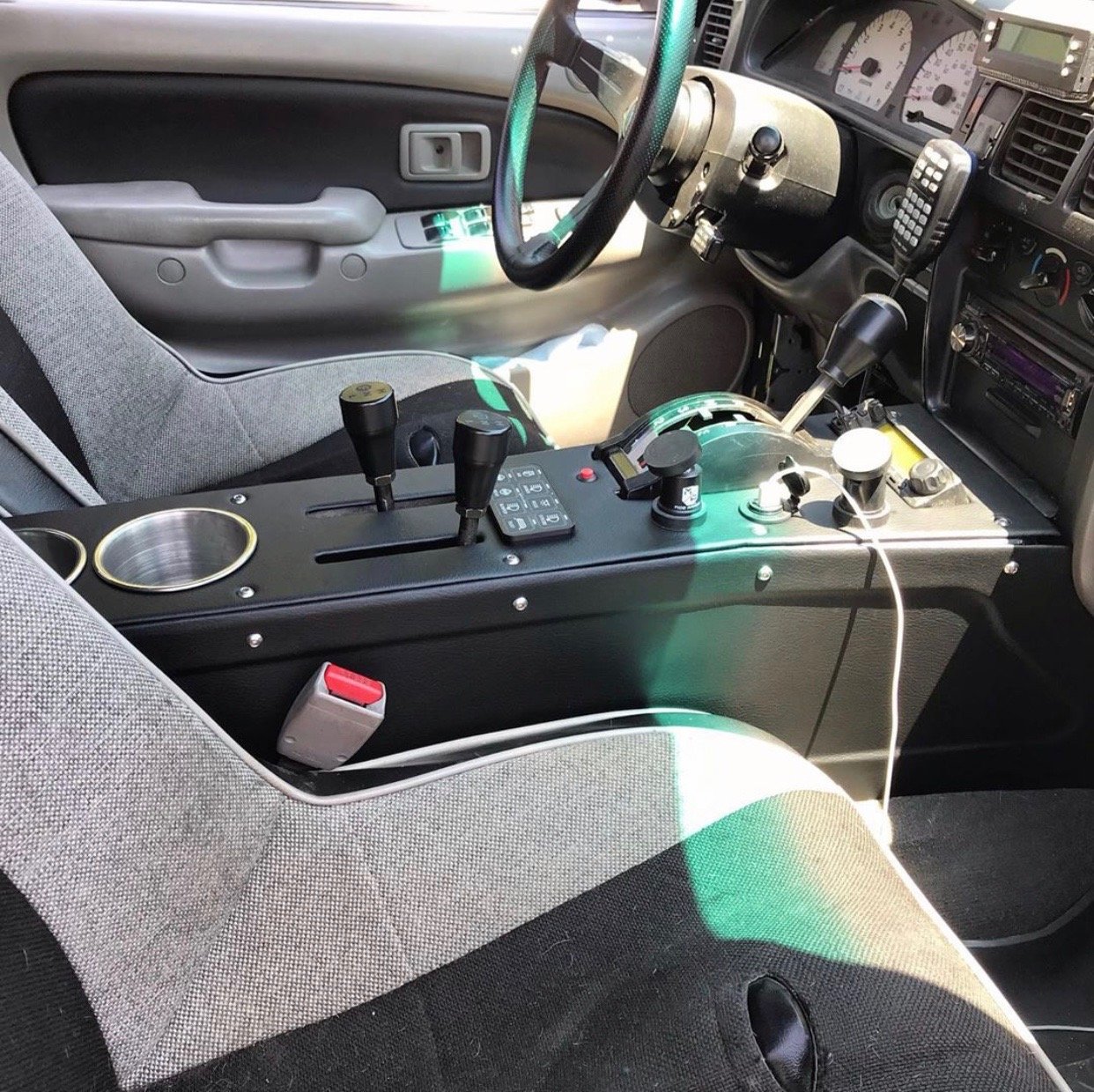

  14. Jan 27, 2024 at 11:45 PM
    #54
    Tof-Corey
    Tof-Corey Well-Known Member
    Jan 17, 2019
    #279655
    138
    Concord. CA
    2004 silver double cab
    KPD60/14B rear
    do you have any more details on this console!? it’s beautiful and I’d like to replicate it
  15. Jan 29, 2024 at 9:12 PM
    #55
    thegame
    thegame Well-Known Member
    Mar 11, 2011
    #52855
    1,658
    Brian
    Folsom, CA
    Cement 2019 TRD OR
    Not really anymore. Truck has been sold but its all 1/2" HREW steel tubing and 16 gauge aluminum panels wrapped in vinyl
