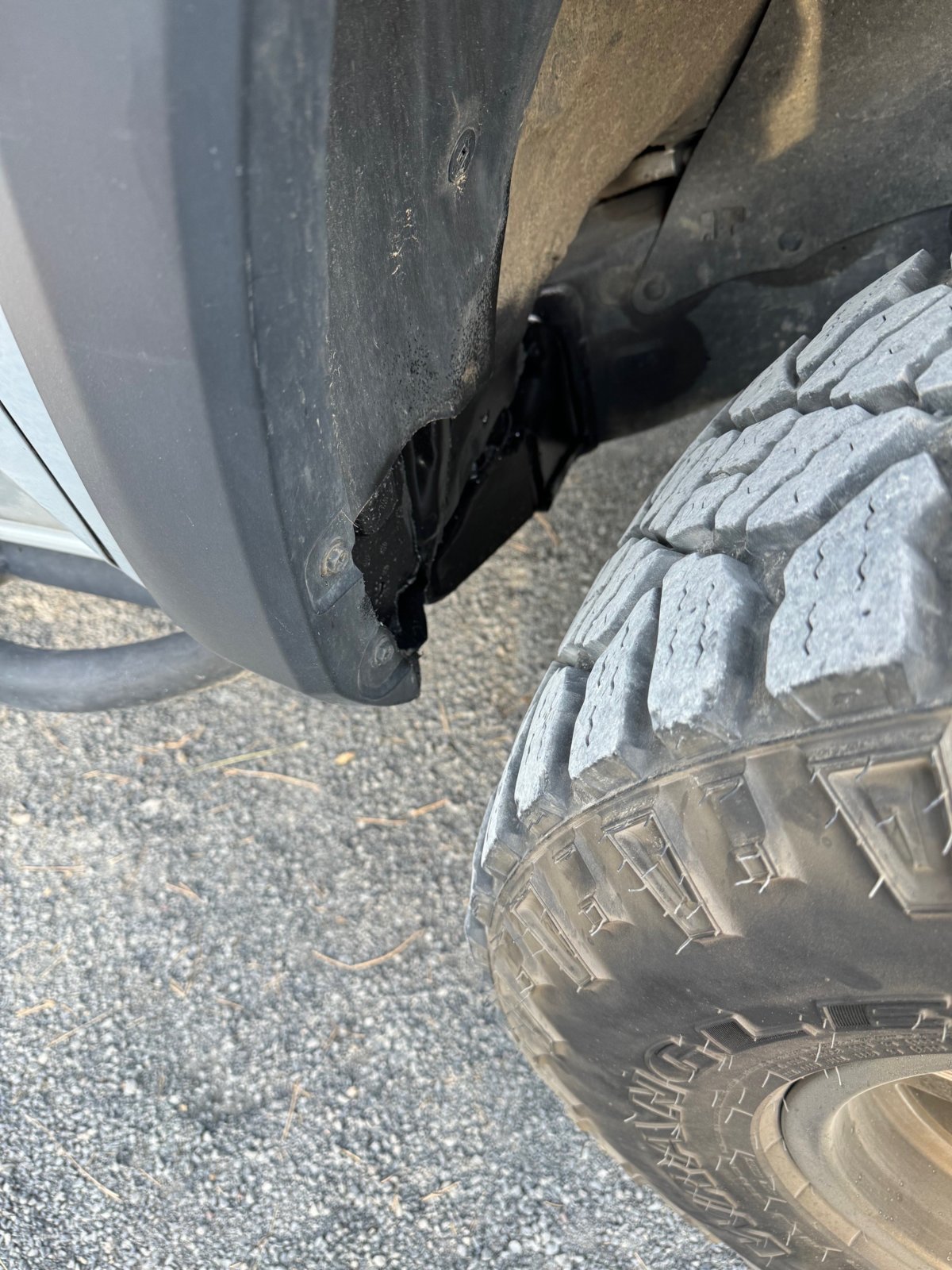

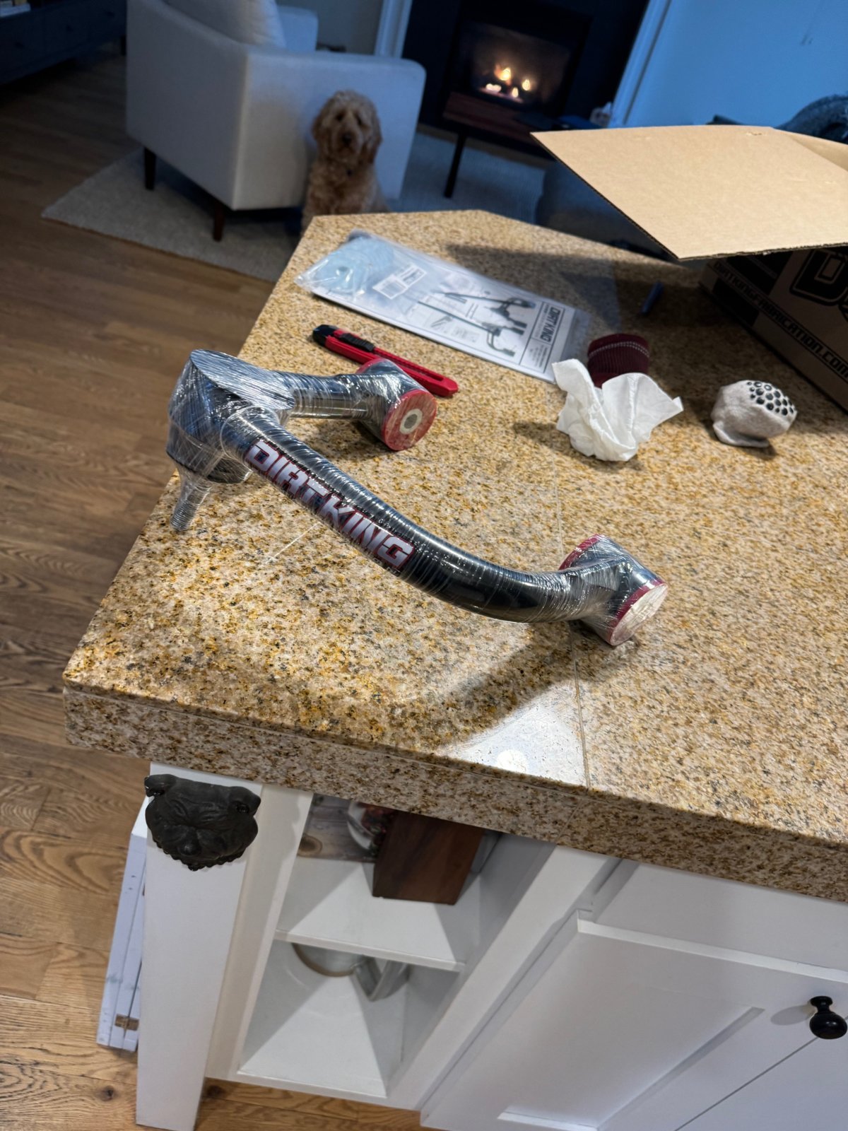

    Some of you may know, some may not. I've had some issues with my SPC control arms. The x-axis bushings and both ball joints were shot after the 18K miles I've put on the the truck in the last 2 years. I had tons of clunking, play, and steering slop. Thankfully, SPC agreed to warranty the whole unit. They covered shipping, most of the labor too. Very nice of them. After digging into the ball joint/x-axis issue further, I found that this seemed to be a known issue. QC at SPC is pretty bad. arms are out of alignment, the x-axis bushings are not "lifetime" at all, and the ball joints clearly don't last. I also found that they haven't updated the x-axis joint design, only the ball joint in the last 2 years. So I came to the conclusion that I was going to be replacing my defective parts with more likely defective parts.
    I started looking at other options. I wanted to go with a tubular design with a ball joint as its still my daily driver. My options were JBA, Bilstein, Dobinsons, Icon, Camburg, or Dirk King. I settled on Dirt King for a few reasons:
    Price- there was a sale going on and I scooped em for $590+shipping.
    Build quality- these things are beefy and light. The poly bushings will need a bit more maintenance than the X-axis bushings, but should last a whole lot longer and their easy to replace. Same with the MOOG HD ball joint.
    Off road pedigree- Dirt King makes great products and builds badass and top notch pre-runners and desert trucks, google it.
    Reviews- Not tons of reviews online, but all of them were positive. nothing negative where SPC is completely the opposite-lots of reviews, mostly negative.

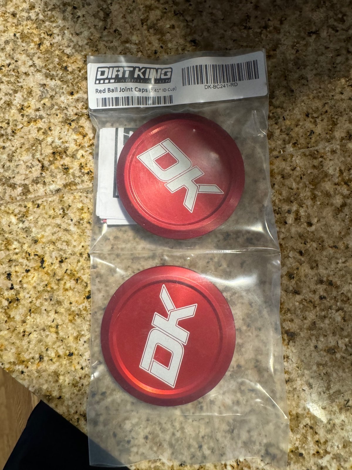

    @memario1214 told me to be bold so I optioned them with red caps and they showed up about a week after I placed the order
    I got them installed on presidents day and everything went in well. The truck aligned easy, MUCH easier than the SPCs did.
    They went in and holy cow the truck drives night and day better. There are no noises in the front end. There's no slop in the steering, its direct and tight. The front end feels noticeably stiffer. A night and day improvement! There is however, one major negative. RUBBING. I am on a -10 offset wheel and I am on the cab mount. The secret sauce with the SPCs is the ability to move the tires forward in the wheel wells with the alignment. Now that I have lost the adjustability, my tires are farther back, touching the inner fender and cab mount. I am going to need a cab mount chop in the not too distant future. I do plan to upsize my tires at some point and the CMC will have to be done first.

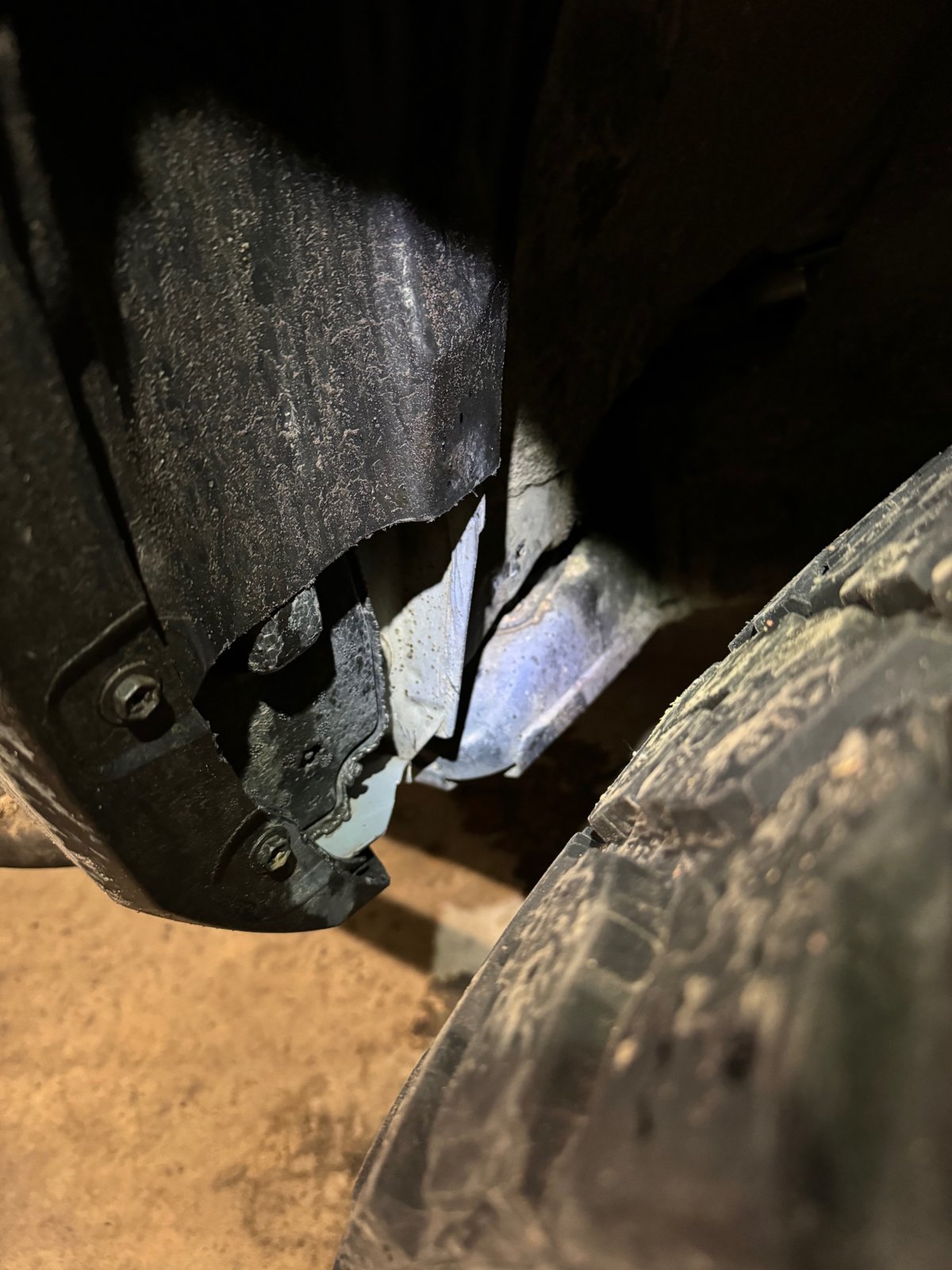

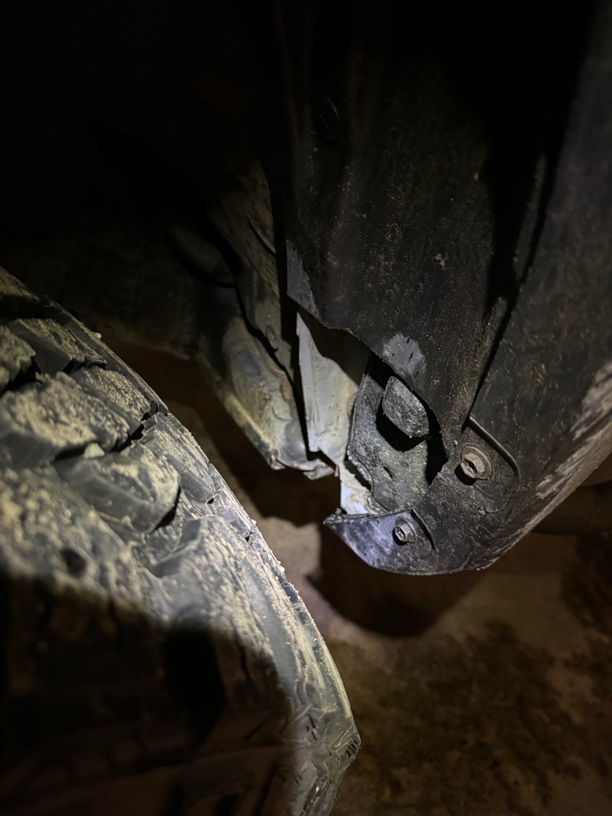

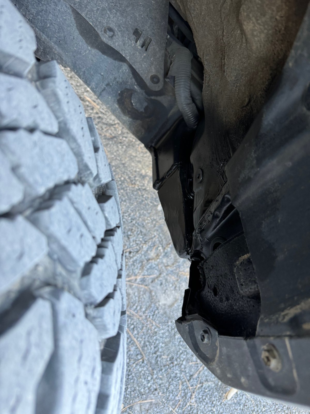

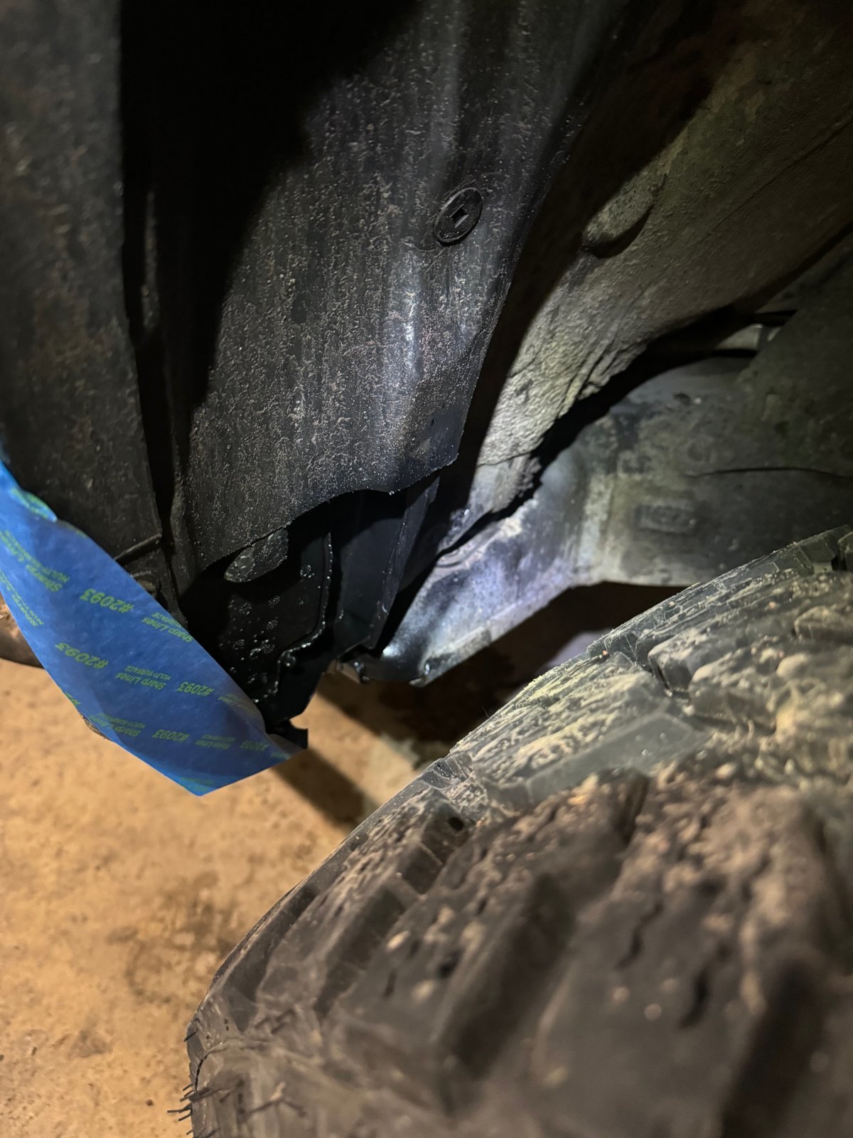

    I spent quite a bit of time on Wednesday evening trimming, grinding, cleaning and painting my inner fender to prevent rubbing and get my steering back. Driving to work on Tuesday I had 1 full turn of the wheel before I was hitting the plastic. It was borderline undriveable. Now I have full steering range again at ride height, but backing up and hitting bumps I touching the cab mount.
    Anyway, I think I did a pretty good job cutting my pinch weld, fender seam, inner fender and plastic fender trim. I used my Dremel and cleaned up the edges with a knife then filed the ground edges smooth. I used some brake clean to get the mud, dirt, and metal and plastic shavings out and let it dry for a few hours before I came back and taped a few areas then sprayed some rattle can bed liner on the metal.

    I would recommend pulling the coilover and cycling the suspension to full bump lock to lock to check for clearance. You'll likely have to cut more.
    4xThad[OP] likes this.

    Oh I'm definitely going to have to cut more. Good idea to pull the coilover though and cycle the suspension to make sure I have all the clearance. Im gonna worry about it once I get the cab mount cut. I just quickly did this in an hour so that it was drivable.

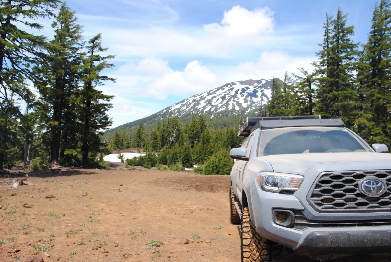

    If you've been following along, you probably know that I couldn't turn most of this winter. It was starting to get annoying. Pulling into parking lots/spots, into my garage wasn't even a 3 point turn-it was 4-5 points. I could barely make it around a round about without rubbing. I was going to dinner with Sadie and I couldn't pull into the parking lot. I had enough and I could tell she was losing patience with me. A little bit of plastic rub isn't bad. But hitting the cab mount got old. I got it in quick for an aggressive CMC 2 or 3 days later and they did a pretty good job. You can obviously tell its cut and the pinch weld it cut back and the did a little more fender trimming. I wanted clearance for a 295/70 and that's what I got. I can steer again, I have inches more clearance back there so I would say that the couple hundred bucks was definitely worth it!
    Later that week we packed up and headed for the coast. Weather was unreal. Sunny and 68 on a Saturday in march was more than we could have asked for. took the dog to the beach. cruised around. went for 2 good hikes. We had a great campsite at a state park that will remain nameless-we will be back.

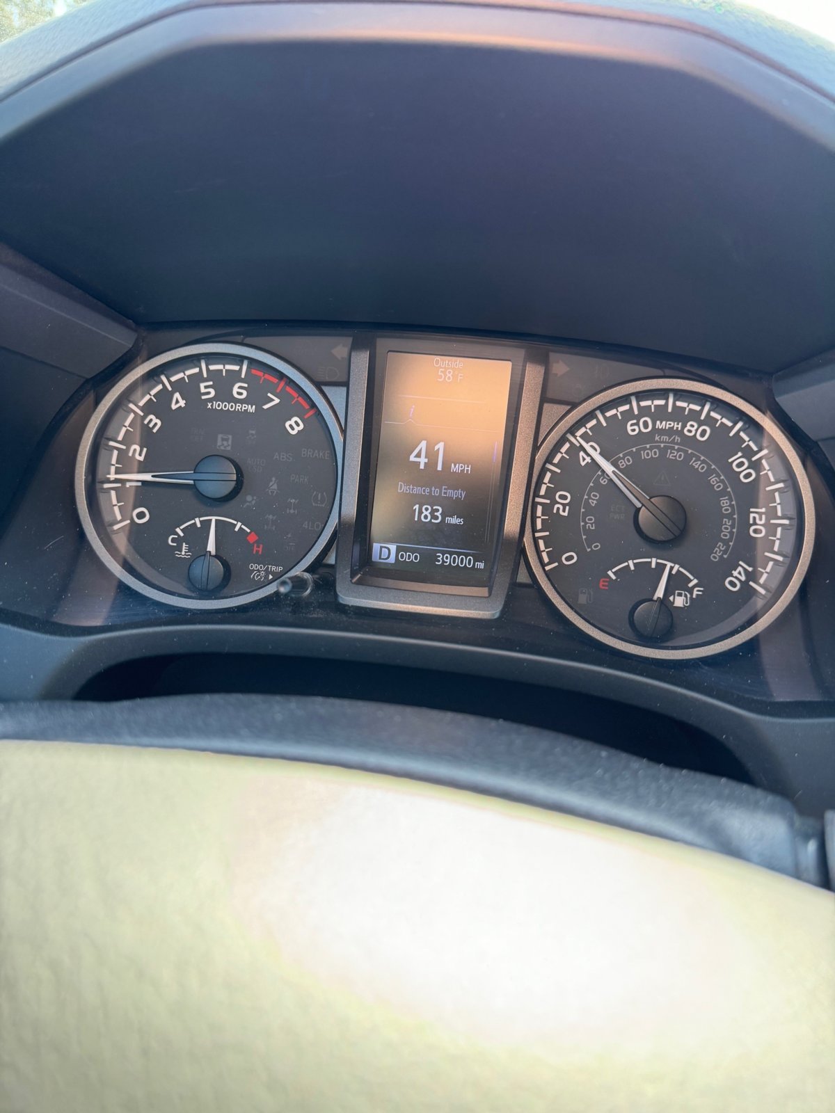

    The truck also rolled 39,000 miles on the way home. Im only putting 10k a year on it. It was on our last coast trip in May 2023 that I rolled 30,000 miles. We had a good 2-night trip, need to get out more and do more trips like that. We had a lot of fun.

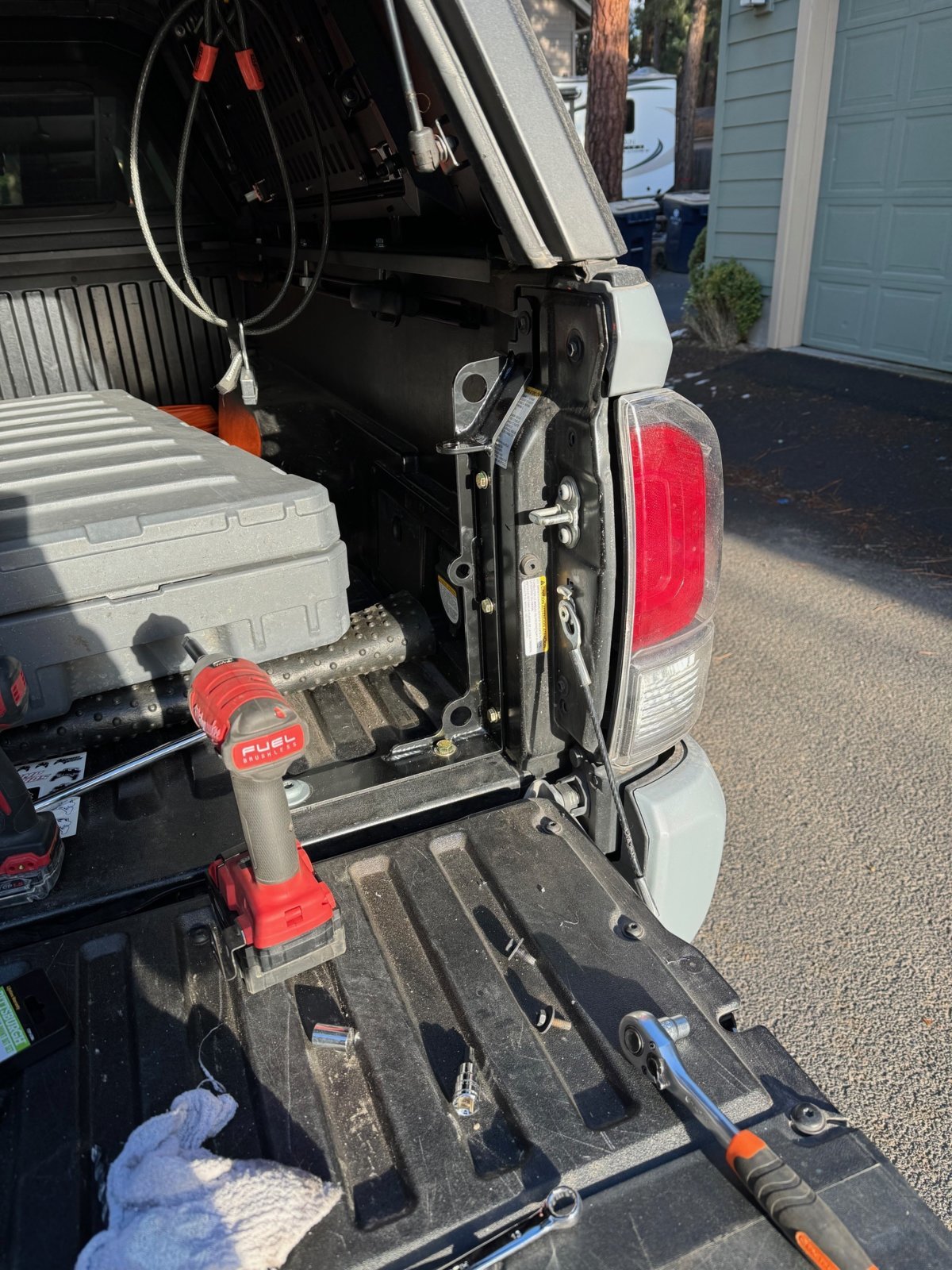

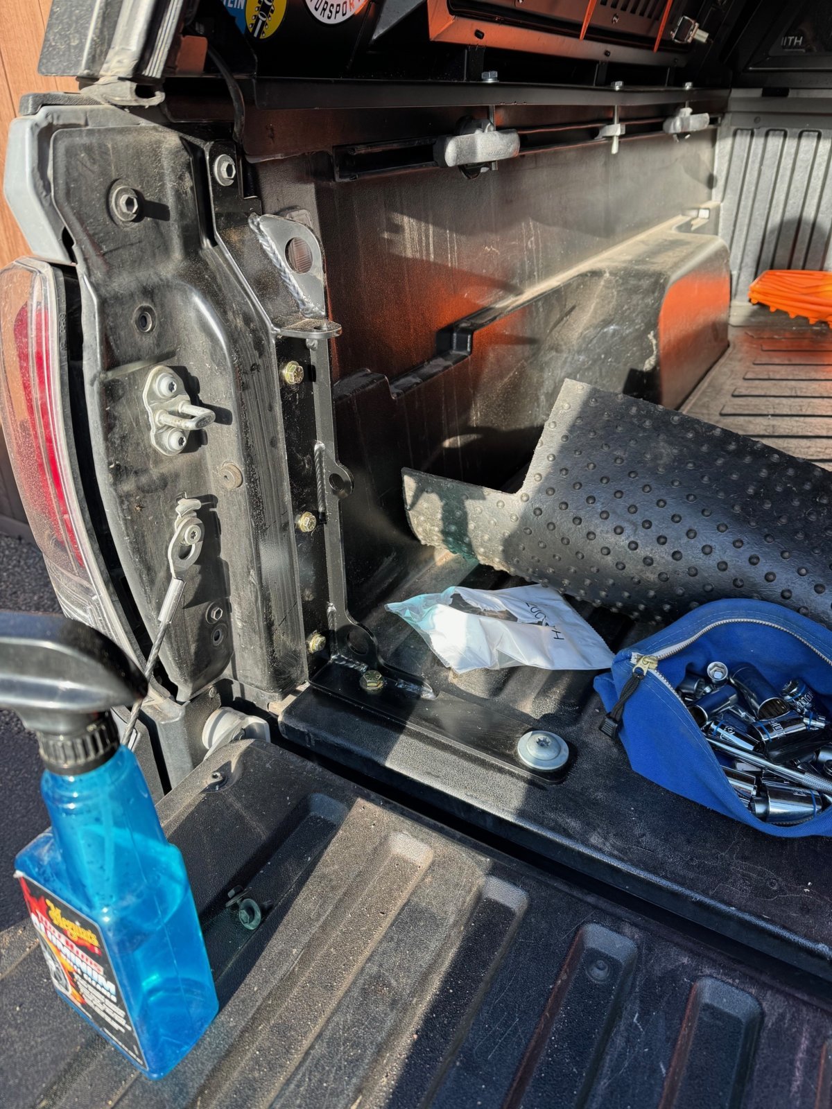

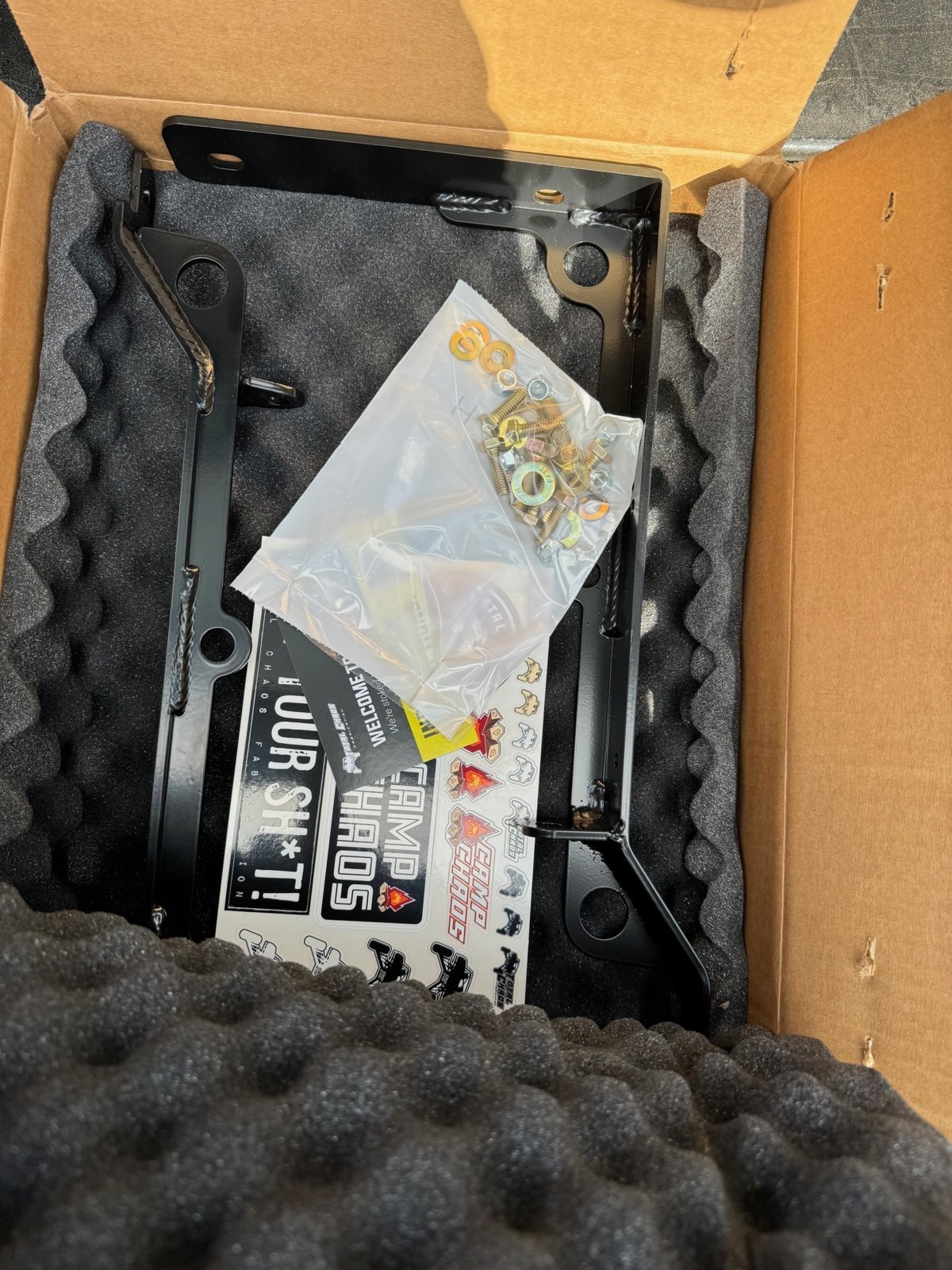

    I decided to get some bed stiffeners. I had noticed that the panel gaps between the tailgate and bed have gotten progressively larger over the last few years. I know I have a lot of weight over the bed rails between the topper, tent, us when we're sleeping so I decided that it would be a good idea to stiffen the bed. I went with Total Chaos stiffeners because they were the lowest profile of any other manufacturer and I got em on sale from runnin4tacos. it was like $150 shipped which was comparable to RCI, etc but these less obtrusive in the bed. pretty simple install. set the base bolts, then drill the bedsides in the proper locations then thread the provided hardware in and tighten everything down. The bed mat still fits nicely over them
    Last few weekends have been pretty busy with travel and activties. Sadie was in Seattle, I was doing house work and getting those railroad ties out of my side yard. Sadie ran a marathon, sick. Hopefully getting out for some camp nights in May!

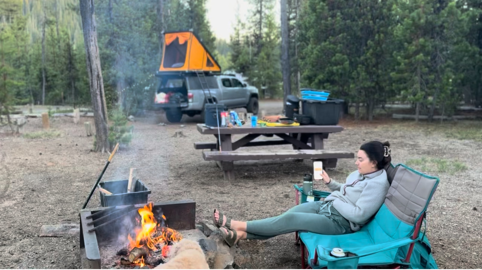

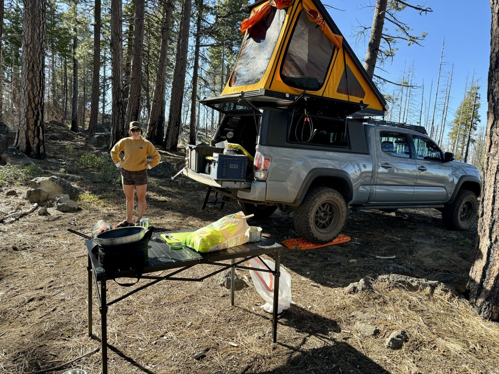

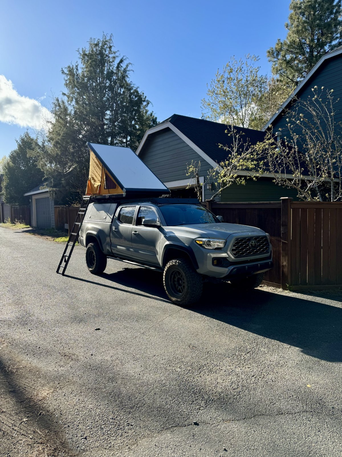

    4/27/2024

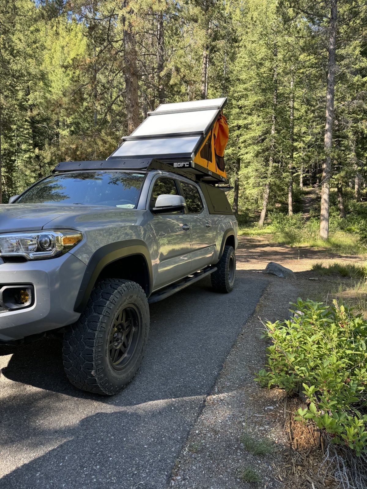

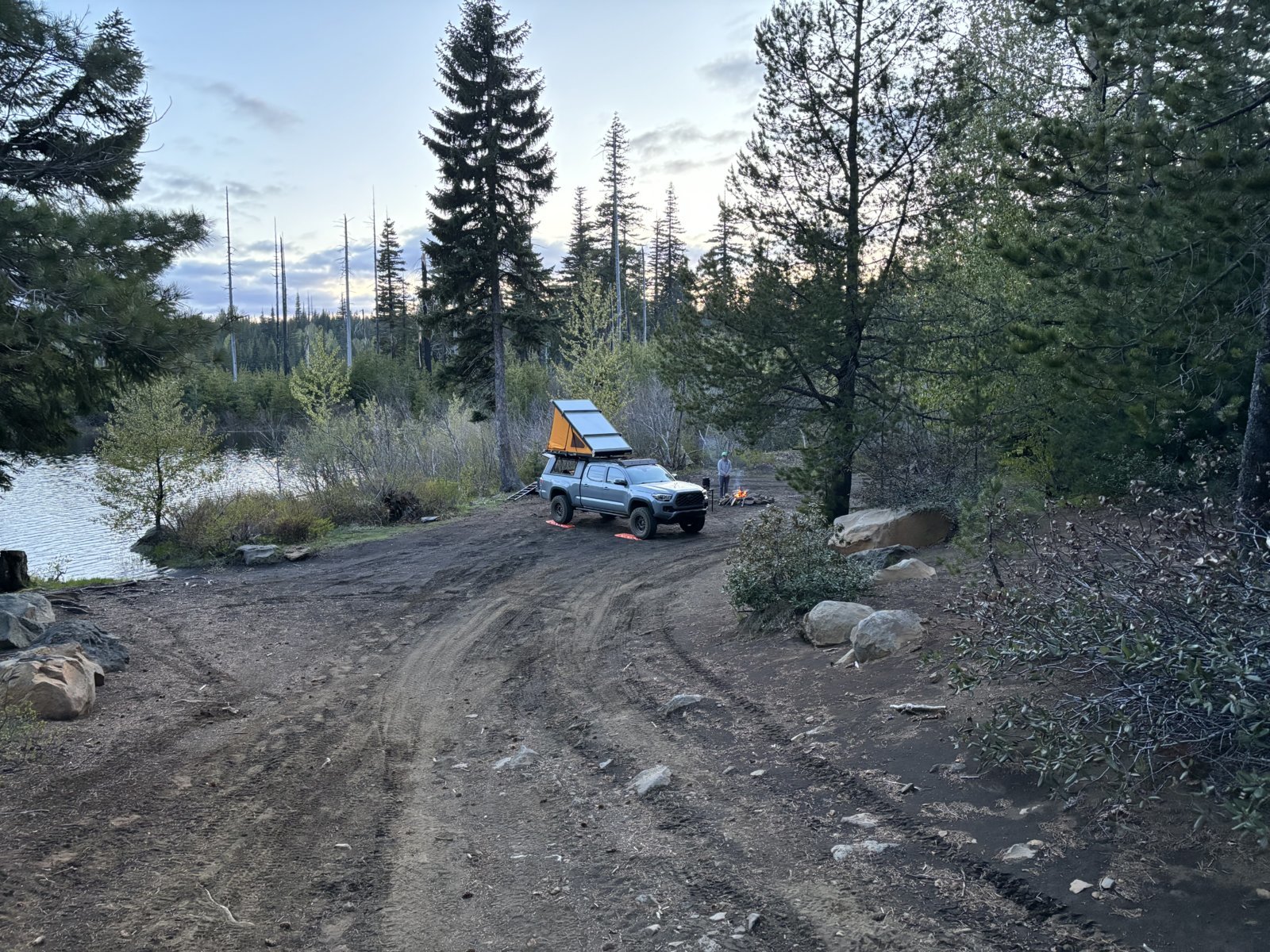

    I've had my eye on a wedge tent for about a year now. Between space utilization, square footage, and storage they seem to be a better tent option. Truth be told I was never super impressed with the ikamper build quality and what I got at that price point. Sure the mattress was better that sleeping on the ground but I wasn’t great. It took a while to open up and I couldn’t keep bedding up there. I did a bunch of research on wedges-looked at ikamper BDV, CVTs, FSRs, and even some cheaper no name brands like inspired. I ultimately settled on a GFC based on build quality. The fact that they’re made in Bozeman is another huge selling point for me.
    Now to find one. I decided to stick with an RTT and not do a full camper mainly to keep things simple. I really like the Smartcap and I didn’t want to take a bath on the whole setup. There are plenty of used campers out there but obviously that was not the route I planned to go. I wanted just the RTT. GFC makes significantly less RTTs than campers, I also wanted a tangerine color. Less popular. These things don’t pop up on FBMP often at all. I’d be lucky to find one local to me in bend, Oregon. I’m not rich enough to swing a new RTT with all the mounts, accessories, sheets, ladder, etc. it was over 5k so I was certainly in the used category. Plus I hadn’t sold my ikamper yet… sore subject in my household atm.

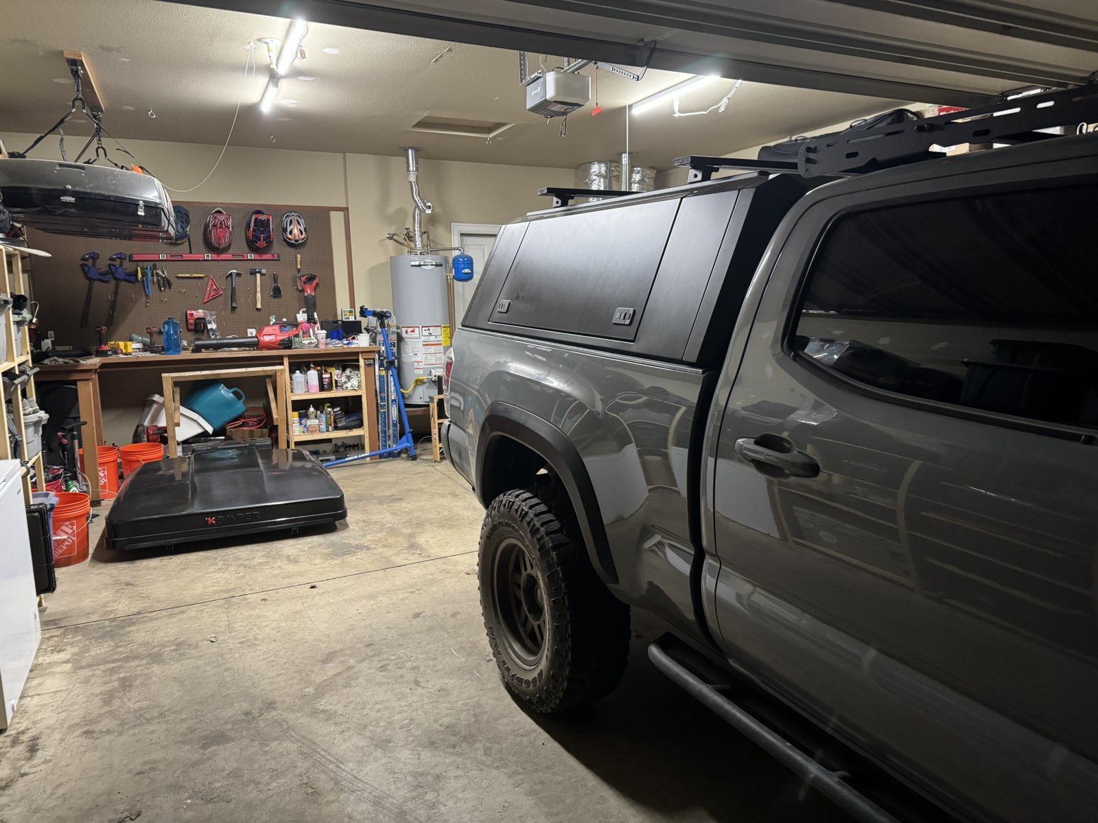

    In late march I found a used tangerine RTT for sale on the GFC forum and I hit the guy up. It was located in the Bay Area, about 8 hours from me. I got the 411 on the tent and decided that I wanted to give it some more time to hopefully sell my ikamper first before scooping his RTT up. Weeks went by and I was over waiting and wanted to get on with it. He agreed to meet me at a hardware store in Weed, California on Saturday 4/27 which was super nice of him to split the driving with me.
    I unloaded the ikamper and put it in the garage on Wednesday night and we rolled out at 7am the next Saturday morning and pulled in that hardware store around 10.30. He was a super nice guy and he set up in their lumber/CMU block area to unload his GFC which was quick then I swapped the rails over and picked up some hardware from that hardware store to secure the rails and mount the RTT to the rails. Very smart to meet at a hardware store. Definitely a life saver to have a hardware store so close. It took about an hour and a half to swap the tent over then we turned and burned, grabbed fuel @5.60/gal, and headed home. It was a pretty easy, seamless process.

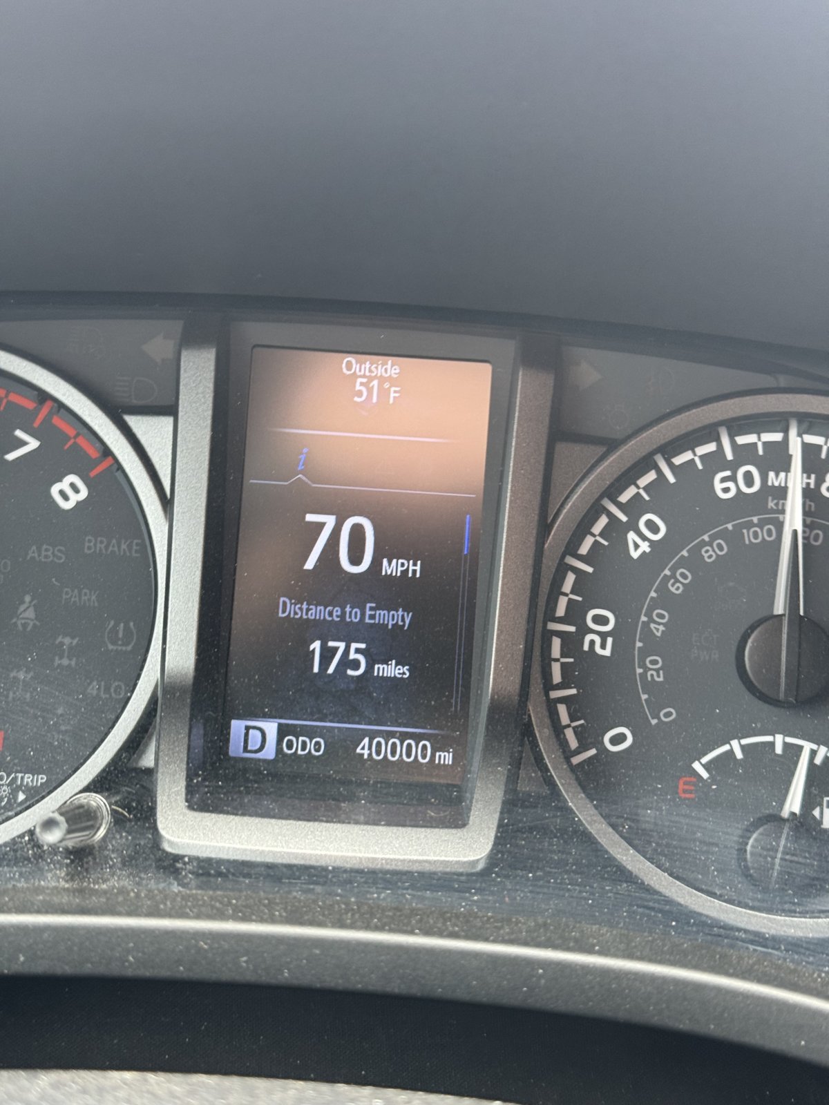

    On the way home the truck rolled 40k miles. Big day and I’m pretty stoked on the GFC the build quality is apparent. Somebody come buy my ikamper!

    Nice Thad! Is that the GFC Superlite?
    I ask because I was looking at the Alu-Cab LT-50 rtt versus the GFC rtt for my build. I also have a 2021 DCLB OR in Cement so, I have been watching this thread for a while :D Keep up the build! It's coming along nicely!:thumbsup:
    Here's a pic of mine, I've been taking it out all over California and feel that a rtt would make things easier
    bryan83taco, skidooman and 4xThad[OP] like this.

    Yo! It is not a super light. It’s a standard GFC RTT. It doesn’t have a lot of bells and whistles, but the build quality is top notch. I’m stoked for $3200!
    Dude! Cement long box’s are such a vibe!

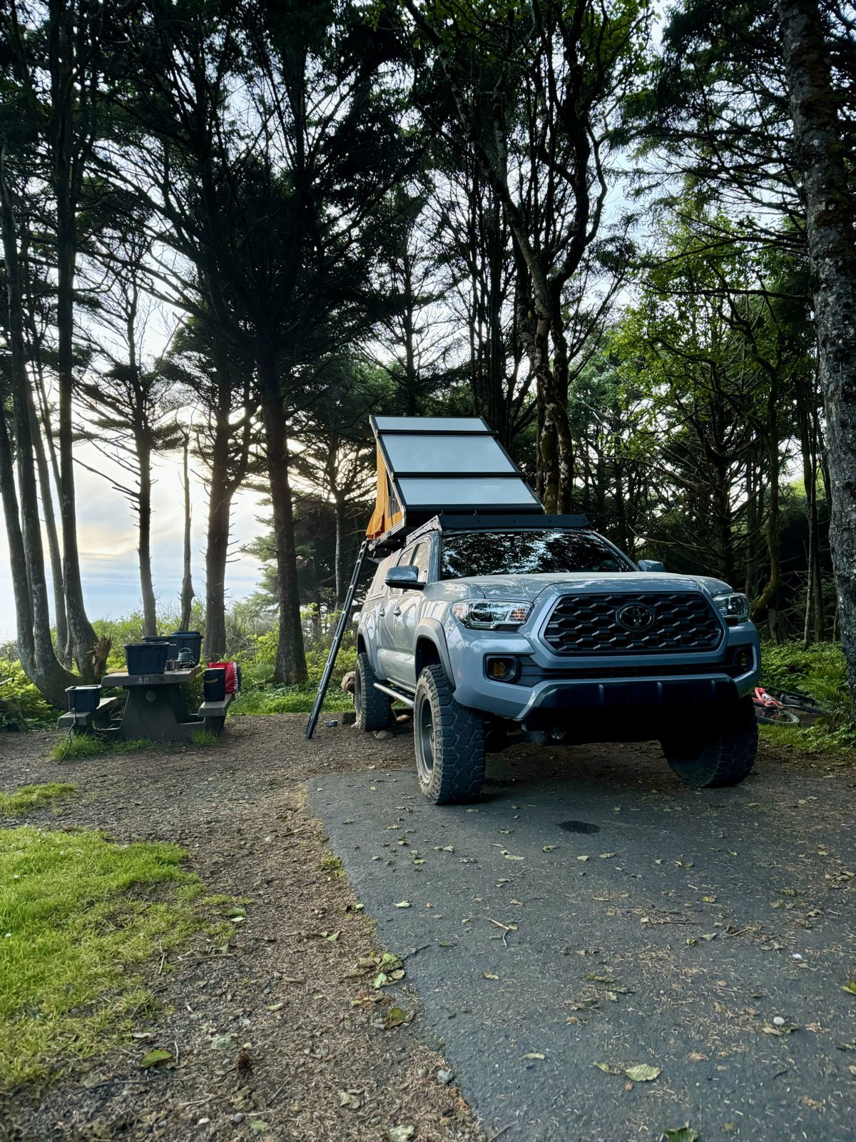

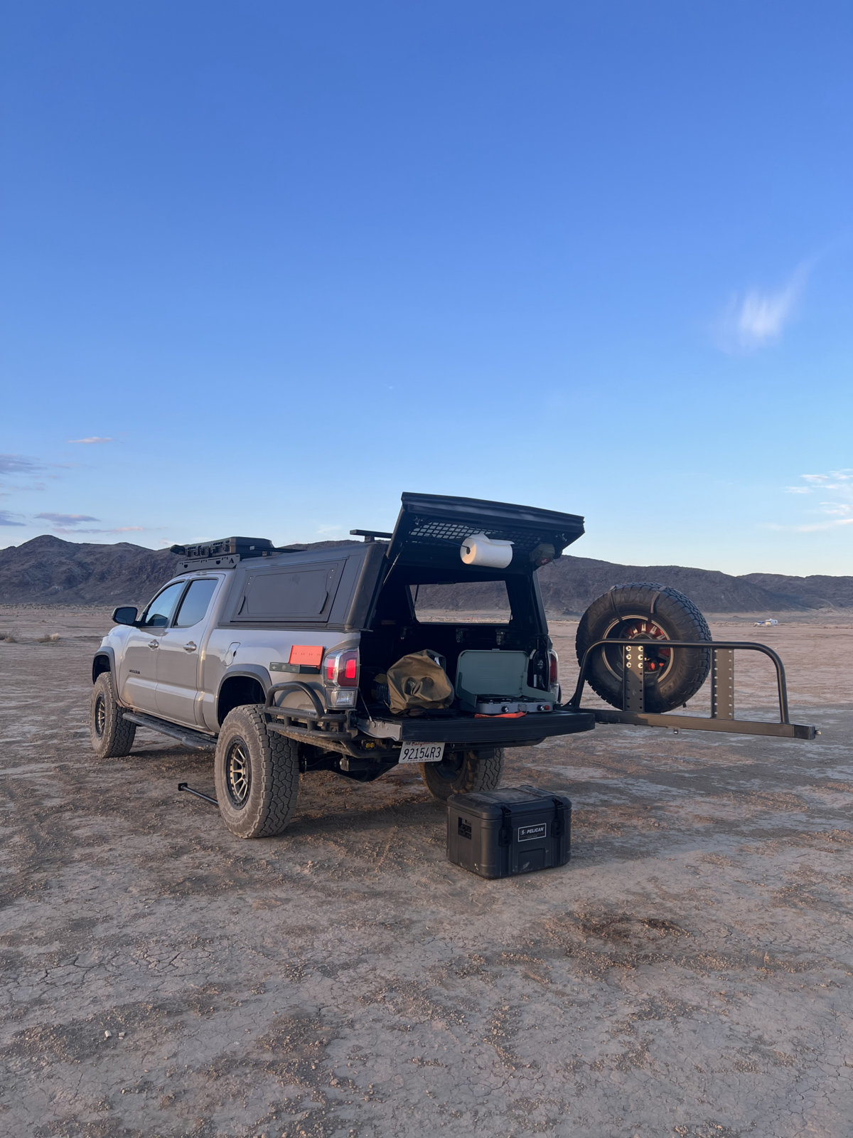

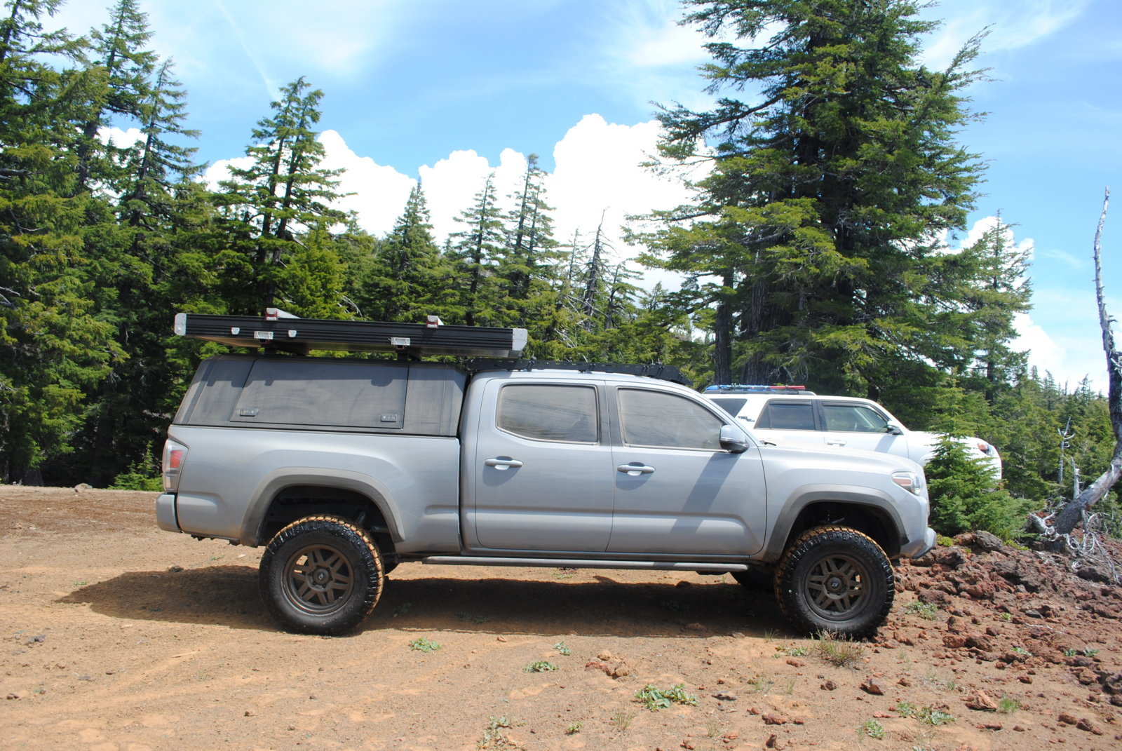

    I sold the other tent like 10 days after I picked up the GFC so I was out of the dog house pretty quickly. Some guy with an R1 came down from PDX and handed me some cash. He said he was planning to take it to Alaska this summer so that was pretty rad. And I got my garage spot back, the dirty looks and the “we have 10k in tents” comments stopped which was quite refreshing.
    We headed up to Washington for a few days in late June. Camped on the Washington coast which was neat, but kinda cold and cloudy. Honestly should have just gone to rainier instead. It was like 90 in Seattle at the time but 55 on the coast.

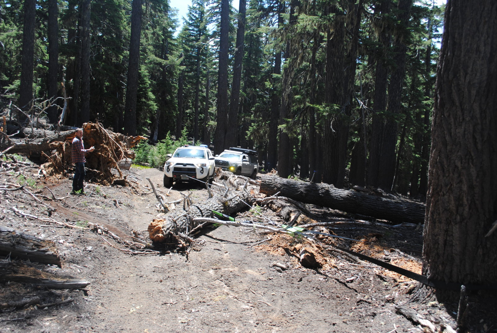

    Sadie had some friends in town the following weekend so I had an opportunity to head out and go wheeling with some buddies. We hit the local trails on the SW side of Mt Bachelor and we made it pretty high up, had to cross some snow fields and do some tree winching but we made it all the way to the cabin lookout. I ran over a boulder that smashed my factory (useless) skids pretty good and I hit a tree stump which I’m not happy about, up it was a fun day. The truck dropped an oil cap and threw a CEL on the way down the mountain which kinda scared me. The dealer changed the oil last and subsequently the following day too (for free) and said that they see a lot of 3g’s dropping caps. Seems like total bs to me. But the oil levels looked good and everything seemed fine so it didn’t end up being a big deal.

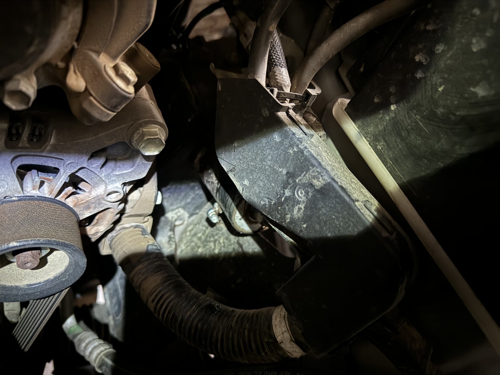

    it also needed an alignment pretty badly after this run. It felt like I either bent something in the front end when I hit a downed tree or I shifted the rack over. Thankfully it was the ladder. So week and a half later it went back on a rack to get straightened out.
    But also 2 days after that run we hopped in it and drove to Idaho for the 4th. Pretty awesome to beat the piss out of it, then drive it 1000 miles round trip a few days later. We got to camp a night with a buddy I hadn’t seen in a while was a great time.

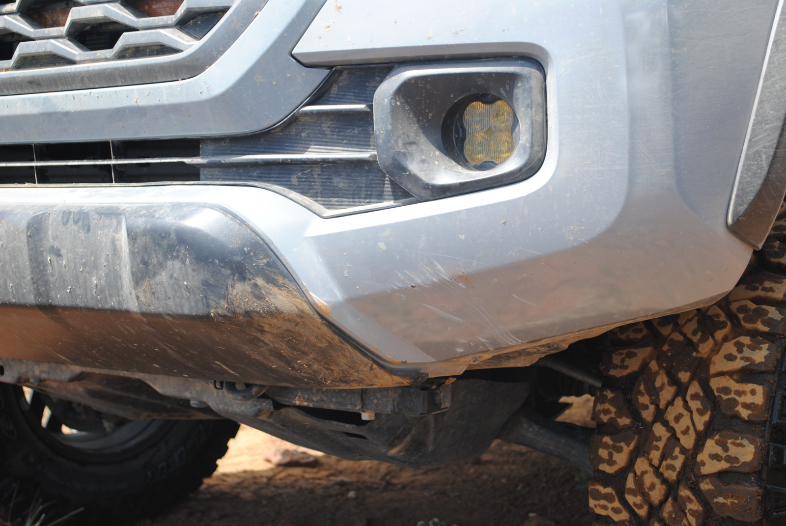

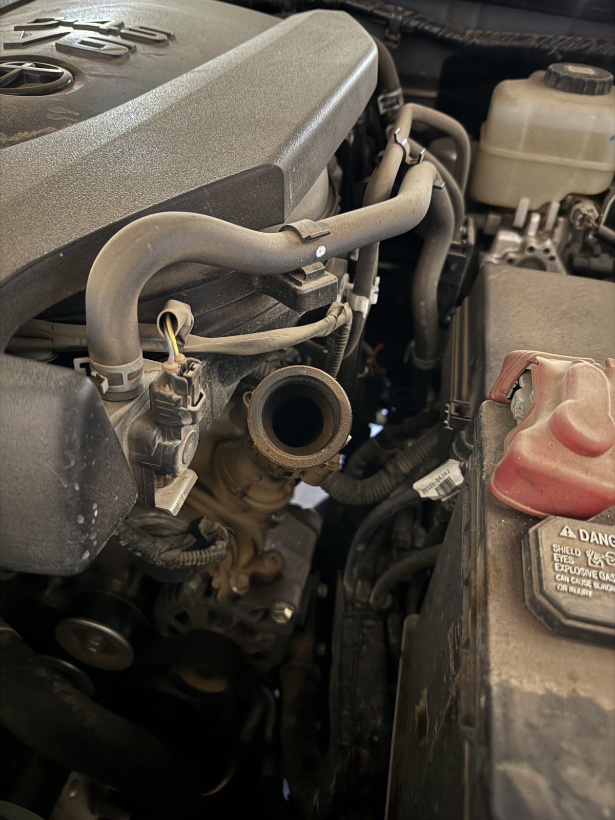

    So I’m on the hunt for some cheap, light weight skids cause my factory ones don’t really fit, they rattle, and don’t protect the truck. Thinking either RCI or a TRD PRO plate for now!

    Damn, the same thing happened to my 3rd gen with the oil cap! I did a post-trip inspection after a 2.5K mile trip in April and boom, the oil cap was missing :confused:
    No CEL's tho. Dipstick read fine.
    I changed the oil and filter asap and there hasn't been any issue.
    I can vouch for the RCI front skid in Aluminum! Fitment is good and they commonly have good promo sales

    At least your truck didn't throw a code! My truck threw a lean code on the passenger side bank and that's when I noticed the cap was missing. Oil levels looked fine and the filter looked pretty clean. Everything has been fine since I changed the oil so I'm not too worried about it!
    I've heard good things about RCI aluminum. Thanks for the tips
