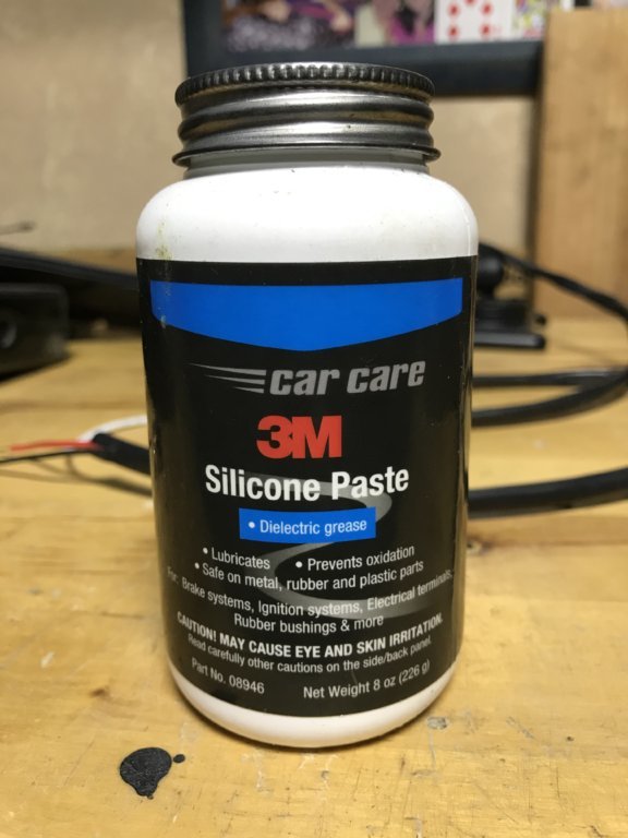

    Clean all door seals and weatherstripping.

  15. Nov 27, 2020 at 7:10 PM
    #35
    EDDO
    EDDO                         
    Mar 12, 2014
    #125165
    4,017
    Eric
    San Jose, CA
    19 TUNDRA
    ^This. That helps a lot. Then a generous application of this stuff on the door seals makes it go away completely. Not sure whether that is what OP has going, but it can’t hurt.
    BMH and Dirtridercrf250[QUOTED] like this.
