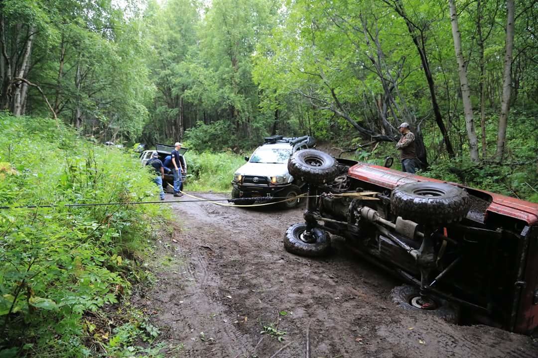

    Title to catch eyes, but hear me out: putting an >8,000 lb. winch on a Toyota Tacoma is a massive waste of money for the vast majority of Tacoma drivers.
    Chances are you paid more than $500 for a big winch, paid another $1000 for the bumper to hold it, and now the weight pulls the front of your truck down, makes it handle like a soggy sloppy joe sandwich, saps its already meager fuel economy, and you could have spent the money on something else you wanted. The net loss for your daily driver now exceeds the occasional utility the winch provides.
    Alternatively, take half an hour learn how to set up some mechanical advantage systems. We like to talk about "know how to use your hi-lift jack before you need it on the trail." Knowing how to set up mechanical advantage systems are arguably just as useful, and maybe more.
    And we already use snatch blocks: sometimes we use them as a simple change-of-direction pulley; sometimes we use them as a 2:1 mechanical advantage. Why stop at 2:1?
    Setting up a 4:1 system with a 3,000 lb. ATV winch yields 12,000 lbs. of pull, which exceeds the working load of most synthetic line. ATV winches are far lighter than truck winches; you can stow them in your tool box and use them front or back as you please, and you can probably buy one that will do the job for $100. Spend another $100 on some pulleys and other gear set up your 4:1 system, and you now have the a 12,000 lb. pull for $200. And setting up a good MA system on the trail gets style points.
    There are some disadvantages: The truck doesn’t project the same tough image without a winch and steel bumper out front. Setting up for a pull can take a little longer. The pulls themselves will take longer. You'll have to learn something well enough that you can repeat it under stress. And you may want to learn how to brake and reset your mechanical advantage system mid-pull, because you won't get as much pull distance from your line.
    But then you no longer have to drive your chonky winch to work. You don't have to buy new coil springs or dial up your preload to compensate for the winch and bumper that just killed your lift height. Your truck won't feel like a reflection in a funhouse mirror when you shoot the curves on the backroads. And you can pull from the front, back, or even the sides with all those pulleys you now have.
    This is just my opinion though. If anyone is already using MA systems higher than 2:1's for vehicle recovery, share your thoughts.
