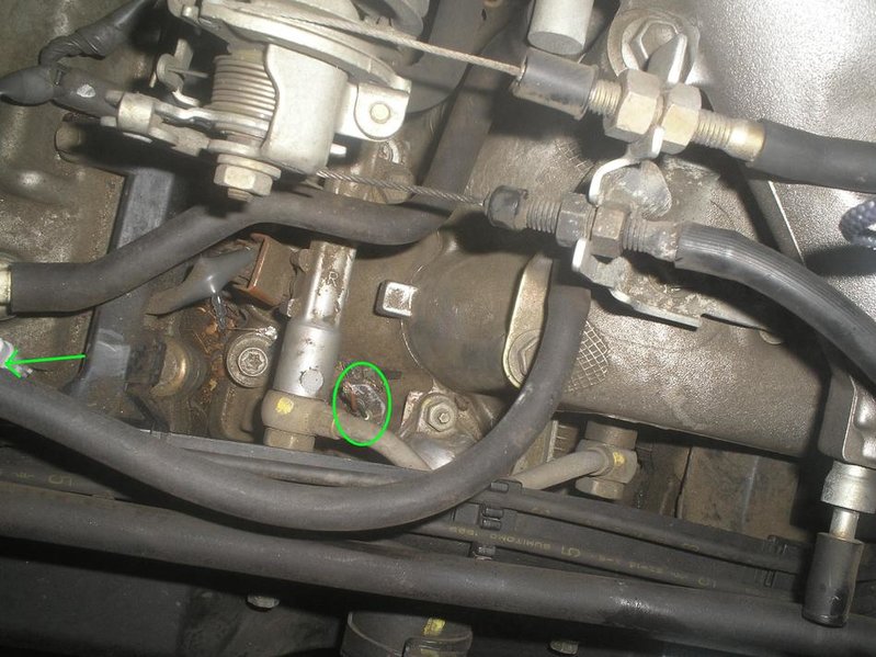

    Another update:
    Mouse alive and kicking and pissing me off, because now it chewed through a wire and truck won't start.
    I've attached a picture of the plug that goes into the engine block (circled in green) and the other end that was connected to what was left of the wire (green arrow), which I was able to remove. The one in the middle is about 3/4in in diameter, right behind the radiator hose mount, on the engine side of the belt housing.
    My first question does what is this wire control? I am guessing something to do with fuel injectors.
    Second, how do you get disconnect? It's really hard to access, or even see, but it feels like there's a clip on it, but I can't get it.
